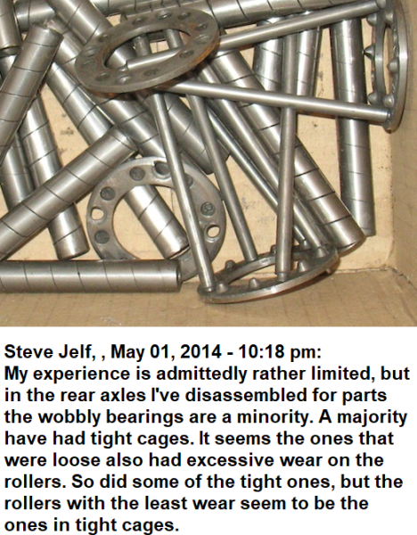

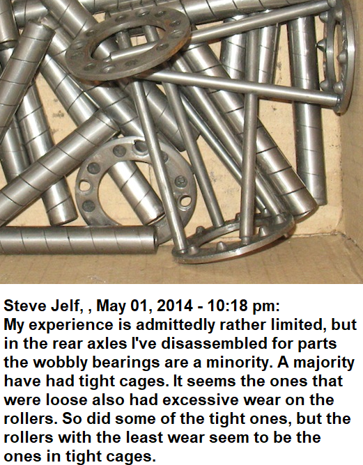

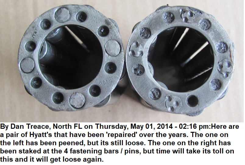

To start - here are the parts (courtesy of Steve). The end caps have cones in they to retain the rollers. Looks like rods can be made. Some say that just welding the rod ends (rollers in spec) & grinding the weld will work.
How to determine or make a Hyatt servicable

I find that loose caged rollers wear cigar shaped because the roller cocks out of its intended parallel position to the axle.

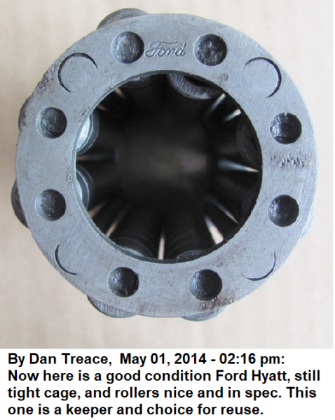

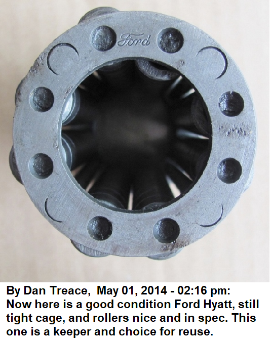

Not a fan of prick punching to tighten. I have had much success tightening by re-peening most loose cages.
Those cages that dont take peening well, but have minimal roller wear, I have re-secured the cage pins by wire welding & of course grinding ends flat.
Usually the really loose caged bearings have more wear than I will accept.

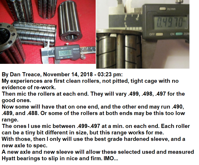

I will save un-pitted & non flaking rollers if wear is .005" or less. Thats .010" possible slop. I will use with an over-sized sleeve.
New sleeves vary quite a bit in thickness between past & present sources. I select the amount of bearing wear so the bearing will push in by hand pressure, not by hammer.

Just to confirm, a new roller spec is .500? Is that for both the axle & pinion rollers?speedytinc wrote: ↑Wed Mar 06, 2024 2:20 pmPretty much asked & answered.

.500" for axle bearings. .562" for driveshaft.TRDxB2 wrote: ↑Wed Mar 06, 2024 2:48 pmJust to confirm, a new roller spec is .500? Is that for both the axle & pinion rollers?speedytinc wrote: ↑Wed Mar 06, 2024 2:20 pmPretty much asked & answered.

There has been some discussion on minor variation allowance. (Ford mfg specs)
I do have a few NOS that do measure .500 & .562 respectively.
I have a few used axle bearings that still measure .500".
