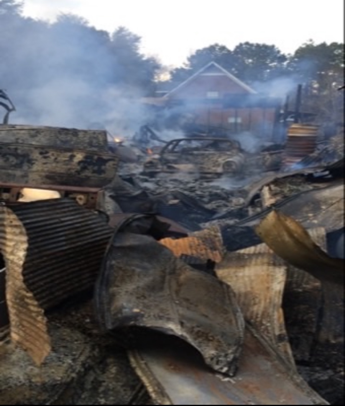

I once bought a T that burned down a house, new Caddy and a Motorhome.
FIX IT ASAP.

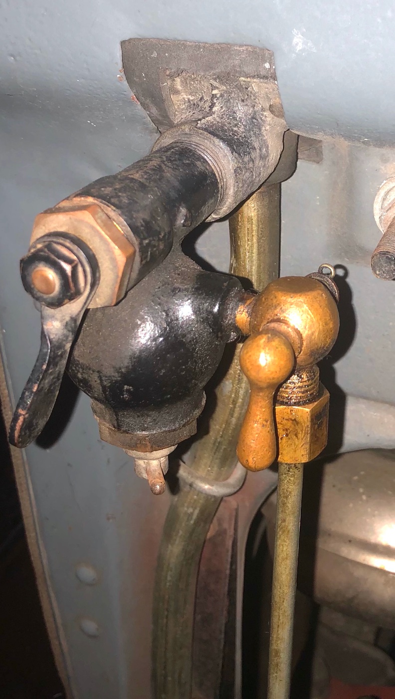

You could fix that firewall style sediment bulb. Takes some work and new lead gasket to keep from weeps. Remember, gravity is pulling on that fuel always. So a good shut off is needed.
Or on this one, couldn't seem to get the bulb shut off to close best. So added this extra shut-off, works like a charm every time. I always close the shut offs when parking my Ts in the garage. As Dan Hatch posted, saves grief!

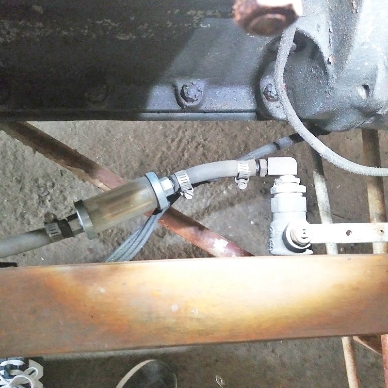

I have this, from tank to carb so I can quickly reach under the frame and pull it towards me shut without having to open the hood in a situation of extreme urgency.

Not a new problem. They got there too late
