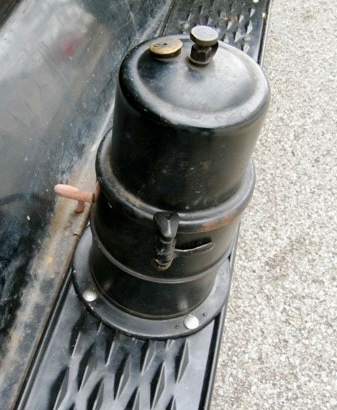

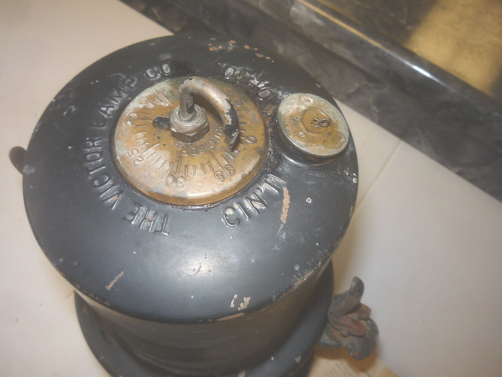

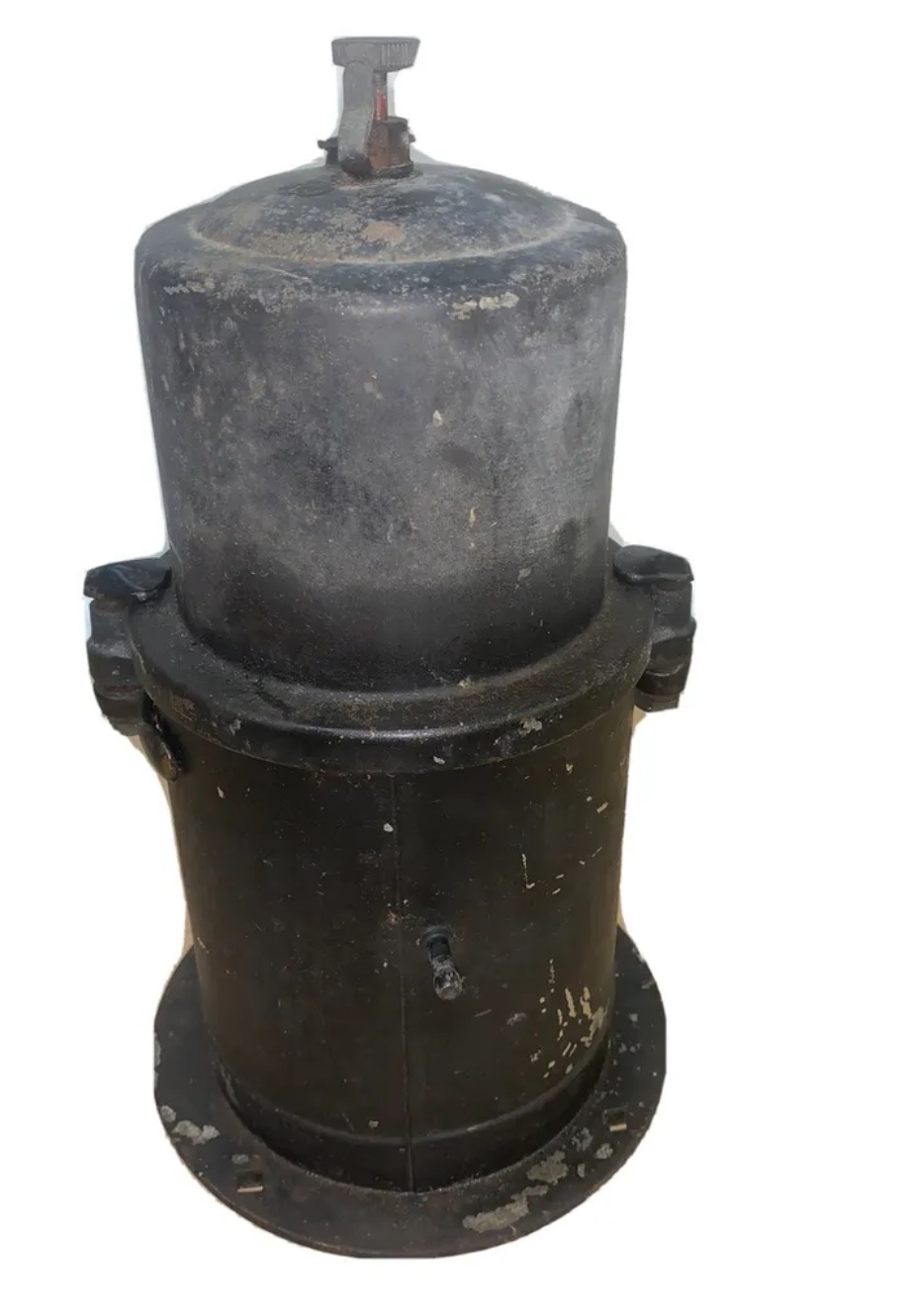

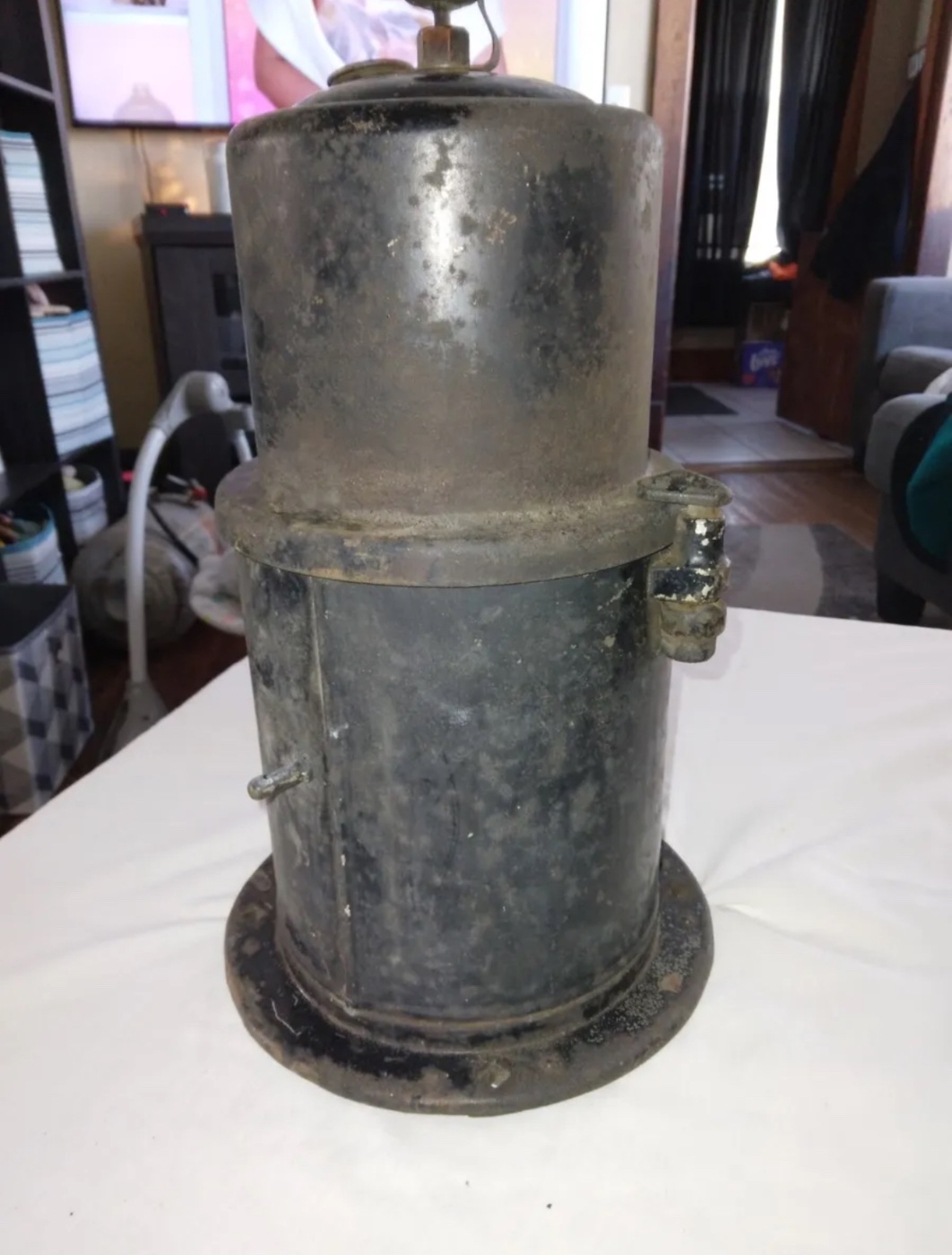

They are unique compared to the Brown & Corcoran. Attached you will find 4 pictures Brown, E&J, Corcoran & Victor. There are 4 variations of the Victor black & Brass, the one pictured here is the second variation.

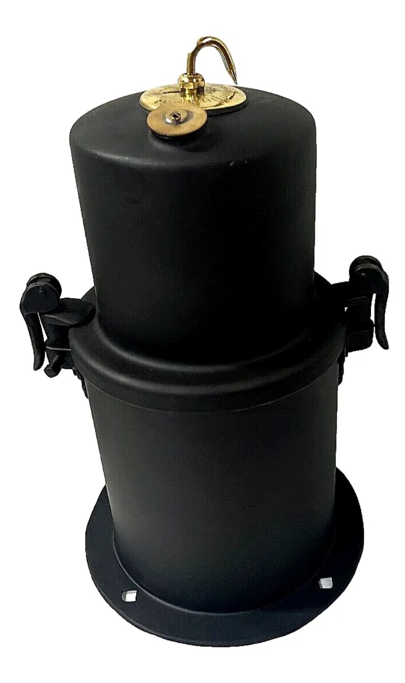

Victor generator with the embossed water tank.
The "hook" water control and side clamp style sets them
apart from the others.
