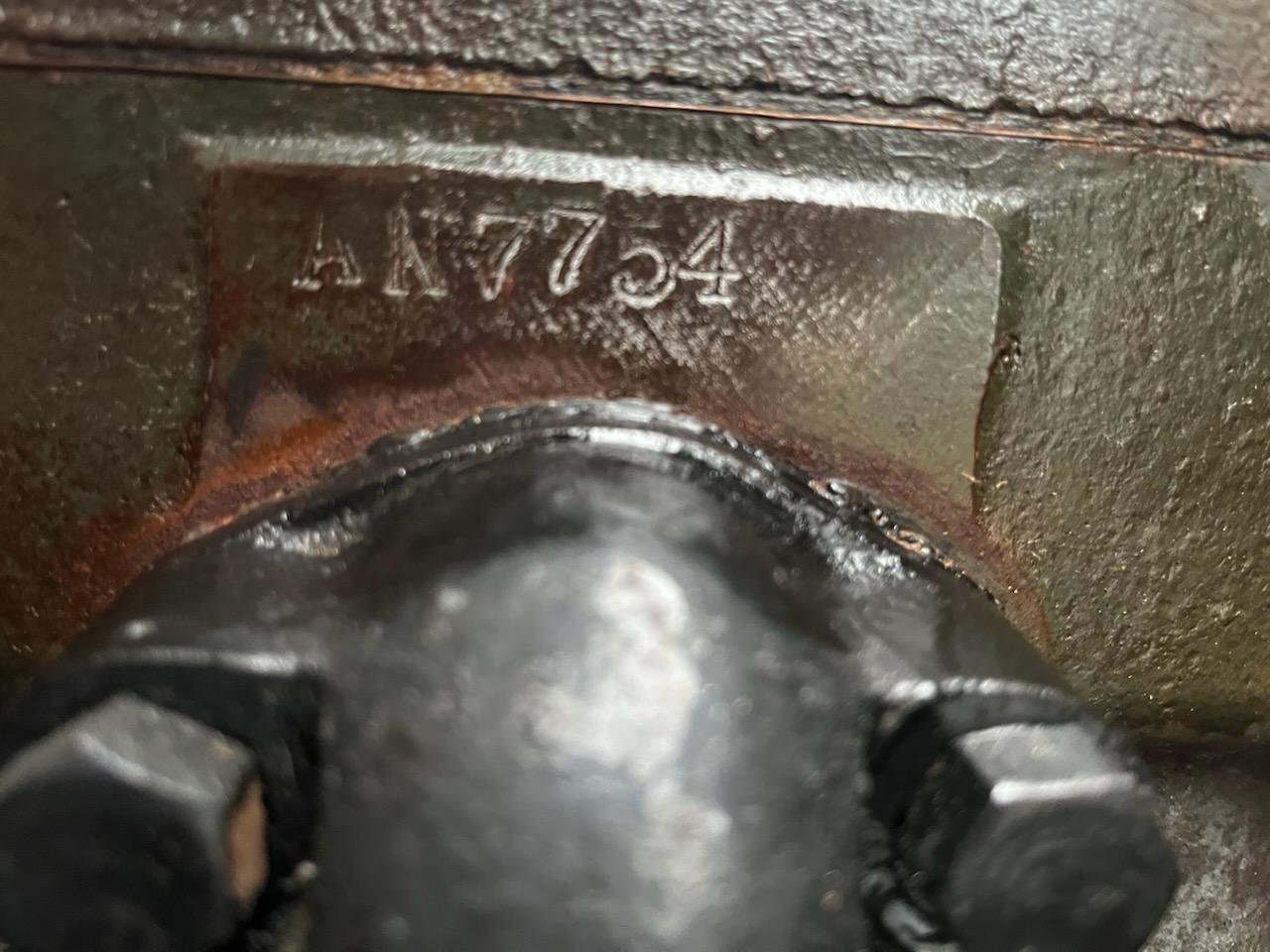

Engine block has been stamped.... AN7754. I'm thinking it is a replacement block made after 1927 to 1941 era. It is hooked up with a 26-27 hogshead but the block does not have the extra flange area for the top of the hog's head to bolt. Would anyone have any idea where this block was manufactured?.... Or even was it a block made by a company not even associated with Ford motor company?

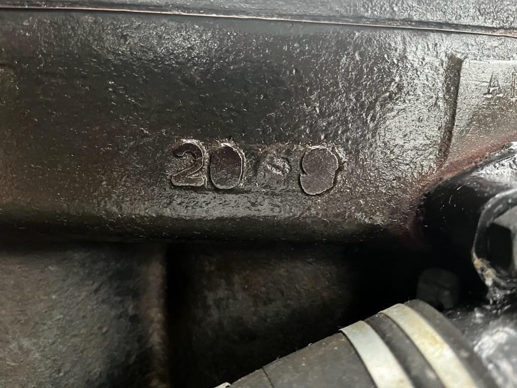

Block casting alongside block number...... Engine is installed in a 1925 touring car.

The numbers ahead of the water inlet are likely mold and pattern numbers, used by the factory quality control to track defective castings back and replace or repair the offending molds.
The serial number is unusual, but actually not all that rare. Rarely found in the books, Ford sold many thousands of engines, anything from completed engines down to barely short blocks (no transmission, no flywheel, no head, no pan) to many companies for all sorts of uses. They were used in boats, farm machinery (reapers and hay bailers by the hundreds!), railroad service cars or switch motors, and all sorts of stationary power plants. I usually refer to such engines as "backdoor" engines as I have never read a better name for them.
They were usually sold without a serial number on them, and the company installing them or modifying them for alternate uses were expected to put their serial number on them! Many such serial numbers were two letters signifying the company producing the whatever, and a short few digits serial number. Many such serial numbers were two letters followed by four numbers. Although I have seen even shorter numbers, and a few with only single letters.

Additionally, I have no idea who "AN" might have been.

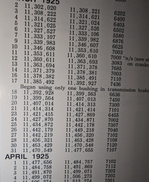

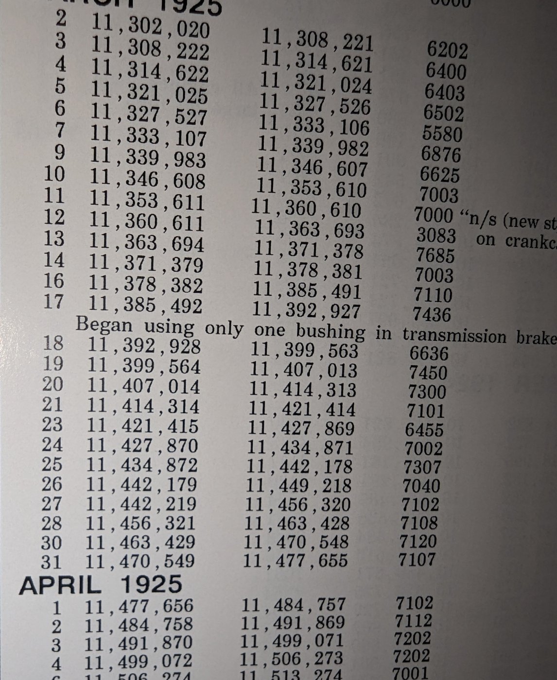

As far as the letter number AN7754 is concerned using the assumption that the letter A represents 1 in numbering the alphabet and the N represents the number 14 since it’s the 14th letter maybe the number would be 1147754.
It’s a March 1925 number IF the letters mean 14. Maybe this doesn’t mean anything but coincidence and it’s just a wild guess. But I don’t think we really know for sure. MHO !

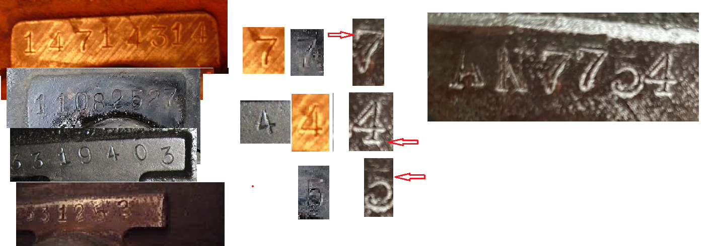

My guess is that it was a replacement engine and stamped at a later date. Looking at the font doesn't it appear to match well.

Going with that assumption, the original engine could have been done on April 1st. 1925, so this combination of letters and numbers duplicated what was replaced?

What if the motor was surplus. Left over from either WWI or WWII military surplus.
The the AN *****, would indicate that it had another purpose.
Joint Army-Navy Nomenclature System (AN System. JAN)
