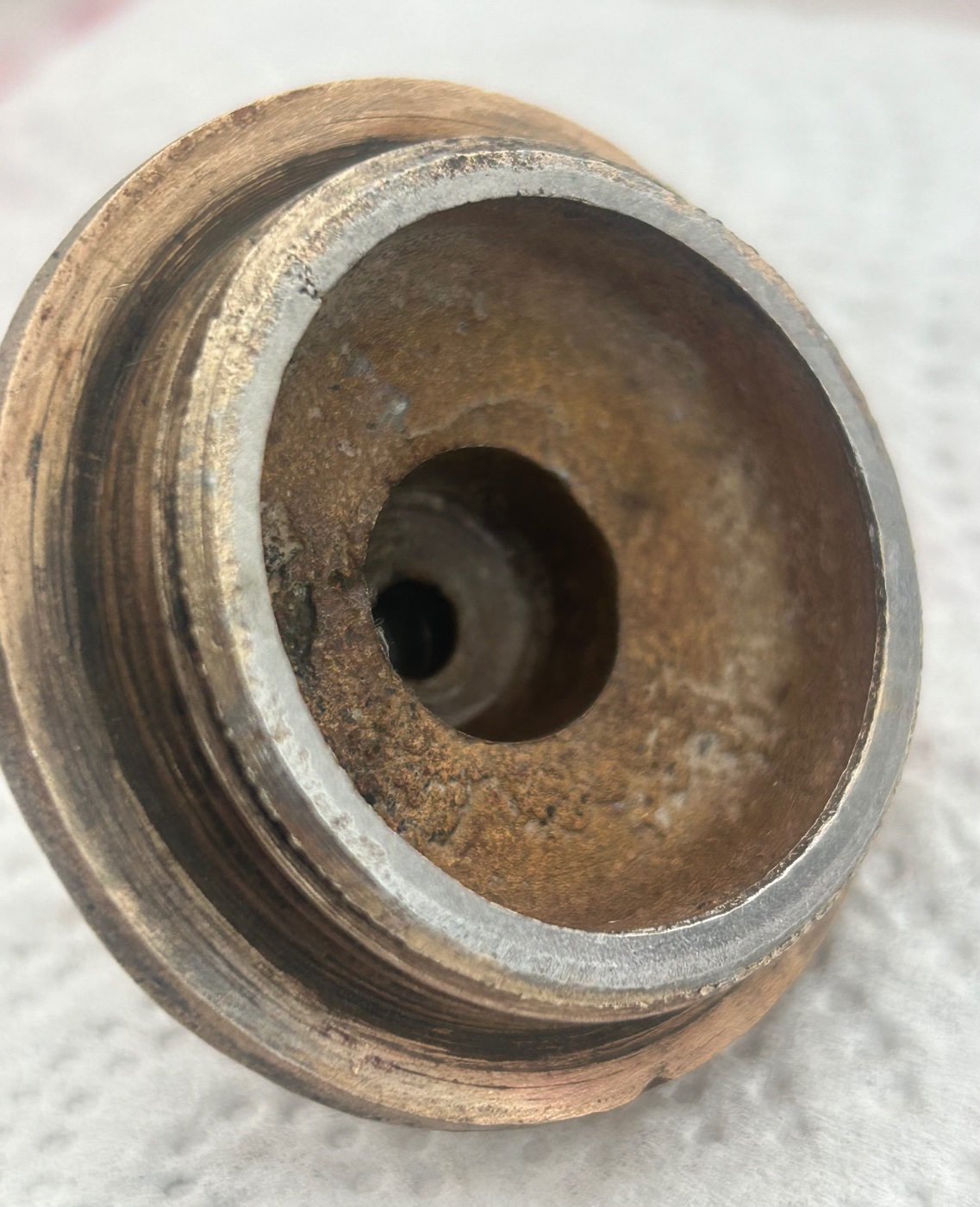

My '13 has been missing the fuel filter for some time. While it's down for the winter I thought it would be good to replace it. The new one is a close fit - any tips on soldering it in place would be welcome !

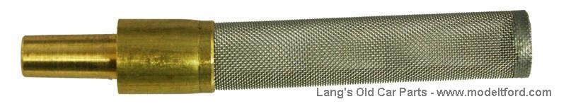

I just install this fuel filter on top of the sediment bowl. Fits perfectly. The only problem is that your tank is empty when you are down to a gallon since this raises the bottom level of your fuel tank. Sold by Langs.

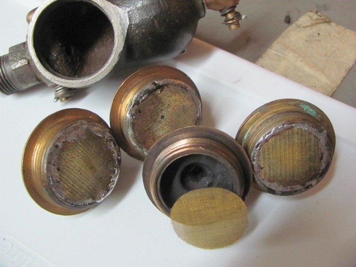

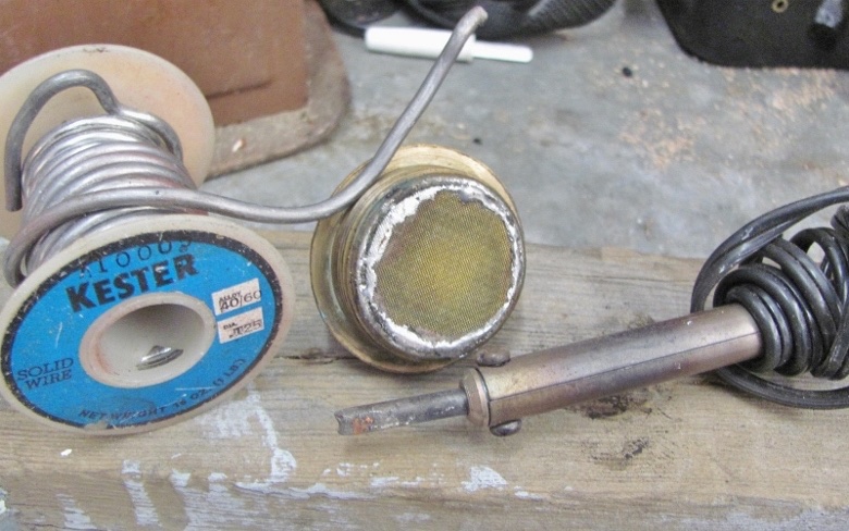

A very good soldering iron will give good results. I used just simple low watt pistol shape gun and got that screen on.
Lay first some solder to tin the recessed rim groove, and that will allow the round screen to be placed into the groove and touch the iron in places around the rim to hold it in. Follow with more solder to complete.... my job is amateur, but sealed the screen ok to prevent stuff from going to the fuel line.
Doing a few more got a bit better practice, rather fun to do.

fair question - the new screen barely spans the rim of the piece that screws into the "spud". It could almost be a press fit Further, at least on this item, there is no evidence anything was ever soldered to the flange - so, is the screen meant to be pressed in, or perhaps a screen is/was not a universal feature of all sediment units ?

All sediment bulbs have screen disc, the screen lays inside the rim and was held with a very neat small outline of solder, must have been some nice equipment at the time. Only the recess had the solder, the solder did not go over the rim. And don't forget the lead washer to seal the screen nut back onto the bulb.
Example of original with screen, and one with the factory screen removed for replacing.

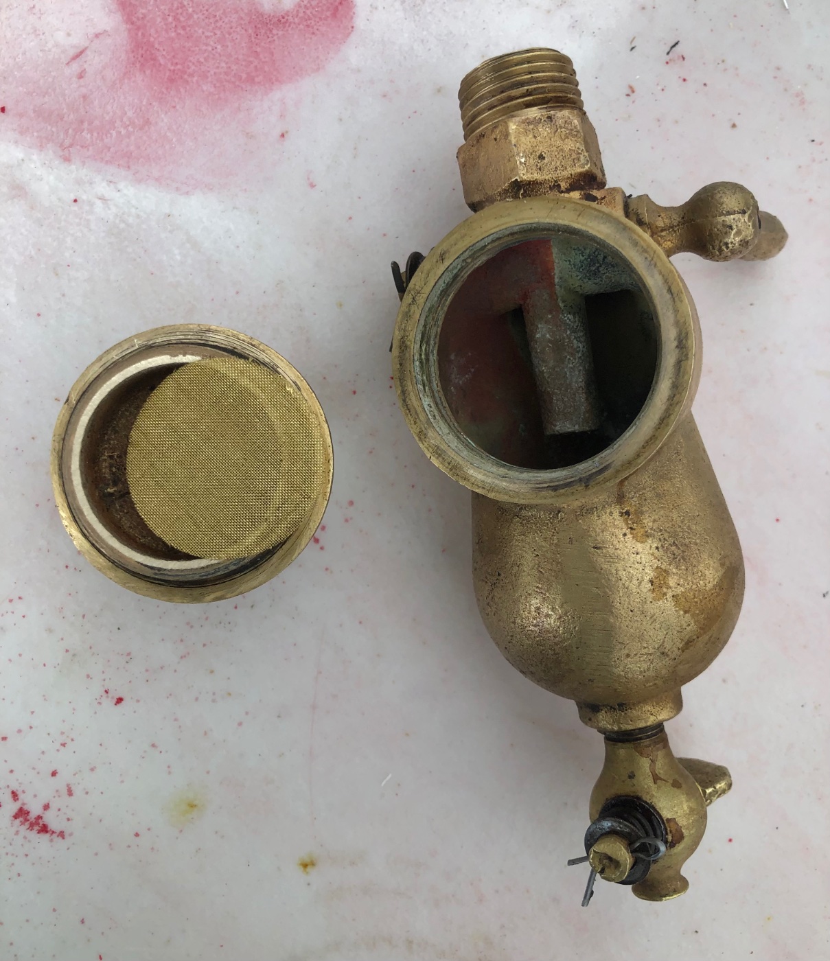

The original screens WERE NOT SOLDERED IN.
They were placed into a machined flange and it was pressed shut to hold the screen. Take a close look at Rich’s picture. You can see it.

I have a screen in my sediment bowl but I also added the finger screen like Dave H. Reason, if any big flakes are dislodged in my tank I don't want them drifting over the outlet and blocking it.

Adam, thanks for that ! From other pics shown, I suspected the screens were crimped into a rebate. Often, earlier items are quite different from the majority of production in the '20s. Unless the crimp has been filed off (not impossible) the edge of the part where the screen should go is dead flat, and shows no evidence of any forming that would have crimped a screen disc. The screen replacement is far too small to adequately span the opening and be retained either by a crimp or by soldering.
Perhaps the long tube in the "spud" was considered adequate protection against "crud" in the earlier models ?

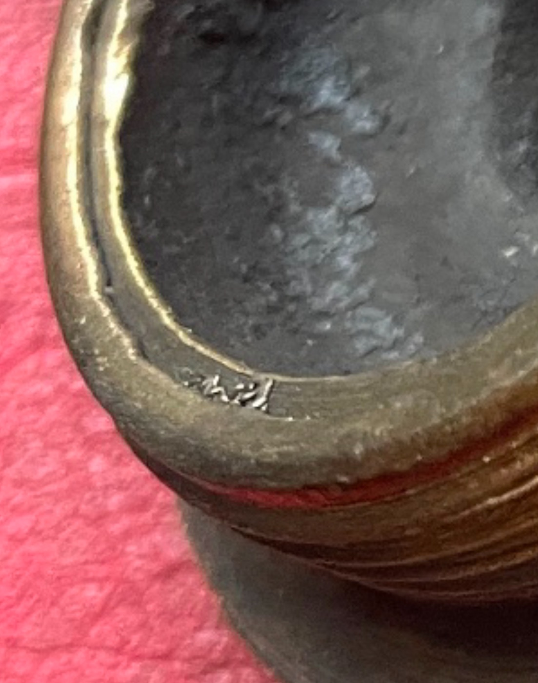

Here's a better view of the part. The opening measures 1.210", the screen disc measures 1.240". Thread depth is .285" into the "spud". Not possible to crimp nor solder this screen into this piece. I doubt if it ever had one.

Try prying up from the lit in the edge of the rim, all the way around. The screen fits under that gray material (lead?)Rich P. Bingham wrote: ↑Sat Mar 09, 2024 1:10 pmHere's a better view of the part. The opening measures 1.210", the screen disc measures 1.240". Thread depth is .285" into the "spud". Not possible to crimp nor solder this screen into this piece. I doubt if it ever had one.IMG_0935.jpegIMG_0936.jpeg

Thank you for the suggestion Frank, however, no such luck. The casting is solid, nothing to pry up. I have to confess to jumping the gun and tinning the rim, anticipating I would be soldering a screen onto it.

Just maybe the original screen was spun in to keep it in place, rather than pressed. That would account for no solder on an original part. There's no way the spun lip could be prised up all the way around to allow the same fit again. A neat solder job will do the job nicely. Even an ugly one will not be of real concern for this application.

Allan, a reasonable surmise, but trust me, there is no lip, it’s a solid casting. The threads taper up to the edge of the flat surface, and anyway, I would be surprised if the bronze casting would be malleable enough for the kind of forming your solution implies. ?!? More research is indicated.

- Posts: 7306
Re: Fuel filter
