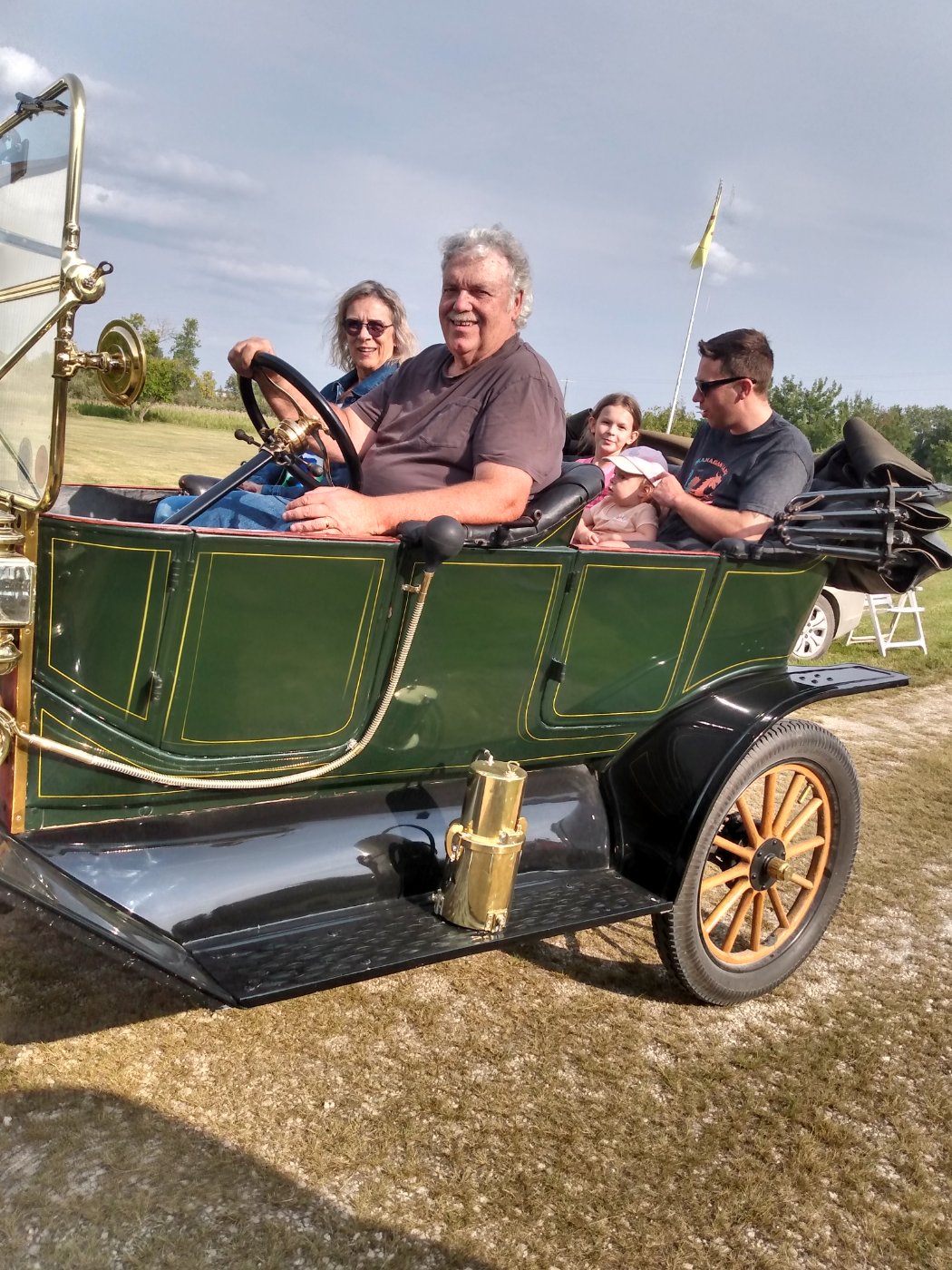

It is my under standing that US cars in 1912 the horn tube ran inside the car . my 12 being a Canadian car with a left front door that opens it has a clip , I have only seen this clip on Canadian built cars. AS for lenght Dad renewed this in 1960 and based the lenght on pictures of other cars

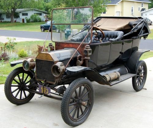

Post by Colin Mavins » Wed Mar 13, 2024 6:38 pm
It is hard to see but it is there a small brass clip held by 1 flat head screw bottom right corner of the door.

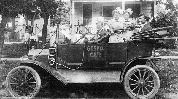

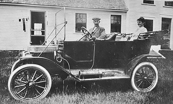

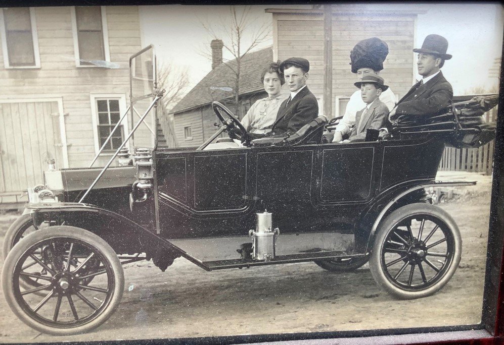

Here are 2 pics of original cars both are a little long in my opinion. I would say these cars are US cars as they have no hinges on the left door . They do not have the Canadian clip

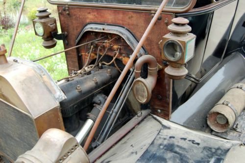

Can't say it's right but this is how it is on my late '12. Can't measure the length as I'm not near the car now.

Post by 49willard » Thu Mar 14, 2024 6:32 am
Colin, Michael, Russ and Bubba thank you for your responses! Colin, the picture of your car just looks right to me. I agree that the other era pictures look too long. I suspect that without the clip the tubing could lay over the door opening. Michael, thanks for the 39" measurement. That agrees with the 40" in the era ad provided by Bubba. It is interesting Russ however that your tubing is long more like the era photos. I think that I will mock up the horn/tubing with 40 inches before cutting and could consider a clip. I do have twin sidemounts on the (US) drivers side. The other help provided by the pictures is the placement of the horn as to height as mounted on the firewall. Thanks to all!

For what It's worth, my car was restored from a compete original car and that is the way the horn and cable were set up when the car was found. I assume someone secured it along the wood runner at some point to keep it from slapping on the door as I doubt that is correct.

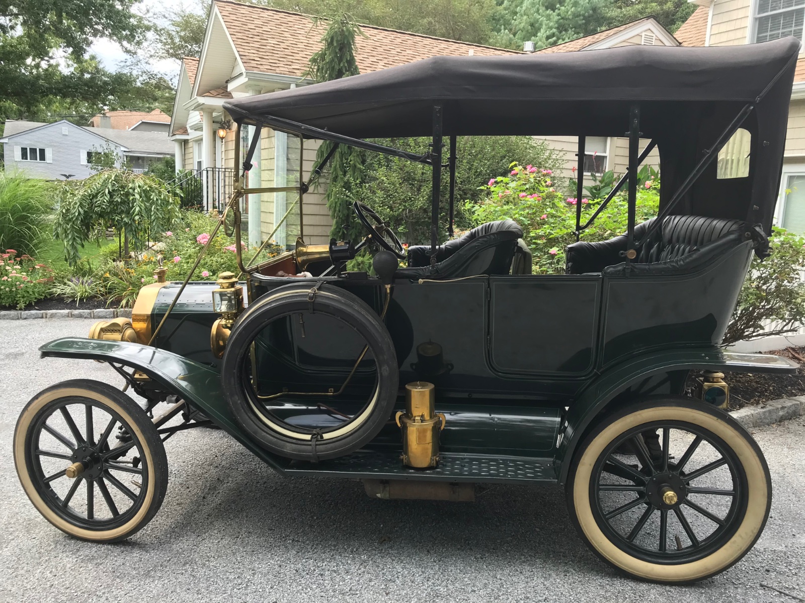

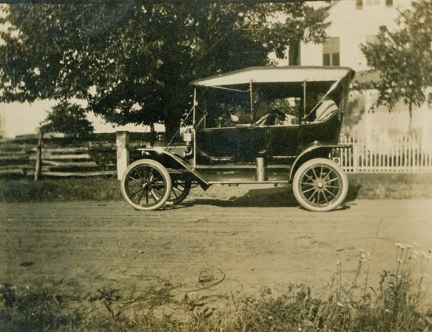

Just to through a monkey wench into the mix here are some US 1912s with the single twist black and brass tube inside the body

I agree that the horns appear to go thru the firewall in the photos but I do not see a squeeze bulb. Is it a case where the squeeze bulb is direct connected to the horn without any flexible hose such that you would reach down and forward to squeeze the bulb?

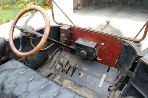

Post by Colin Mavins » Fri Mar 15, 2024 4:17 pm
In two of the pictures the bulb comes up in the centre of the door
Colin Mavins
Posts: 386
First Name: Colin
Last Name: Mavins
Location: Winnipeg Canada
Re: 1912 Length of horn conduit?
Post by Colin Mavins » Fri Mar 15, 2024 4:36 pm

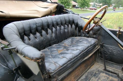

here are some pics of a US t I would say original interior

Post by 49willard » Fri Mar 15, 2024 4:39 pm
Colin, thanks for the original pix, that is helpfull!
I do now see the bulbs however it would seem that door removal is not an option.
