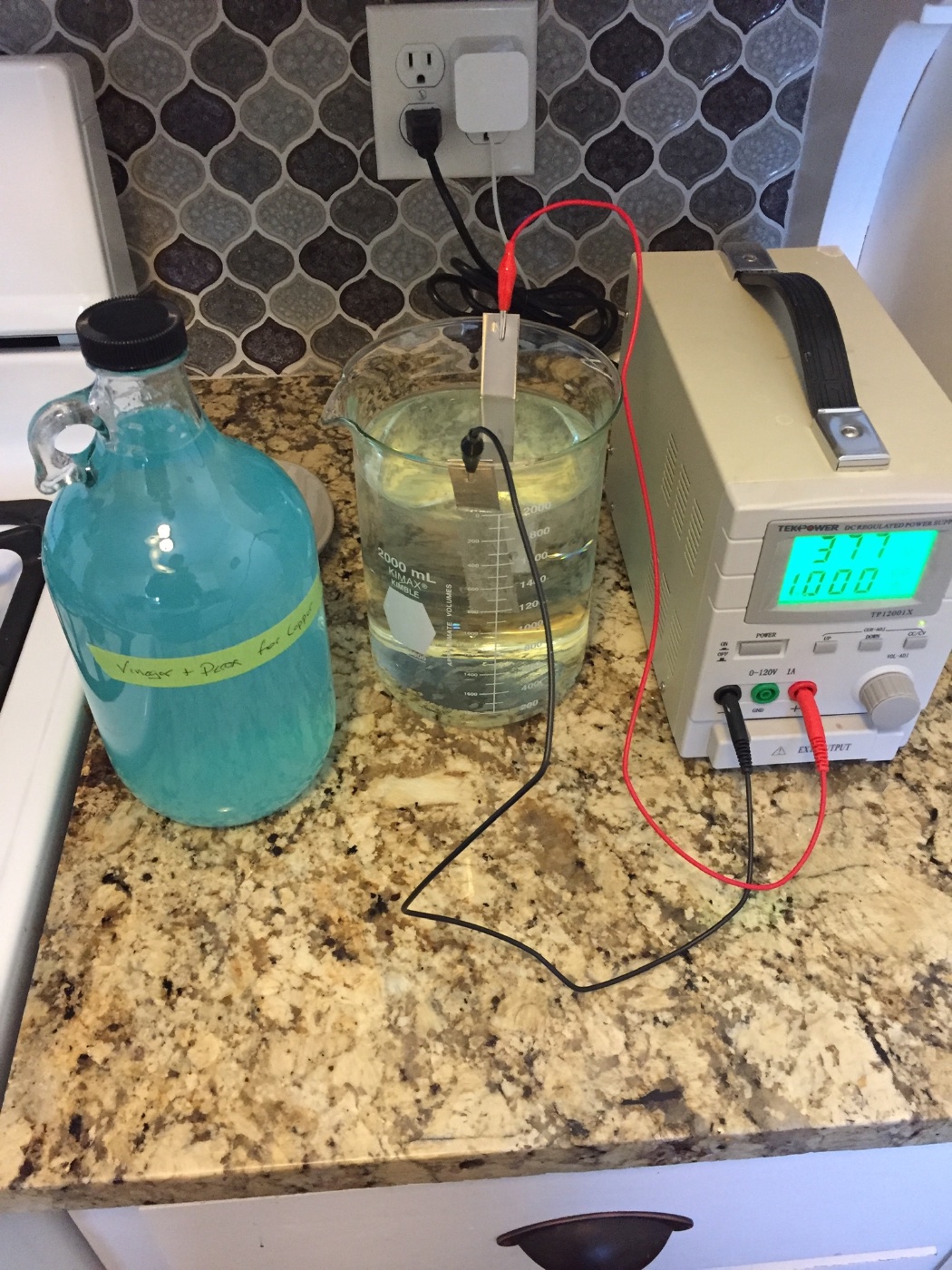

You could also try a less toxic approach by researching nickel plating with vinegar. It worked fine for me with a few small hardware parts, but I ran out of power with my 1A power generator so couldn’t do anything larger

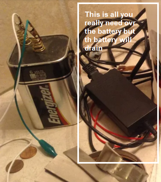

Caswell plating has the easiest to use chemical but not the least expensive power supply. I'd bet that TexPowers is exactly the same as Caswell & Dragons. Buying from Grainger has more power & easy to deal with when necessary.
This video shows "how to" on a budget https://www.ebay.com/itm/372851170400?e ... R9yHgK7IYw
BUT the key is the electrolyte solution & good nickle bars. It doesn't pay to make your own electrolyte solution since it has to be just right.
How much voltage/current do you need?
As little as possible. The lower the voltage and current, the better results you will get. You need a minimum of 0.5V DC to plate with copper. A C or D cell battery will give you pretty decent results. If you don't have access to lower voltages, you can put the electrolyte into a big container and move your electrodes as far away from another as you can - the increase in distance will also increase the resistance of the circuit and decrease the current. More amps only for large pieces
Chttps://www.ebay.com/itm/372851170400?epid=2255 ... R9yHgK7IYw
