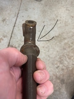

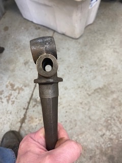

Sorting through parts the other day. This spindle must’ve taken a really hard hit at one time in its life… Other than being twisted, it held up well. I’m sure the vehicle was toed out.

A worn bushing and kingpin can cause that. A T chassis that wound up in its last days used as a trailer would have worn down front end parts and the spindles were the first to show wear and overuse.

I have a similar spindle - NOS - factory defect !

I have seen a defective on here to Steve. Looked like a new one. Confining that much bend to the spindle with no distortion to the spindle arm hole or the axle of the spindle seems a long stretch.

Like Allan, I have seen several photos of the odd defective spindles on here.
It has been said that Ford sold some defective parts that had been rejected from the assembly line. Whether that was a deliberate action, or some employee's bad judgement has never been determined as far as I know. In some cases, it was really a matter of fitting issues that the factory couldn't take the few minutes to make corrections, while a repair shop replacing a broken piece on a car could refit the relatively minor errors without gridlocking the production line.

As for the OP spindle? It looks to me like it has been twisted and bent somehow. And by a lot more force than I used to straighten my nose piece.
