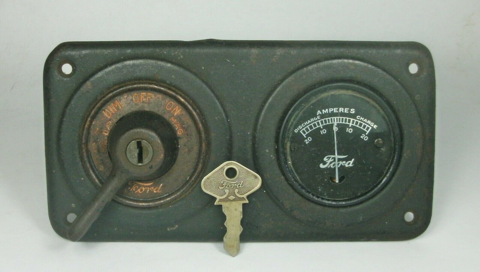

Anyone have an extrra ignition switch assembly?
I need one quick to get a car ready for my Grandson to learn to drive in, All the suppliers are out of reproductions I have sent mine in for rebuild but if anyone has one for sale it will be appreciated I have posted also to classified with no takers

Why wouldn't you just wire in some toggle switches until your switch assembly is returned? It is very easy to do.

If you already have a switch coming, I second the idea of a toggle switch from the local auto parts store while you wait. I believe they're around $5. You want a three-position switch: OFF, BAT, and MAG. If you intend to use the lights just add another: OFF, BRIGHT, and DIM, and an OFF-ON toggle for the tail light

I wouldn't even bother with hooking up the mag, just off/on battery supply. By the way I sent an Email with another Ebay listing. If you want head and tail light, I would just add another off/on switch, hook the tail light and dim side to one terminal and power to the other.
For now I would just run a jumper to ground on the generator so it does not burn out if you chose to go that route.
