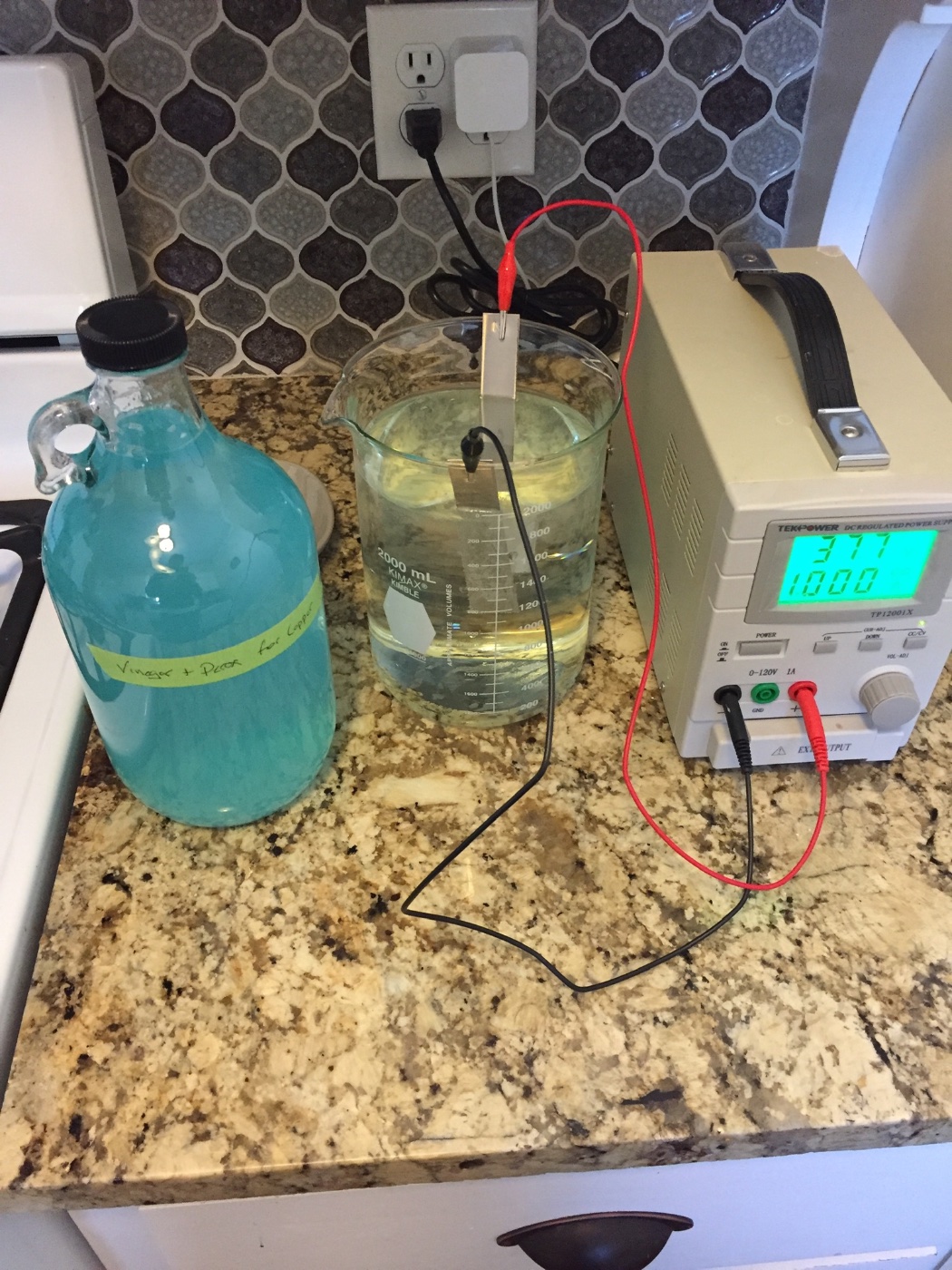

You could also try a less toxic approach by researching nickel plating with vinegar. It worked fine for me with a few small hardware parts, but I ran out of power with my 1A power generator so couldn’t do anything larger
