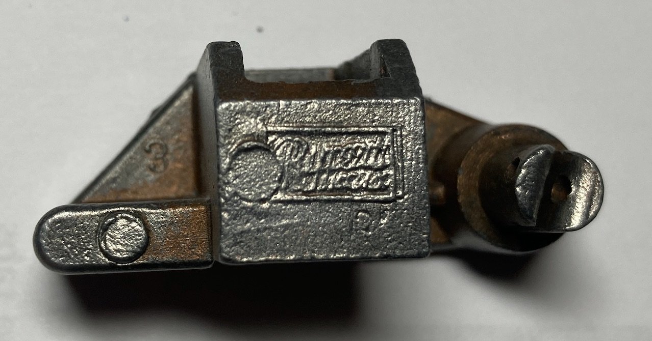

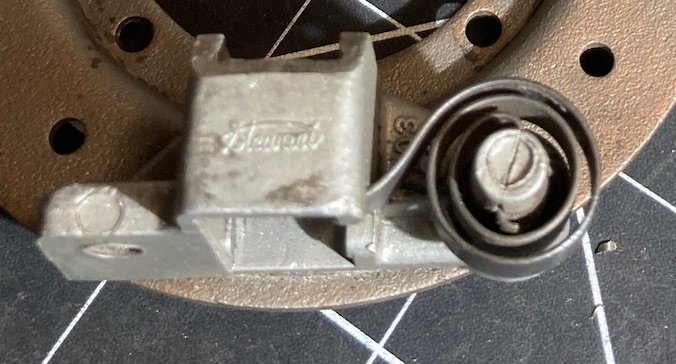

Does anyone know what material the starter & generator brush holders are made from?
It sure acts and feels like Aluminum to me, but I'm not sure which alloy. It appears different suppliers used different metals.
One of them seems MUCH better made and sturdier and heavier than all the others but I cant quite make out the Vendor name.
I'm investigating having a high-quality reproduction made. My initial supplier feedback looks quite promising using both casting as well as precision CNC processes.
This one is obviously Stewart Warner and is also very well made: I'm not looking for opinions on why or why not, just on what the best alloy to use might be.

Cuts, grinds & drills like aluminum. Does not deteriorate like pot metal.
Consider 6061-t6. Cuts fast & well for CNC machining.

Modern alloys will easily mechanically outperform any original casting material. Consult with your potential manufacturer as to their most common materials. Most likely billet machined will be 6061 and casting A356

Send some to a metallurgist for assay. They will tell you the exact percentages of all contents.

Originals are most likely die cast from Zamak, or similar.
https://en.wikipedia.org/wiki/Zamak
https://decoprod.com/design-support/zamak/
You might want to look at lost wax investment casting for new ones.

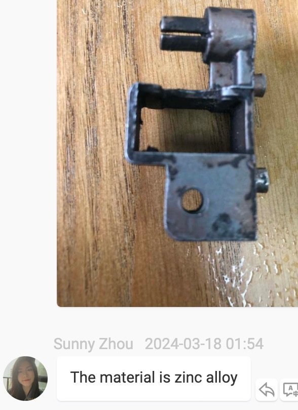

Jeff- take one to a scrap dealer/ scrap yard and have them shoot it with an ZRF gun. That will tell you the alloy rather than sending one to a testing lab. Even if you have to pay them some $$$ to do it. My guess is aluminum, similar to the magnet support spools for the flywheel.
AdminJeff
Re: Starter brush holders - what is the metal?
that is an interesting idea!Dan McEachern wrote: ↑Mon Feb 19, 2024 2:40 pmJeff- take one to a scrap dealer/ scrap yard and have them shoot it with an ZRF gun. That will tell you the alloy rather than sending one to a testing lab. Even if you have to pay them some $$$ to do it. My guess is aluminum, similar to the magnet support spools for the flywheel.

Mystery solved - at least for this particular one!! I'm sure its whatever scrap metal they could find 100 years ago, all melted down.
