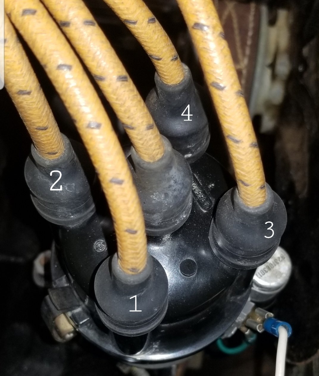

So I was looking at pictures on the cars for sale forum and noticed the firing order. I questioned it if was 1342 and was informed it's 1243.
So I took another look at my car and the picture below is what I have. I noticed the other cars #1 is where my #3 is. I did not wire the car and this could explain why it's potentially not running correctly. I had it running a few weeks ago, got it up to temp. Then I could not get it started.
Some history: Did some re-wiring of some bare wires, I have nice points spark and spark at every plug. I thought I was getting fuel but I think my needle is sticky so Lang's sent me a new set that arrived yesterday. (Under the weather so I couldn't get anything done today)
Any advice on my firing order is welcome.

Additional info. Picture taken standing next to the passenger fender so #3 is closest to radiator.

The physical location of the wire on the distributor makes no difference. Unless there is a wire length issue. The only thing important is the firing order of 1-2-4-3.

Gotcha. I have some wire swapping to do.

Which direction does the distributor turn. Clockwise will give you 1243, counterclockwise will give you 1342. I have no idea which.
If they are wrong, I doubt it would run at all. If it did, it would be so bad that you certainly would know something was wrong. Or, I might kick the stuffin's out of you or the starter. I'd have to think about that though.
Another thought though, how old are you. Young folks don't know clockwise and counterclockwise.

Where is the rotor pointing when #1 is at top dead center?

Toward the position on the cap where the wire going to the #1 plug is if the cap was on the distributor. I start with no wires, put #1 at TDC, look at where the dist. rotor is pointing, and that's where the wire to the #1 plug goes in the cap. Crank the motor 1/2 turn - now the rotor is pointing where #2 goes. Nother 1/2 crank, and it's pointing at #4, so the #4 wire goes there, then you do 3.
When you're setting up, I was told to pull the spark lever down 3 or so notches, so you have a retard setting while starting with it all the way up - I've had Distributor equipped T's snap back and try to bite me if you don't do that. Ouch.
Sounds silly, but different distributors set up differently... Sometimes the gears aren't indexed correctly, but this way your dizzy will still work.

Didn't swap a thing and I was finally able to get it re-started. It runs great and there's still things to do.
