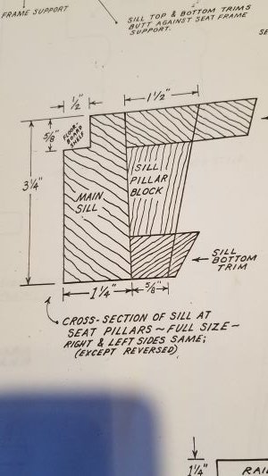

I have a 24 roadster can be seen here https://www.mtfca.com/phpBB3/viewtopic. ... 50#p319179. I gathered up all the brackets and parts for the most part. I intend to fab a new wood structure to hold it all together does anyone happen to know the size of the main sub rails mainly height and with

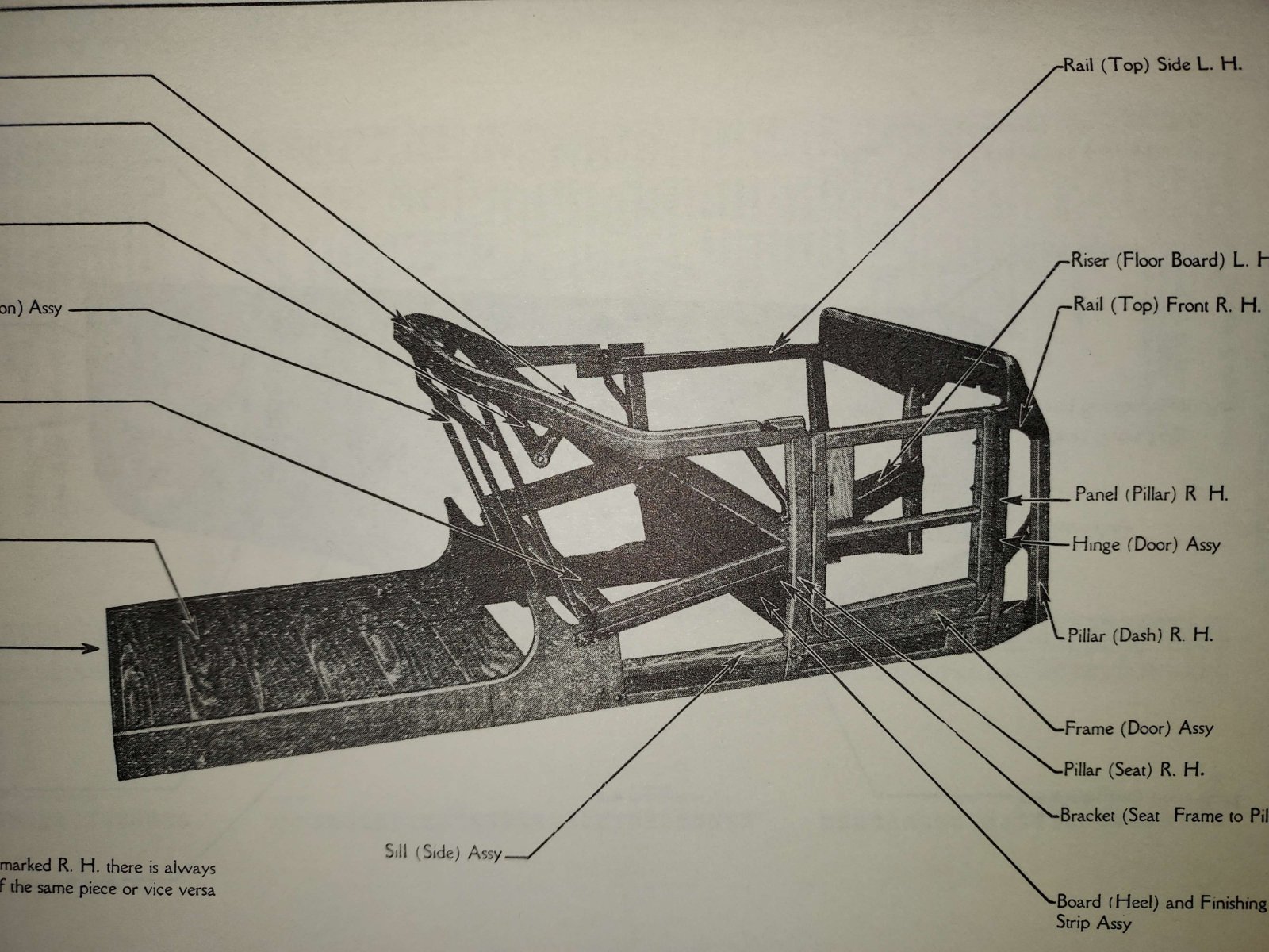

Its complicated. Search for some older posts for rewooding a roadster. Rewooding a body without plans or decent original parts to copy is going to be almost impossible.

Post by Plankhill » Tue Mar 26, 2024 4:58 am
The main sill is 1 1/4" by 3 1/4". The trim is curved to fit the body. The sills are 76 1/2" long

Post by Mark Gregush » Tue Mar 26, 2024 4:35 pm
Not the sizes you need help with but might let you see what is involved. https://www.facebook.com/photo/?fbid=10 ... 3468094629
