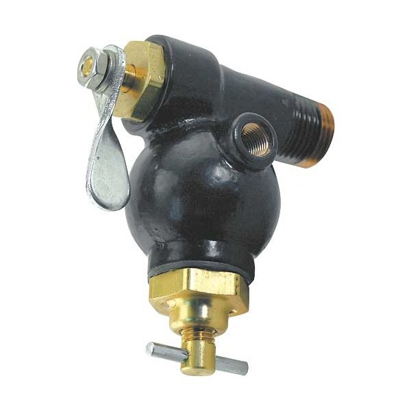

I need to install the sediment bowl to the cowl gas tank, thanks

Yes it is an original cast iron bowl

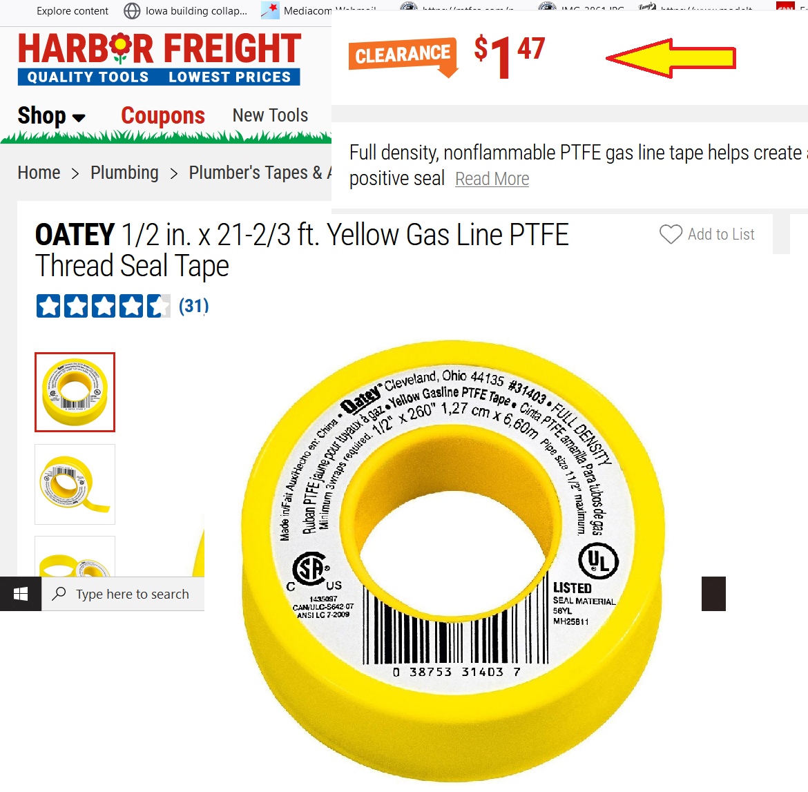

Mark Gregush wrote:
Wed Mar 20, 2024 10:55 am
* Contains PTFE
* OEM-specified
* Standard applications: stainless steel fittings, head bolts into through holes, oil psi sending units/sensors, oil and coolant lines, intake manifold switches, rear axle fill plug, fuel fittings
* Motorcycle applications: timing hole plug and oil hose fittings
* Heavy-duty applications include drain plugs, all tapered fittings
I agree that PTFE tape can be used for gasoline. BUT I don't trust the color of the tape to indicate its overall use (too much stuff made overseas :cry: ) prefer that it states what its made of Material Polytetrafluoroethylene or just PTFE
Oatey is available most everywhere & looks like I'm headed for Harbor Freight Today
