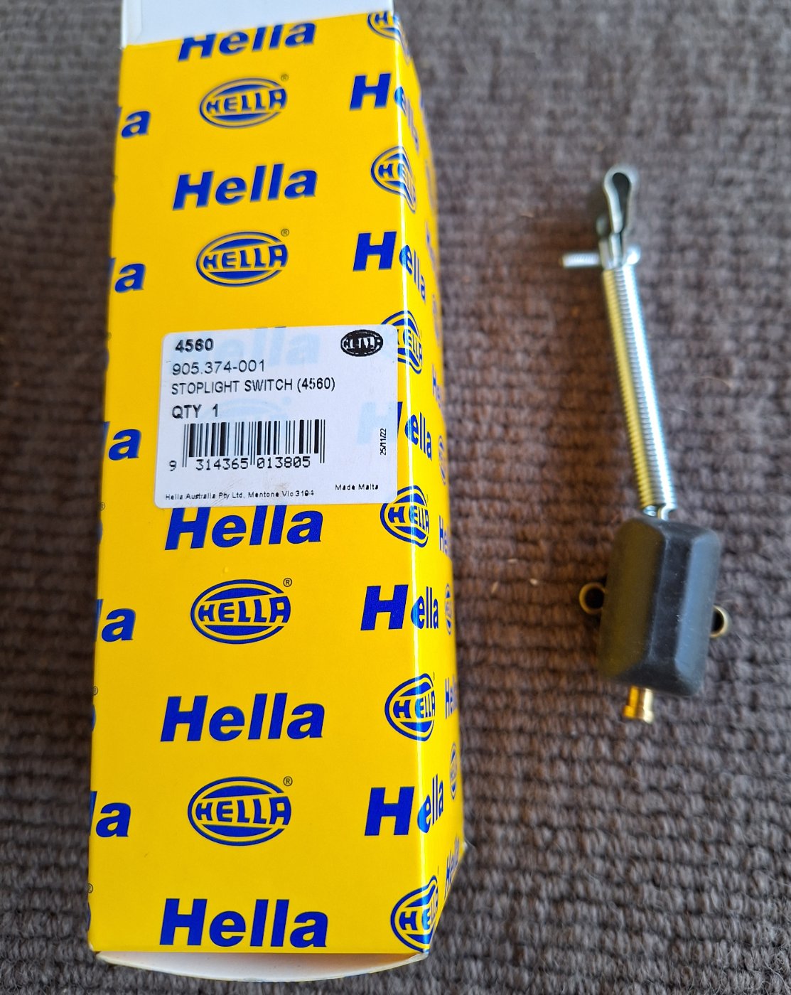

My brake light switch went down so I had to replace it. This is a genuine Hella product, like the one it replaces. They are easy to mount, easy to access and easy to adjust.

My brake light switch went down so I had to replace it. This is a genuine Hella product, like the one it replaces. They are easy to mount, easy to access and easy to adjust.20240319_171120.jpg
Do you mind posting a picture or hand drawn diagram of how its mounted?

Terry, I'm all dressed up ready to go to lunch. I'll see what I can do later. Briefly, i bolted a little bracket to the running board support. It's angled so the plunger is in line with the pull. I used a pull wire fastened around the brake pedal. That wire is a piece of hi-test welding wire. It is adjusted to length to suit the application, leaving a couple of inches of wire spare so later adjustments can be made if required.
I liked the fact that I could still buy a replacement for the one that failed. No modifications were needed for this replacement.
