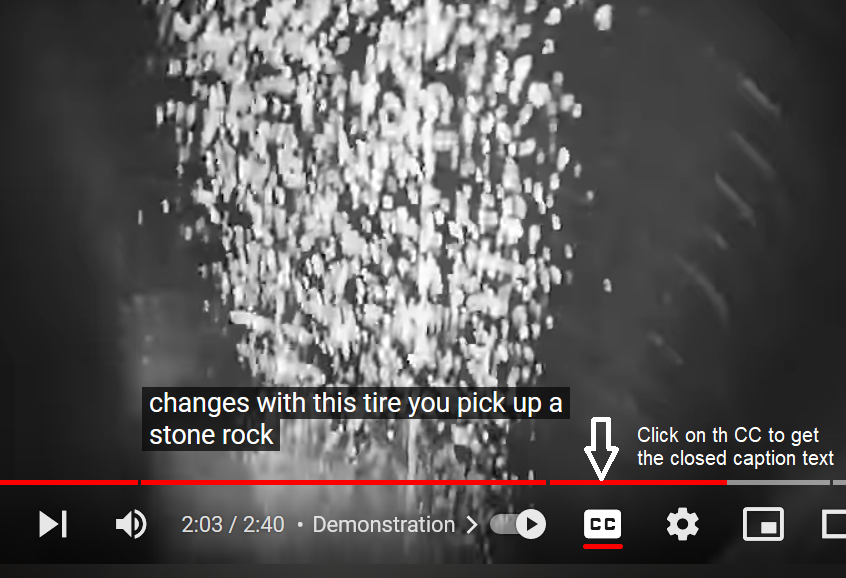

Re: balancing beads
Video of balancing beads inside the tire in action. They put a mini mini camera inside the tire
you'll need to wait abit to skip over the ads https://www.youtube.com/watch?v=_7CghNsdGbk
