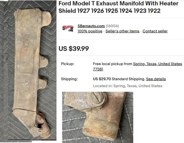

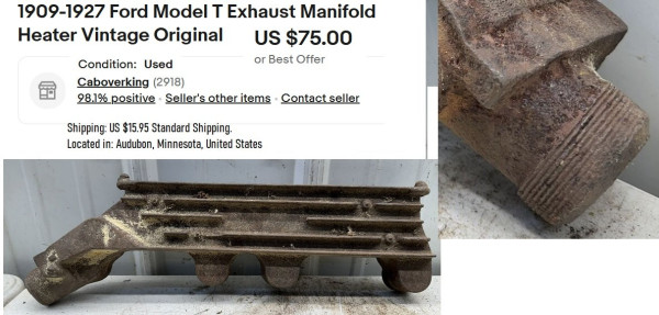

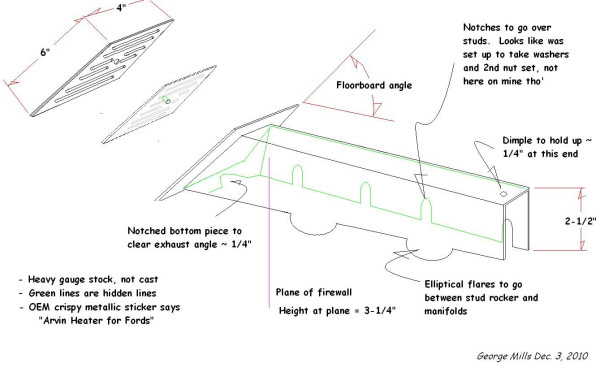

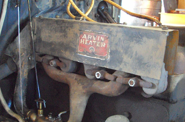

The plus on the exhaust manifold is that it not prone to warp but check the threads
The ARVIN on eBay
https://www.ebay.com/itm/134990497521?i ... R8ip1bjQYw
https://www.ebay.com/itm/256283378615?i ... R9Sn5LjQYw

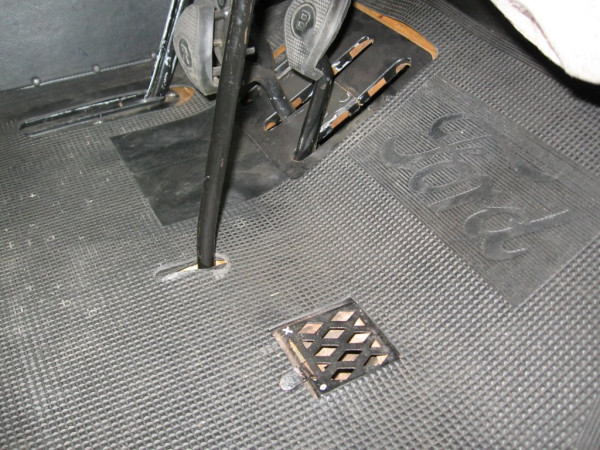

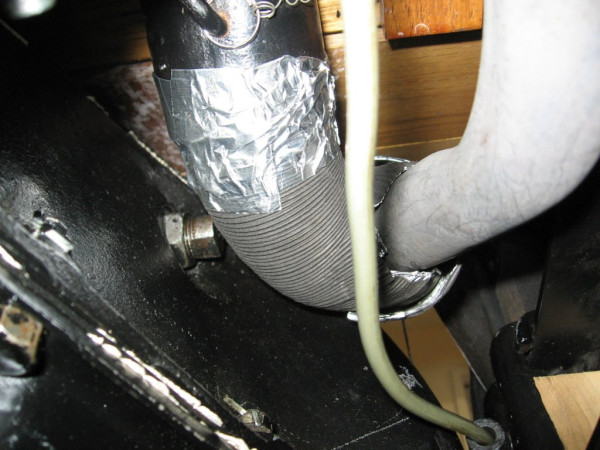

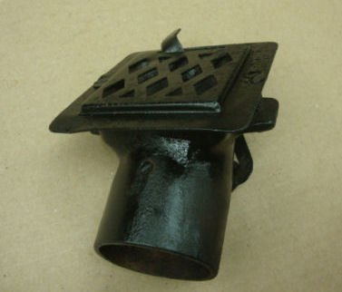

Here is my setup, I found the floor grate with damper on eBay and made the exhaust shroud out of a couple of pieces of flexible hot air intake hose that you can get at most auto parts stores. The shroud intake is down low, so it isn't visible from the engine compartment. Better than nothing! :)

Post by Rich Eagle » Thu Mar 28, 2024 1:54 pm
https://www.mtfca.com/phpBB3/download/f ... &mode=view
The heater label on the heater that TRDxB2 shows is not correct but one I copied and added on that heater. I'm sorry if I have added to the confussion. That was my best guess at the time.
