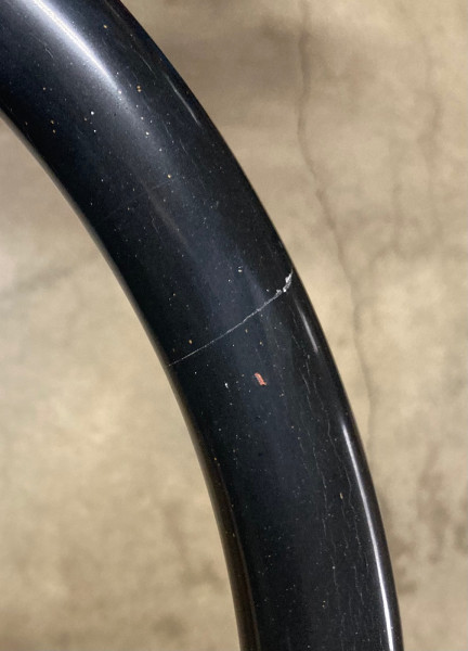

Does anyone have any tips on refurbishing the old rubber black steering wheels? Mine has some cracks and is generally worn looking.
