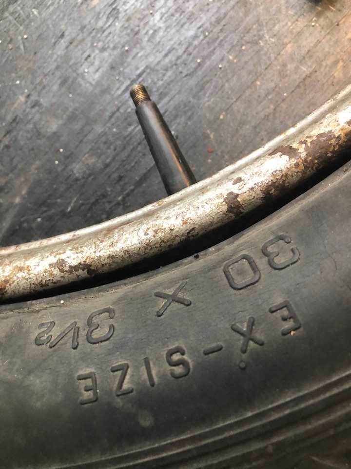

I’m trying to mount so tires with new Coker tubes, after killing 3 new tubes I’ve ran into a new issue. In my last tube I can’t get the tube to seat in the grove. I’ve tried two separate rims thinking that was the problem. Tomorrow I will try a different tire.I tried to load a photo but don’t think it worked

Sence the photo didn’t show every time it’s next to the tire valve

Sorry, I was at an almost Abba concert when I was try to type. What I was trying to say I tried two different rims and had the same problem, Both time right at the valve. The bead doesn't want to seat in at the valve. Norm, What should I cut?

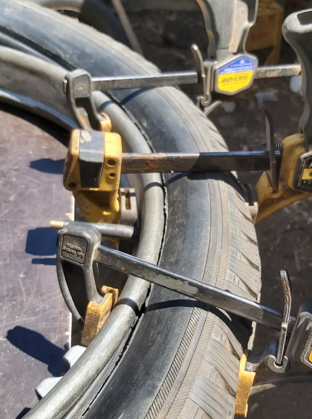

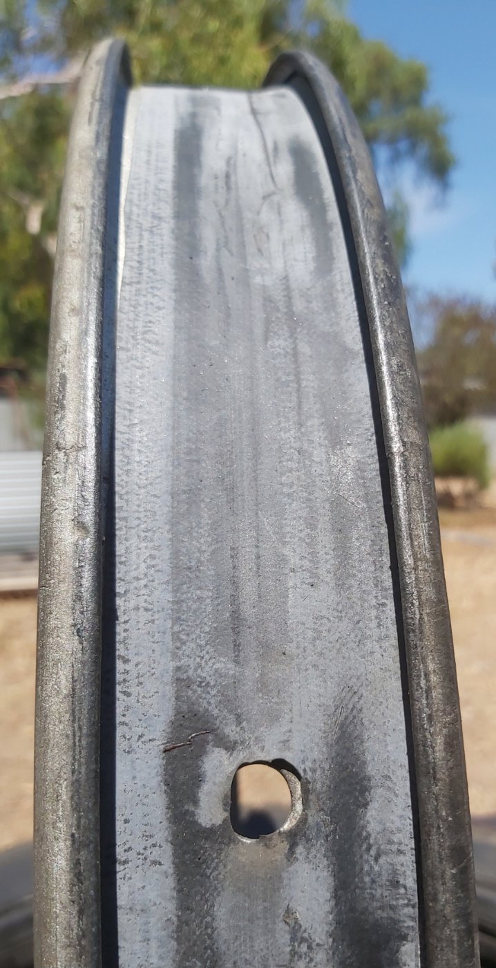

Found these two photos.
This shows a rim liner made from the OD of a 14" inner tube.
When fitting this hard old Olympic tyre I used 3 clamps, just because I could. Notice the beads are not yet levered on past the clamps. Tyre lube even helps th tyre slide on the levers when working around the rim
