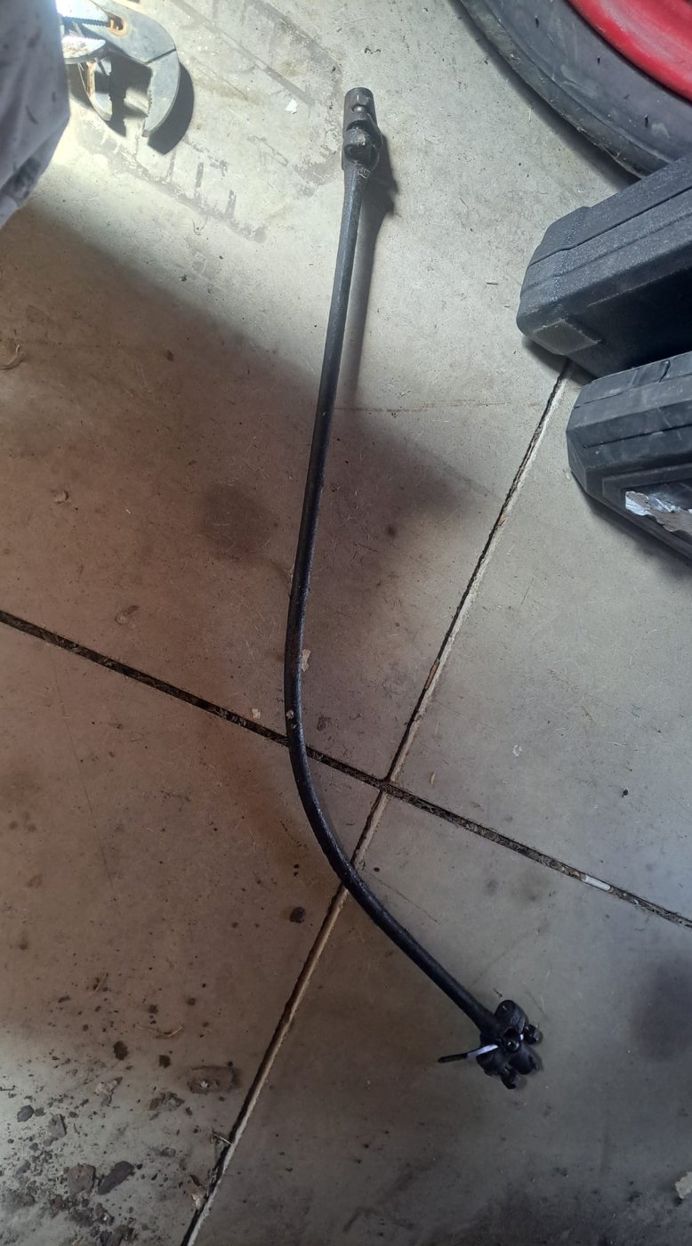

A local gentleman asked for guidance regarding a '27 Tudor that was owned by his recently-deceased father. His father hit a rut when parking the T and bent the drag link. I told him that it could be straightened. Then he sent this photo. I am questioning my advice. What do you all think? I saw older threads about straightening drag links but none were bent this bad. He is checking with another local T owner who might have a spare link that is correct for an improved car. But, I hate to see the bent part discarded if it can be repaired.

WOW. I dunno in all honesty but my gut tells me to "fuggedaboutit". There's gotta be a better one out there somewhere.

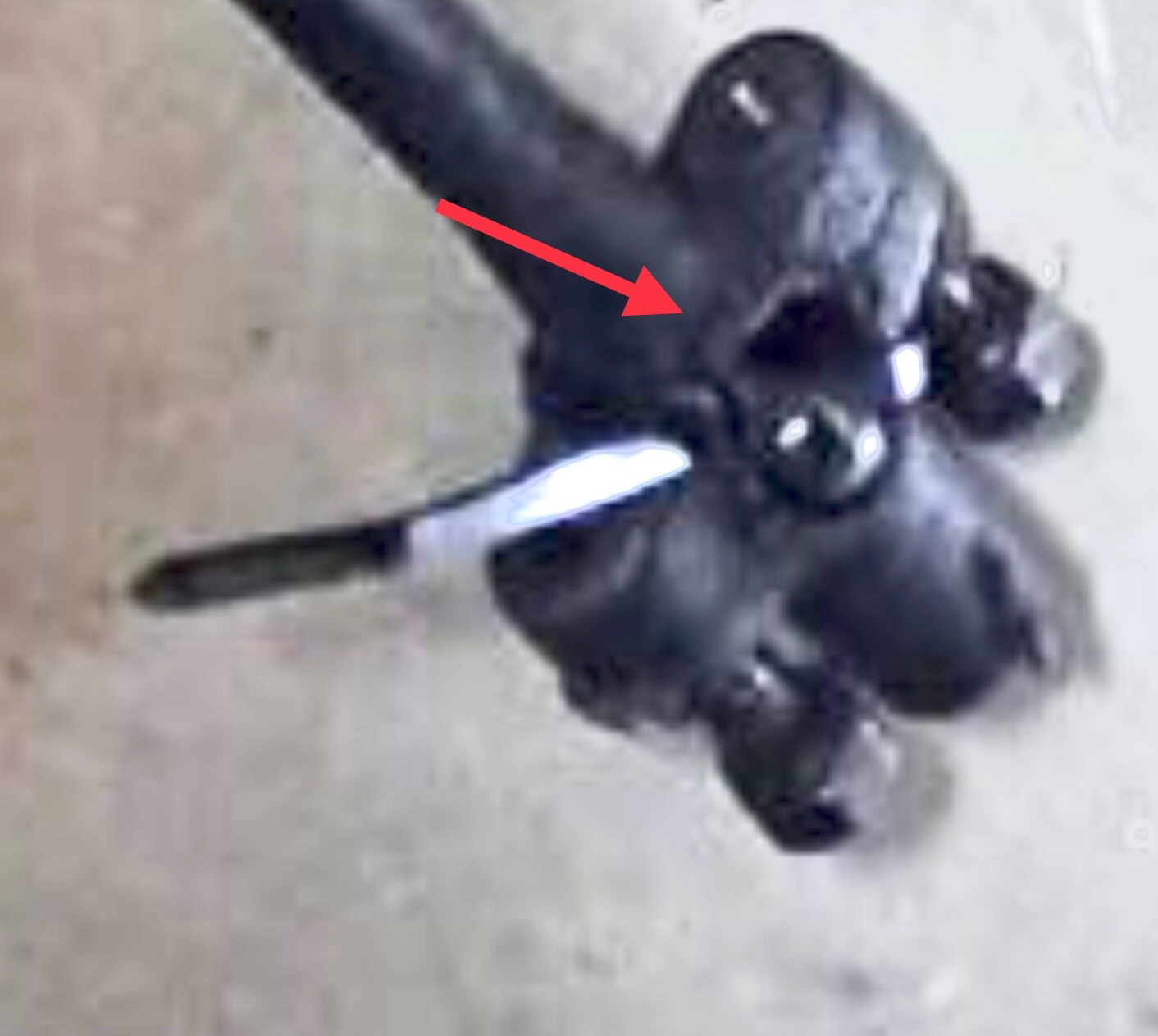

I agree with you Adam, 100%. And I told him to check ends first since he has an Apco spring cap on one end. That suggests wear on the ball or cap or both.

End shows a well worn socket cupped edge, better to replace than repair

A long gentle bend like that indicates that it was somewhat bent before the rut it hit.
Speedsters often need to have that drag link bent slightly to reach between the pitman arm and spindle connections. And they rarely get bent like that while being driven.

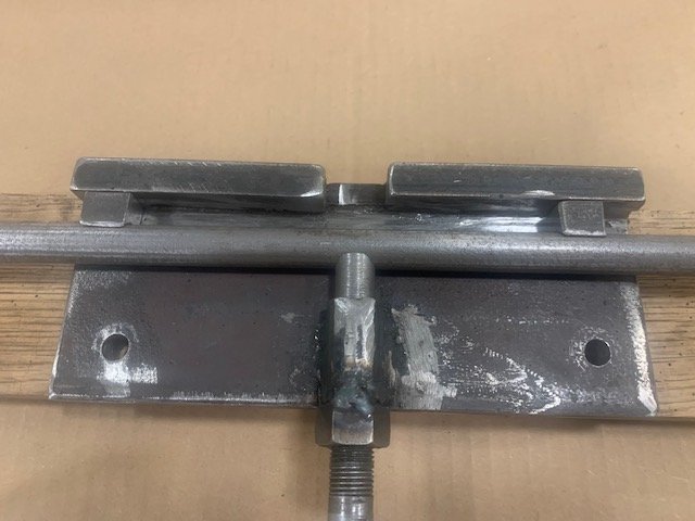

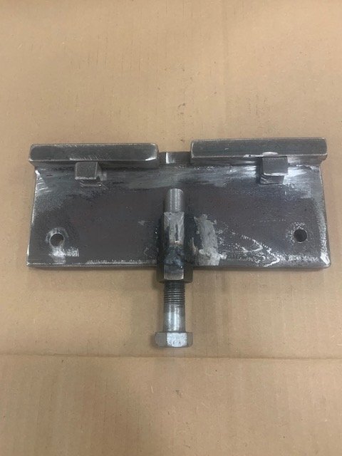

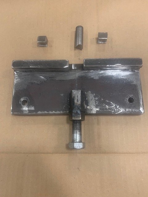

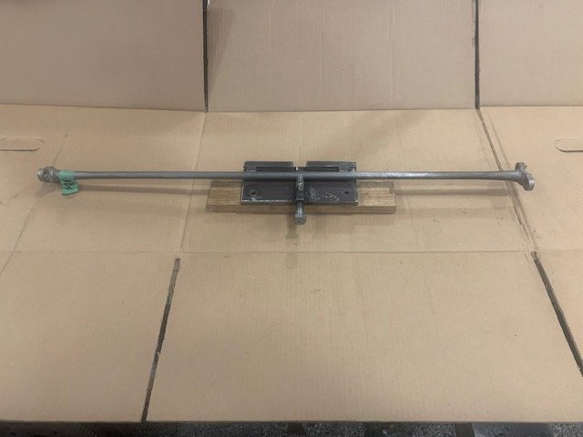

The drag link can be straightened. Never beat it or you could work harden the metal. First, I use my press to get it visually straight and then I use the bench mount press I made for the small bends.
I use a light spatter of quick dry paint and a long sanding block to indicate the bends. I move the small blocks narrow or wide to fit the sharpness of the bend.

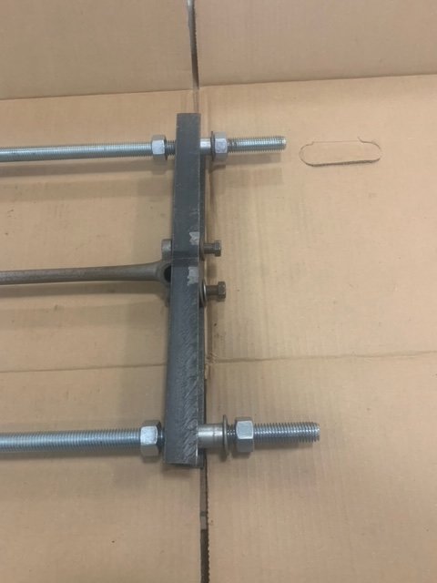

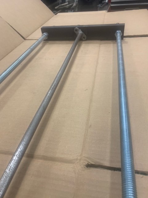

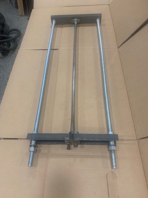

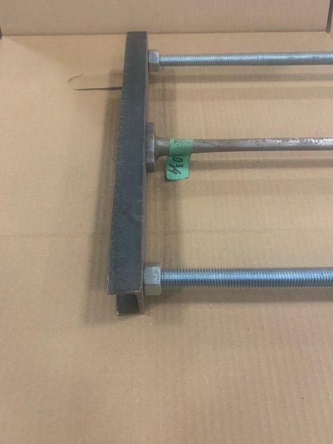

For the ends, I mount it in the frame with one end fixed and the other threaded end for pulling the ends to parallel to each other. You can reverse mount it in the frame to correct the opposite end.
As the drag link ends are 45 degrees to each other, to correct the twist, mount both ends solid in the frame and leave the working threads loose on adjustment end so you can twist the frame until it sits flat on the work bench.

Nice jig there, Ken !
