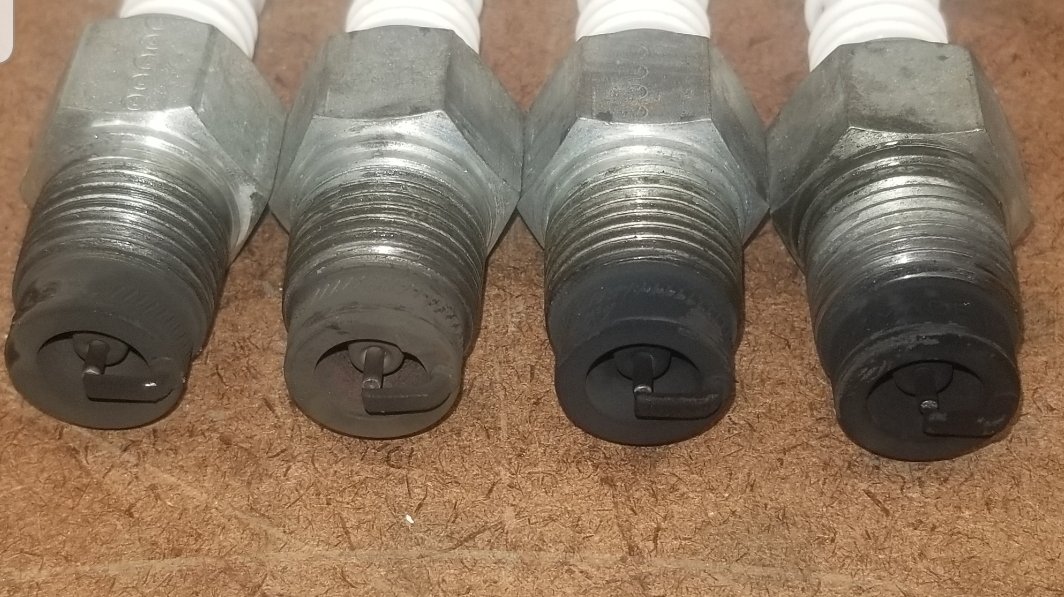

Finally, got it running. All electrical issues worked out and it starts almost immediately. I had it idling for about 15-20 minutes to bring it up to temp. Other than a few small oil leaks, I'm chuffed. Timing lever was about 6 clicks out, throttle was all the way up at it's shower speed.
Please let me know what you feel I need to do based on the look of these:
1 on on the right and I have the needle out 1 full turn.

Put them back in and drive the car. I have personally never cared what spark plugs look like. If it runs well, drive it.

The plugs look like the mixture is a bit rich, but I pretty much agree with Jerry.
Once you are comfortable and familiar with the car, you could experiment with leaning the mixture out a bit, but if the car develops less power, pops back out the carburetor, or misses on hard climbs, put the mixture back to where it is now.

At idle I would expect to see soot. I would drive it and look at them after about 40 or 50 miles of cruising speed. they most likely will not all look the same but it should be less soot.

Those look normal - not oil soaked, I'm assuming the one on the right is #1 which IS the cold and distant plug, so yeah, it's always sootyish (at least ours were)... I chased that gremlin then realized there was no gremlin to chase.
Put em back in and run it!

I did and she fired right up. Pulled it in and out of the garage under her own power. Quickest seasoning Awakening of and off my cars. Looking forward to taking it on the road soon..

If you are using a high volume auxiliary oiler, the # 1 cylinder may get more oil than the rest, especially at low speed and load or idling. Oil level too high will cause the same thing. Drive the car on the road for an hour or so, then look at the plugs. If you have a water pump, you need a thermostat.

If after running the car down the road for an hour or so, look at the plugs. If the front pair are still carbon up (darker in color) than the rear pair. Tighten up the rear manifold clamps. The rear has an air leak causing you to set the carb richer which makes the front pair carbon up.

I would suspect that the first two are running colder than the rear 2. This is because the most direct path for the coolant through the block is between the input and the output. So at slow speeds the front two would be colder. This would be especially true if you have a water pump on the engine.

No water pump or oiler to my knowledge.
