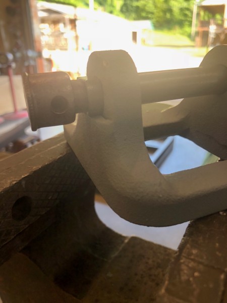

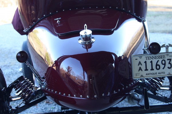

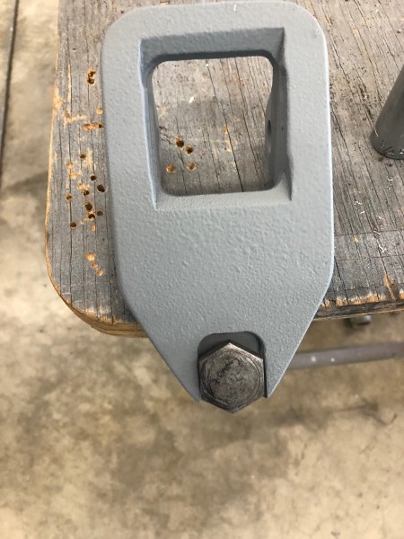

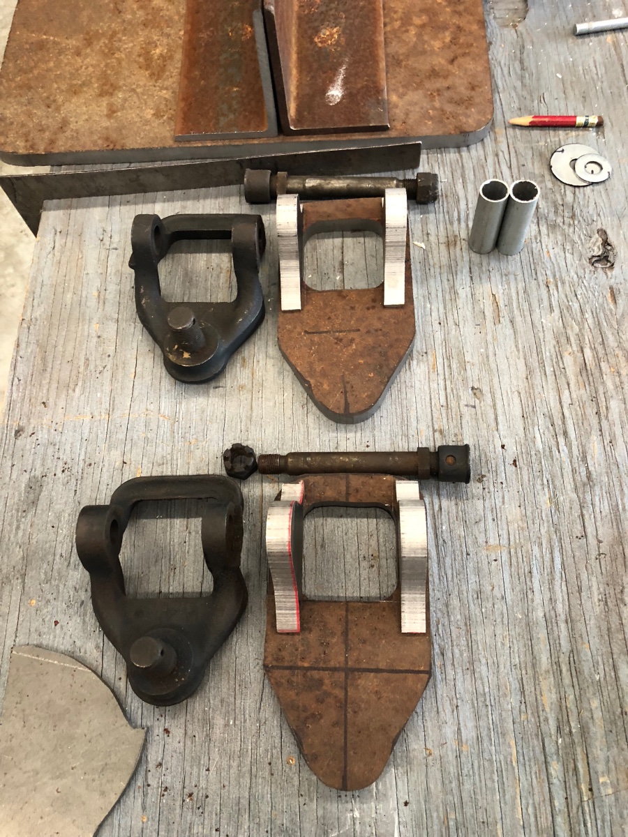

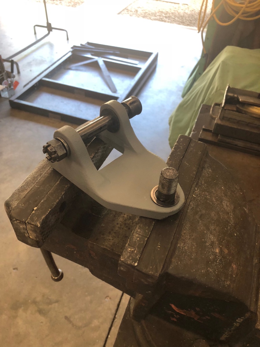

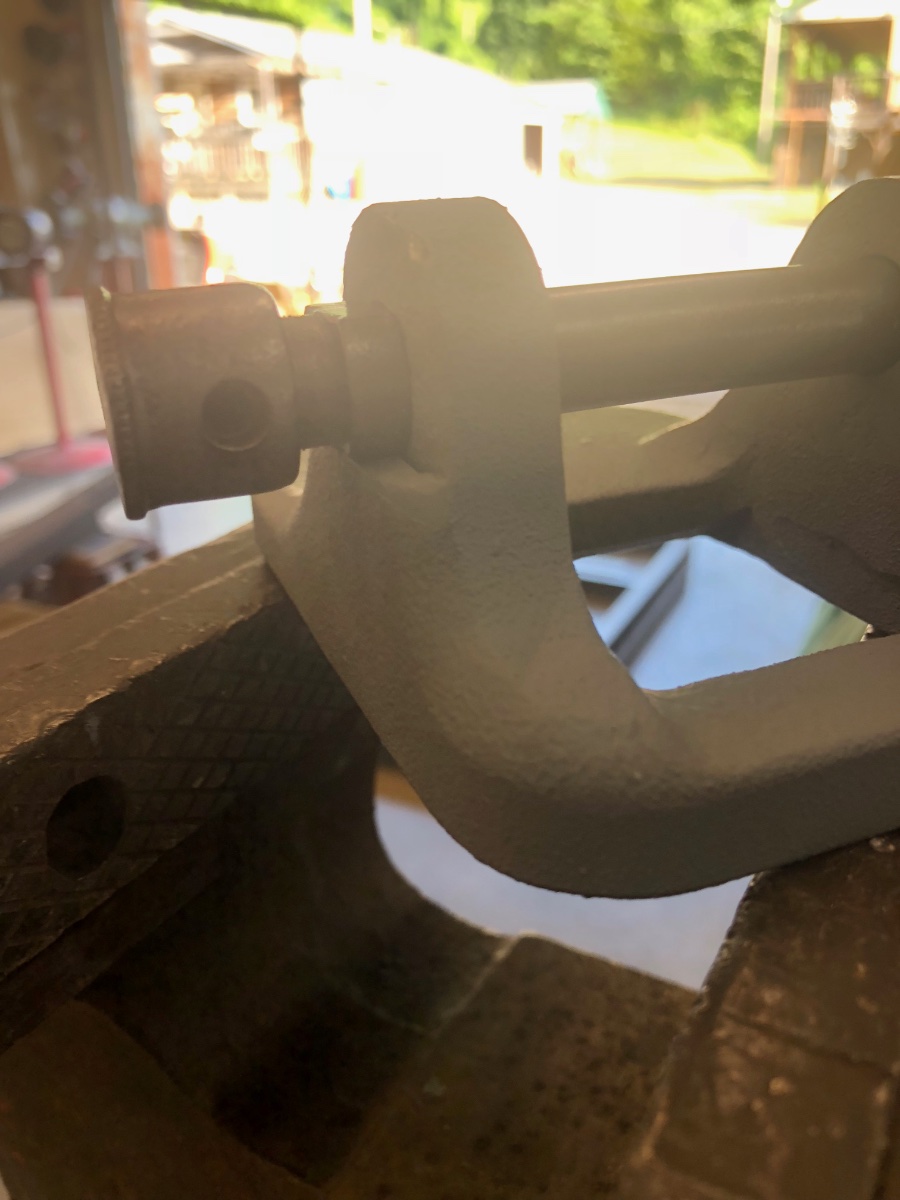

Frank Brandi was patience enough to wait 5 months for these Hassler's rear shock mounts for a big drum. I had to make an addition set for myself anyway.
They work well and he liked mine on the 1925 Speedster. Extending 1 1/2'" and installing a reverse eye main leaf brings it right back to correct ride height. Enjoy!
