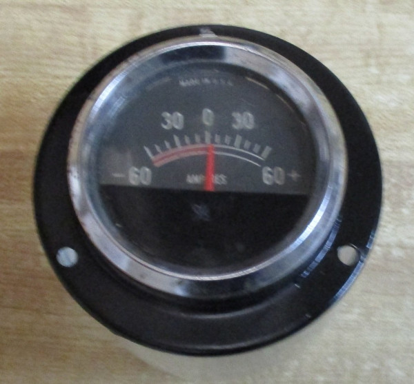

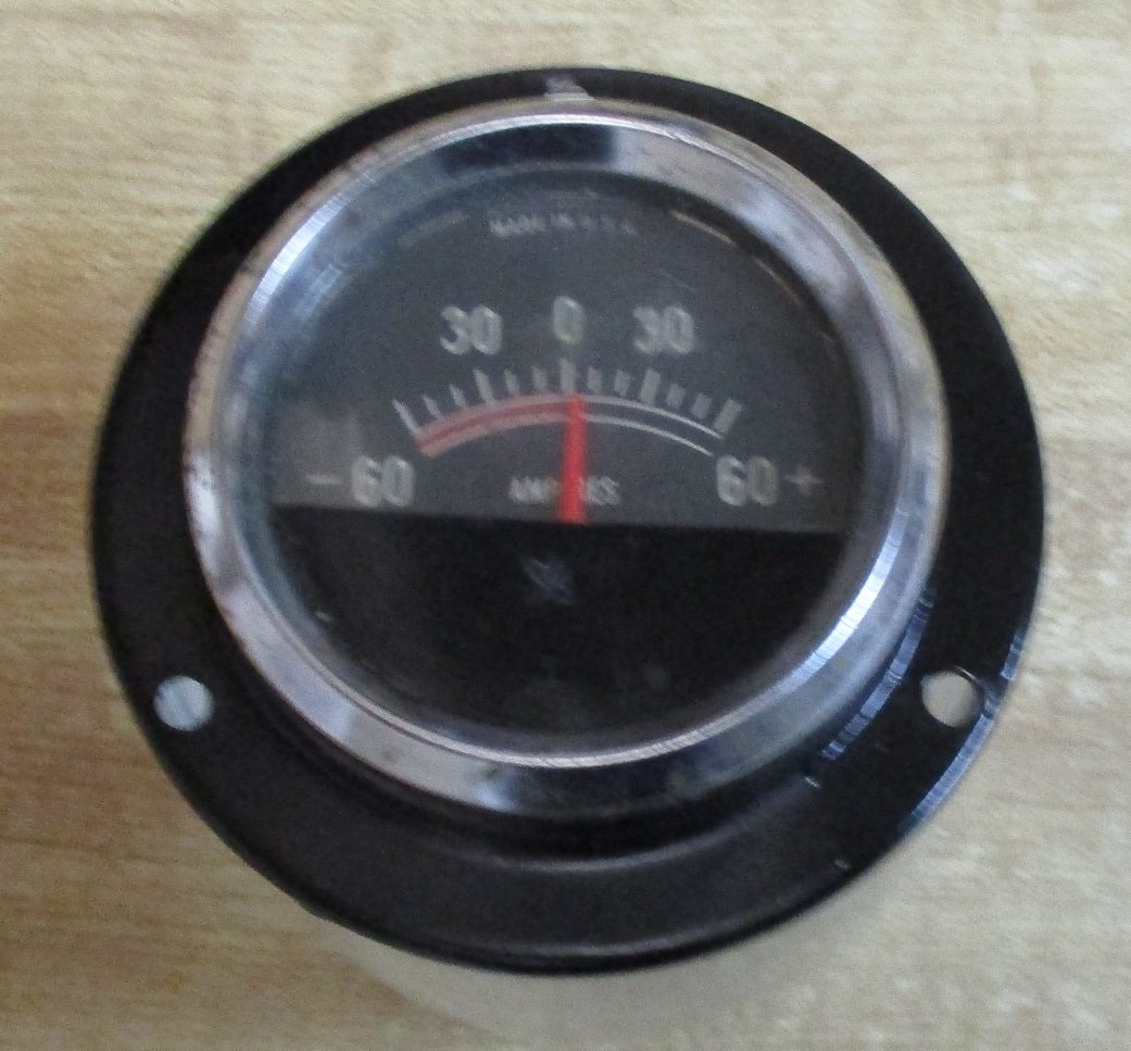

Henry Ford evidently made 2 Inches the standard instrument gauge.
You can buy the adapter ring used to replace the larger ammeter space used or 1919 to 1925 Model T Fords.
Then enlarge the inside are to a 2 inch circle and insert any gage you wish, ammeter, voltmeter, etc.
I have done several and inserted the Ford Tractor Ammeter and other larger 60 0 60 ammeters.
They work for 6 Volts, 12, Volts or whatever you wish.
Stewart Warner has a lot of gauges you can use.
The firewall hole behind the 1926 - 27 smaller dash panel is laege enough so you can do the same for that panel.
This is a 60 0 60 I did recently.
