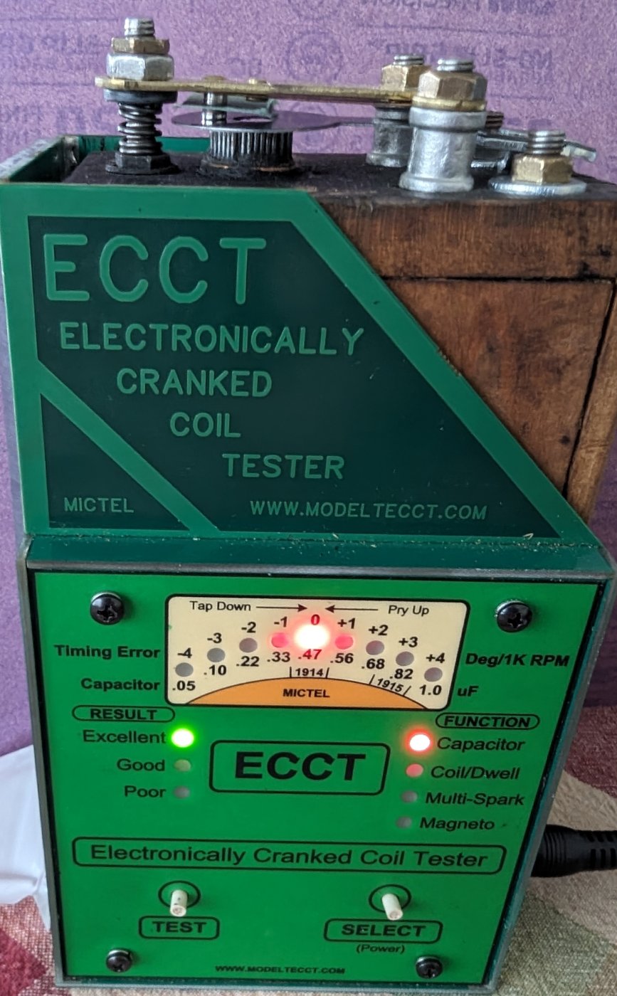

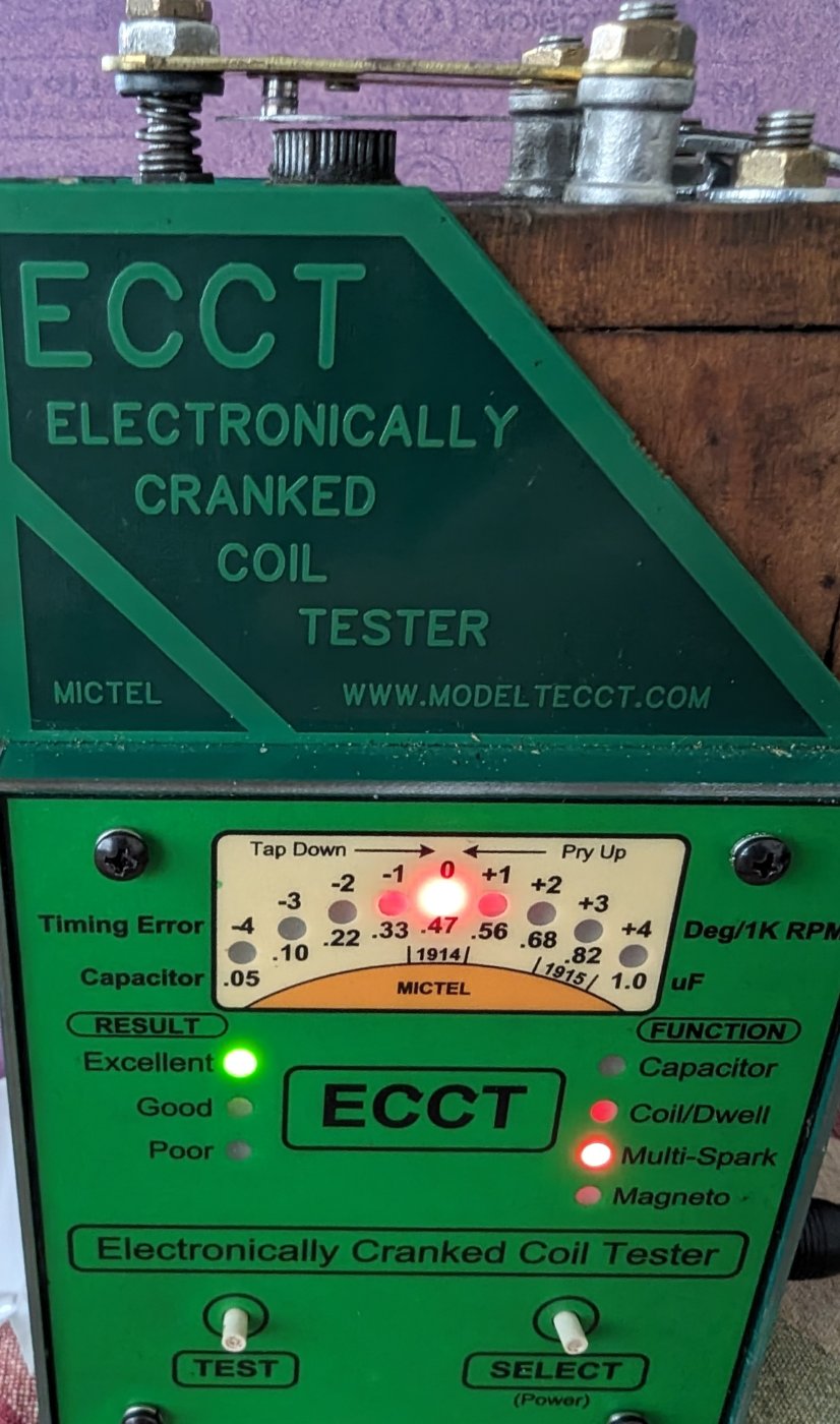

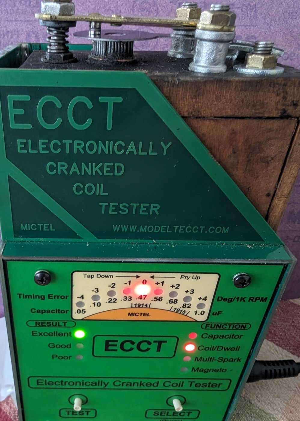

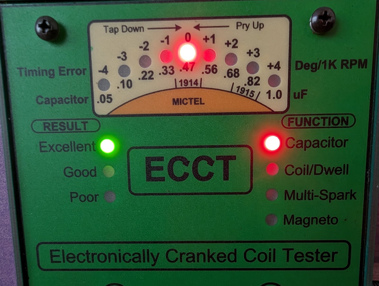

Ralph... Here are some pictures from my file showing results of proper ECCT coil results

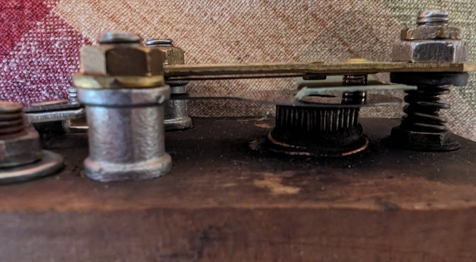

Post by Moxie26 » Sun Mar 31, 2024 6:41 pm
Since the iPhone camera will not accurately photograph things due to camera position, I assure that the upper bridge is perfectly straight to the surface of the wood coil case and to start there is a 0.030" gap. Coil adjustment will change during testing.

Post by Moxie26 » Sun Mar 31, 2024 8:14 pm
Extra photos found in stash...

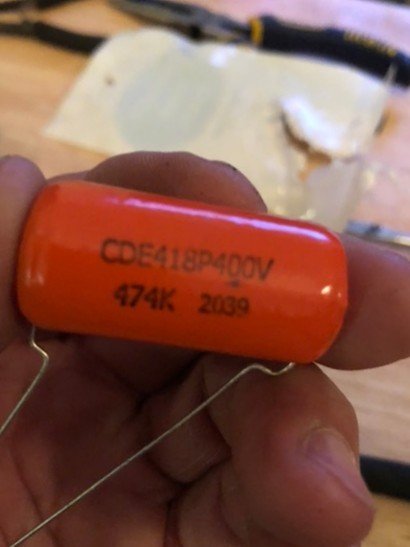

This is the correct capacitor that our major vendors have available. . .... Some have referred to this as the "orange drop" capacitor.

Mouser Electronics sells reliable high DvDt capacitors.
Part #598-225P47494YD3. Made by Cornell Dubilier - CDE 225P47494YD3
That’s where I ended up buying mine.

The capacitors sold by Langs and most T suppliers are a custom
made capacitor for the Model T coil.
They have an even higher dv/dt that the SBE 418 or 225 series capacitors.
The current price of the 225P47494YD3 at Mouser is $9.04.
The current price of the coil capacitor at Lang's is $3.95.
The Capacitor question comes up periodically on the forum.
The best capacitor and best price is for the one from the T suppliers.

The 418 series capacitors are the ones that I received from one of the major suppliers of Model T parts

The 418 is what they sell, They don't sell custom made caps.

Post by Moxie26 » Sat Apr 06, 2024 10:41 pm
They sell what is beneficial to coil needs and performance.
