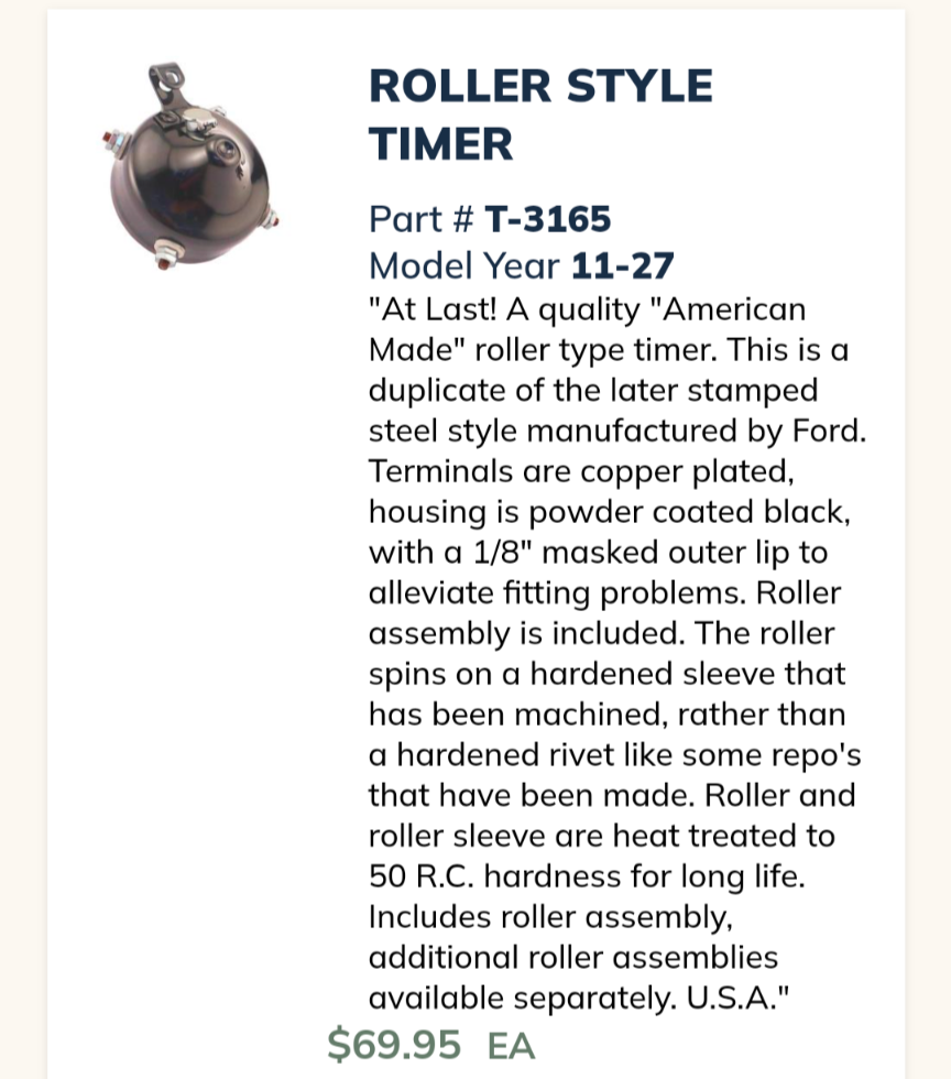

Snyder's makes (I believe) and sells new complete roller timers. I just put one of them on our 1911 touring.

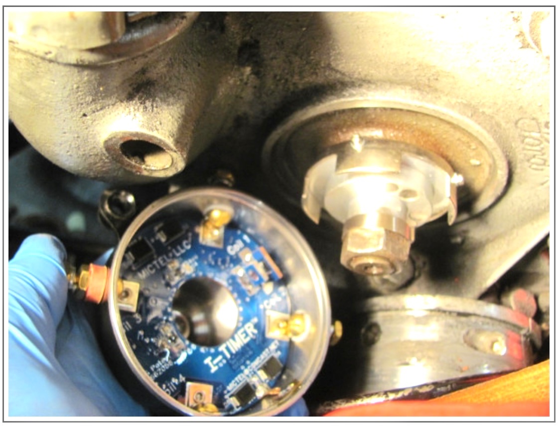

I-timer as well. It's inductive/magnetic pick up is more like a timer in my mind vs the E-timer which is more electronic and self regulating.
- Posts: 4090
Re: Timer questions
Absolutely, the I-Timer is for us flywheel magneto guys
The E-Timer runs only on DC, for those unfortunate Fords with disabled flywheel magnetos.
While you can’t start on mag as the I-Timer needs juice to initial fire, once running on DC Bat, just switch to Mag, and hear those rpms pick up due to the higher AC volts from the magneto that properly drive the vibrator coils as intended for hottest spark. Engine performance is enhanced too by the I-Timer , works on DC or AC, the best timer ever IMO.

Good plan. I too carry spare timers, but have only used them to help others on tours
The I-Timer is now going on 7 years duty on my ‘27 touring, and never a blip!
