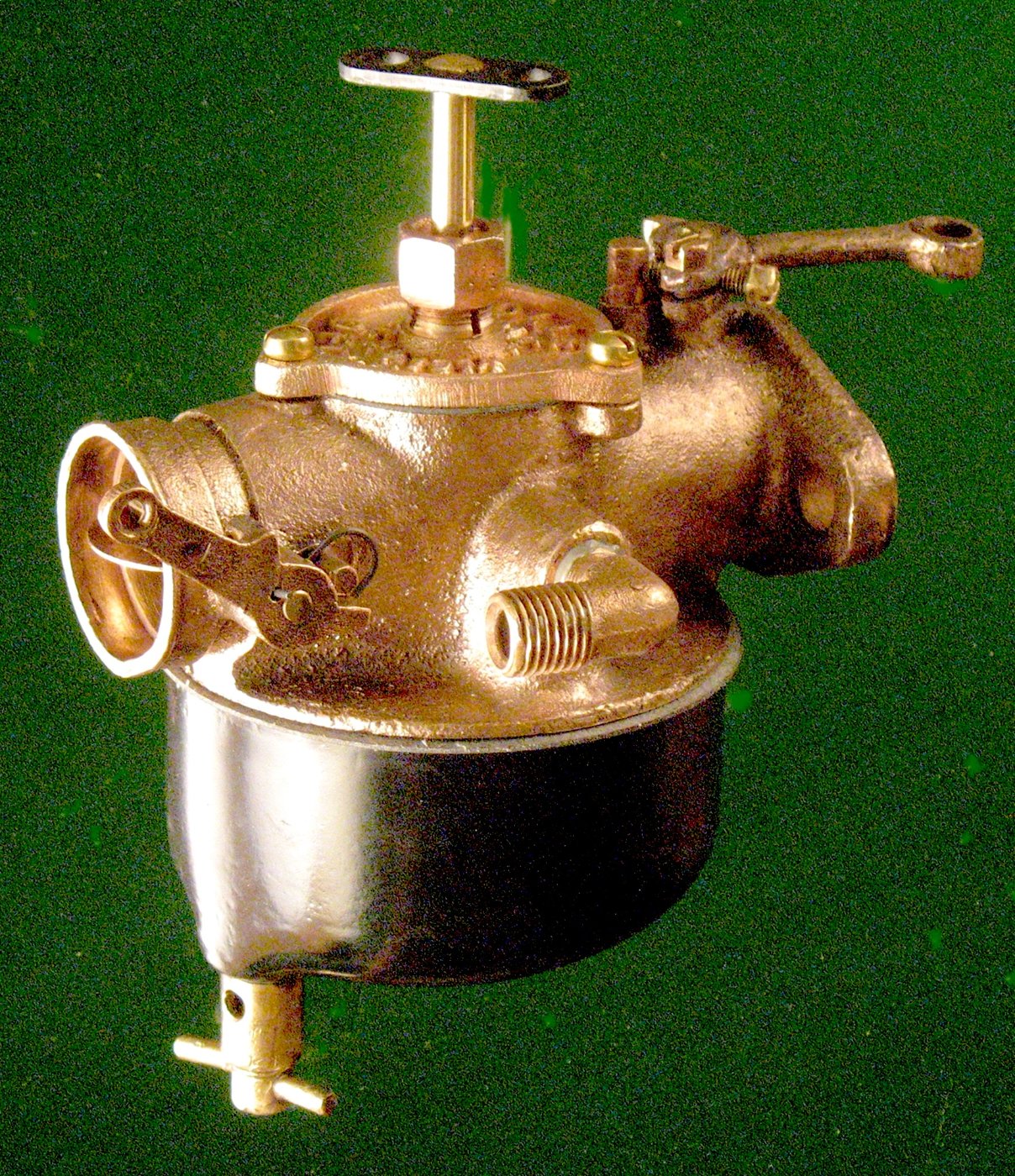

Have you tried the MTFCA Carburetor book? The list of people who worked on it reads like a Who's Who of Model T experts, so It may be useful. The G I like best is the bronze version. It cleans up very pretty.

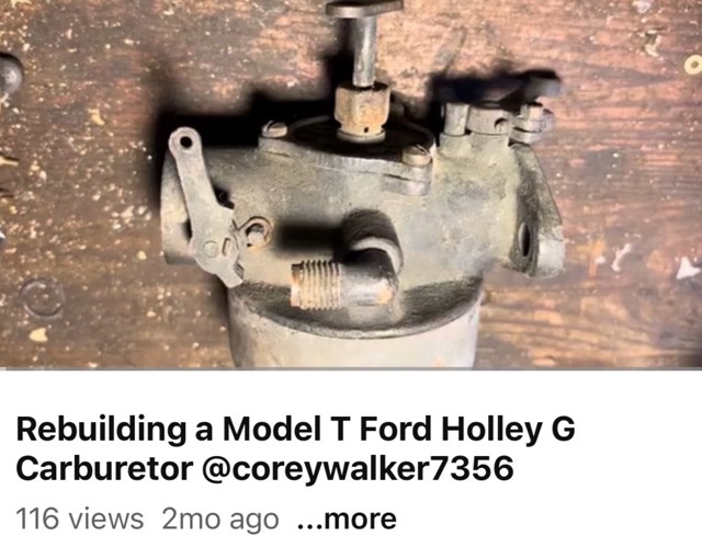

I made this video. Don’t know how to post a link but you can look it up on YouTube.

Here is the link to Corey’s YouTube video
https://youtu.be/ONGpHw4HO34?si=-UnjBrX3VsyIURvW

Steve, Yes, I have the bronze body with an UNCRACKED bowl. I checked the carb book out in the catalog, but it didn't say if it covered all the carbs or just a couple. I do have all the DVD's, but didn't see anything on carbs. Corey, I just spent the last half hour trying to find your video and all I could get was the one from Model T Ford Fix. While a very informative video, it doesn't go into a complete tear down and how to clean passages. Thanks to Joe I can now view it. Just took a really quick view and it sure looks like what I need. Finally, Ron, I've been looking over Corey's rebuilds and they look like they're done very well. Unfortunately, I have to try EVERYTHING myself first. I like to tear things apart and see how many parts I can leave out that they really didn't need! (just kidding). I'll look over the video later tonight and see if things look doable. Thanks for your help.....

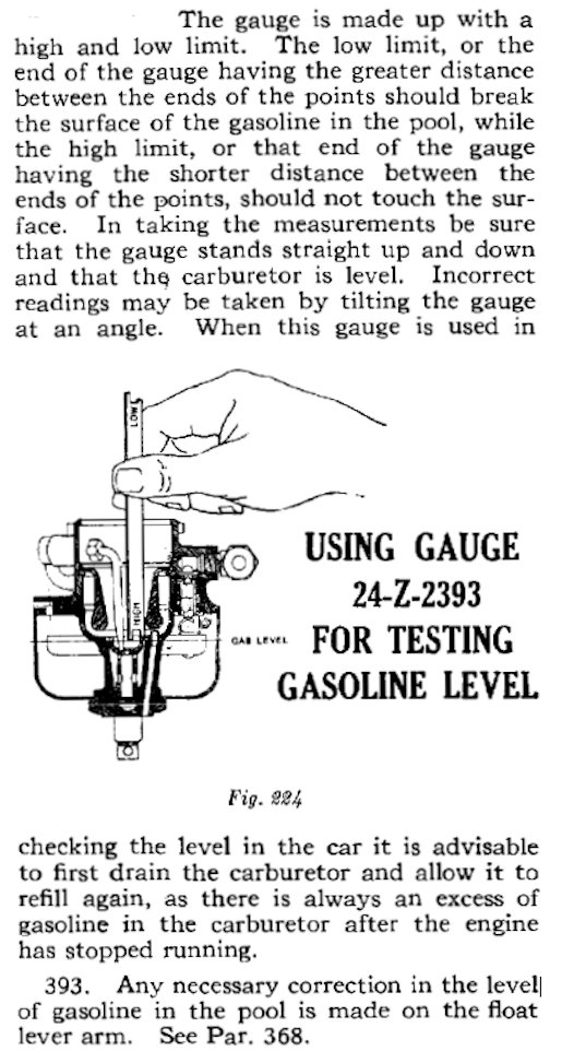

Corey's done a handful of G's for me & some referrals - the G is quite particular on fuel level in the well - good luck !

...the G is quite particular on fuel level in the well...
There's a little tool for setting the fuel level in a G. If nobody sells the tool you can make it yourself. Somewhere I've seen the measurements for the tool, but I don't recall where.
