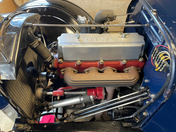

For what it’s worth, I have a Rajo Model 30 head with a Stromberg RF. Have never had a water pump (or circulator) and have never overheated or boiled over. That said, I just replaced a 100 year old worn out honeycomb radiator core with a new V-cell core. But even with the old core, it never overheated.

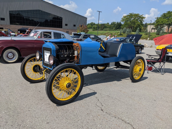

Thanks! I really like your T btw, dual ignition? What type?DaveBarker wrote: ↑Thu Mar 28, 2024 12:27 pmFor what it’s worth, I have a Rajo Model 30 head with a Stromberg RF. Have never had a water pump (or circulator) and have never overheated or boiled over. That said, I just replaced a 100 year old worn out honeycomb radiator core with a new V-cell core. But even with the old core, it never overheated.
DaveBarker
- Posts: 78
- Joined: Thu Jan 17, 2019 2:49 pm
- Last Name: Barker
- * REQUIRED* Type and Year of Model Ts owned: 1919 Speedster
- Location: Fairport, New York
Re: Rajo OHV question
Thanks for the compliment! No, it’s a basic Texas T dizzy, standard four plugs.

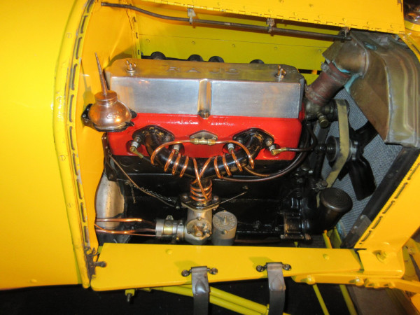

For what it's worth I've run both ways in old number 4 and saw very little difference on the Motometer. Not even close to overheating. To clarify, the head is a Rajo B. Engine, stock crank and cam. water pump is the Stockton, in the neck between the head and the radiator (a water pump that's a little better than nothing, in my opinion, but with a cross drive magneto drive it's the only easy option). And I'm running an early, pre 17 style, aftermarket honeycomb radiator. several years ago I was having a problem with the water pump and while it was being fixed, ran the car for a year or so without it and saw very little difference in the water temp (according to the Motometer). Then while preparing for one of our trips which included a drive across
the state of Nevada in July and I thought, "Hot Hot Hot, I better get the water pump back on". So bottom line, I couldn't tell much difference.
Ed aka #4
Ed aka #4

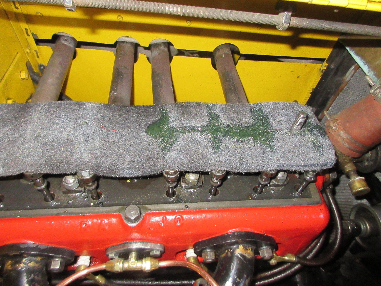

Thanks for the insight Ed! How well does your heat tubing work keeping your intake warm? It’s a neat look. Whole engine bay is very nicely done. Feel free to post more pics of your T/engine if you like!

The wrap on the intake took care of the carb and manifold icing up (on a 104 degree day!) long story that I won't go into here but 20 or so years ago that happened. I installed the wrap and it hasn't happened since. As for the other side of the engine, I don't have a picture of it but no great loss, not much to see just the exhaust header and Bosch magneto. But here's a picture of the pad on top of the rockers. My morning lube routine on long trips is to lift the pad and a shot of oil directly on the assy. then a "streak" of oil on top of the pad. You can see the "streaks" in the picture taken as I was in the process of oiling. First on the front half of the pad working my way back to the rear. Good for the day's drive.
Ed aka #4
