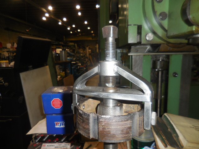

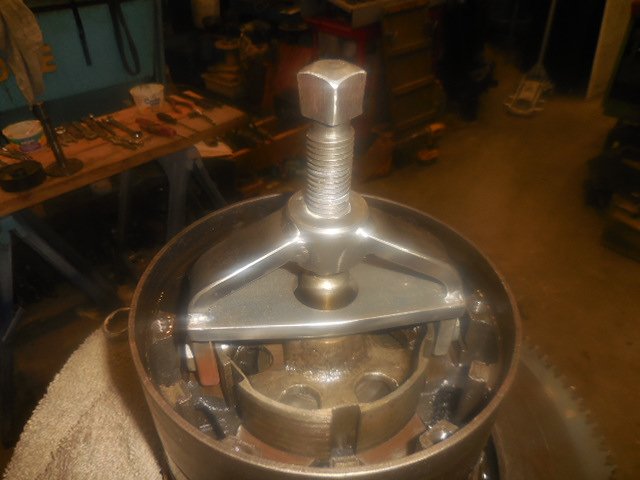

I gave up trying to work with my clutch drum tool
After fighting with the removal of a rather difficult (stuck) drum I decided to make my own that would remove any clutch drum. The ford tool was very old and I had to straighten it back to the original shape way to many times. This one will last.
- Posts: 5599
- First Name: Henry
- Last Name: Lee
Re: I gave up trying to work with my clutch drum tool
Looks Good Bill!

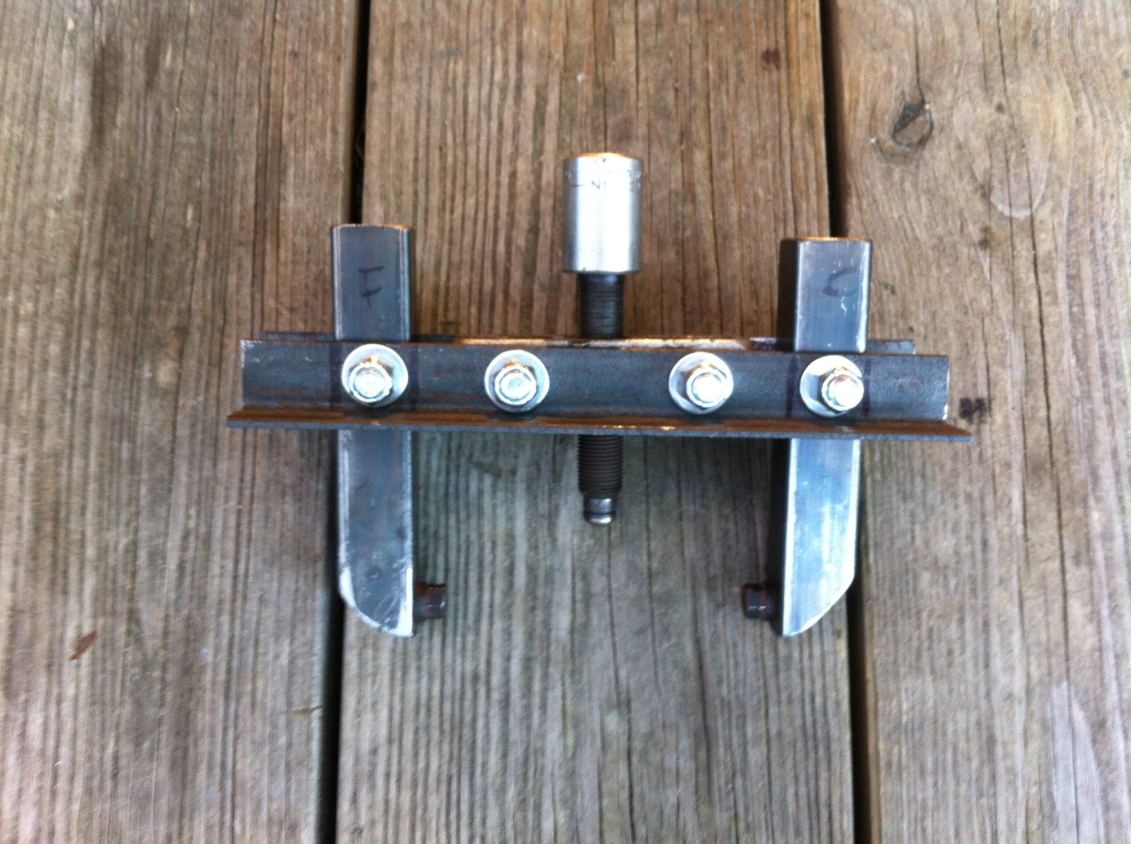

Great job Bill, looks really beefy.
I made this one from scraps in my shop when i was in a pinch, and wasn't willing to shell out the big $ for a Repop.
So far, so good.
