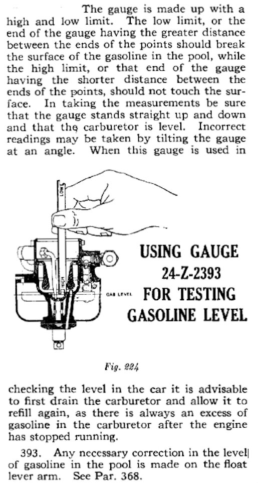

Post by Steve Jelf » Fri Mar 29, 2024 11:54 am
Here is the service bulletin page describing how to check the fuel level in the Holley G carburetor. Somewhere I have seen measurements for the gauge. If that was in a service bulletin I missed it. Where did I see that?

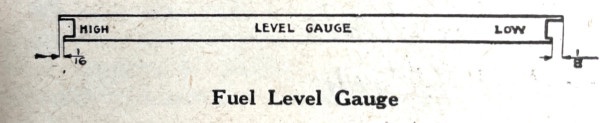

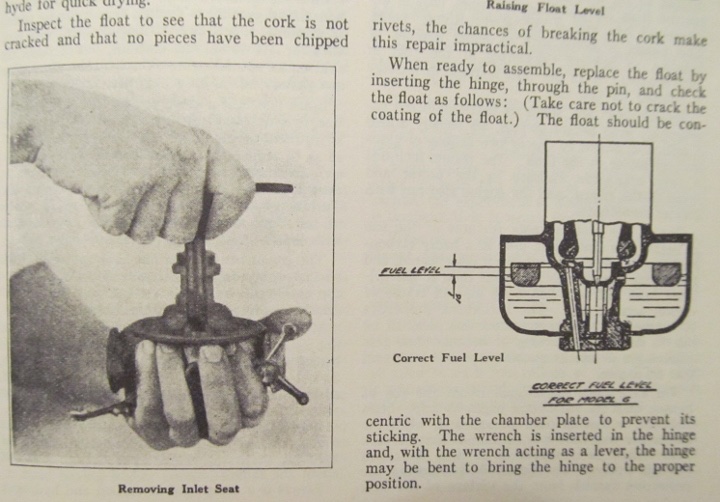

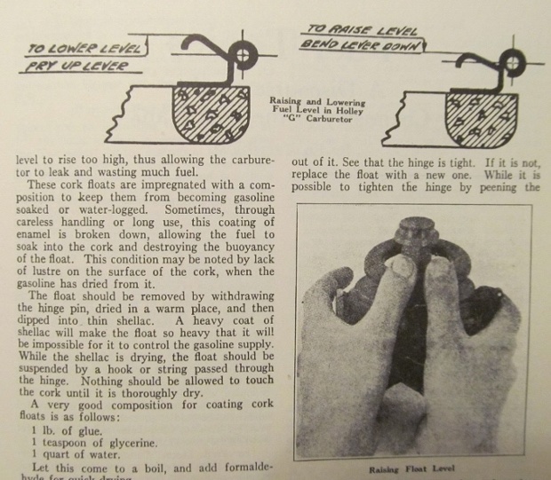

Here's some detail of the Holley G float setting and gage.
