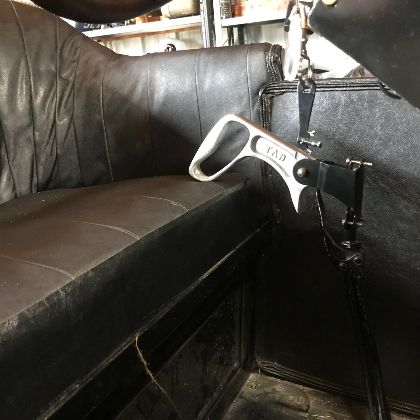

Thanks for your replies. I wonder if some of you would be so kind as to post photos of your lever installation? One complicating factor for me is that I have a lever extender that I am unwilling to part with. The silver handle just touches the front of the seat when in neutral.
In the photo the parking brake has been applied. I have hydraulic disc brakes and am unlikely to ever have to use the emergency brake function but I do use the parking brake sometimes.
