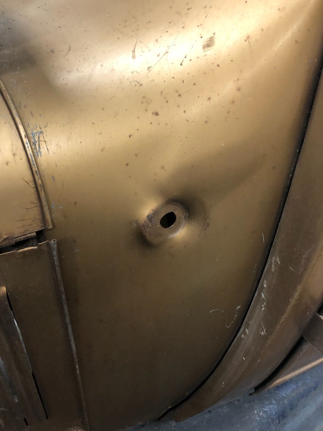

The local VFW regained possession of a T that was original to the little town. One thing that sticks out is the hole in the cowl . Sure looks to be a factory looking hole. Anyone know what it is? Thank you

With a matching hole on the passenger side, would think someone added electric cowl lamp that had single post, like early Chevy.
Or could have used a later Model A style cowl lamp, those have a post with flange the might have made that impression in the sheet metal.

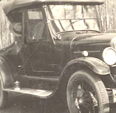

This fancy runabout had lots of extra lamps, one on the fender, one on the cowl and even the dressy 'lantern' on the running board!
dressed up runabout.jpg (49.5 KiB) Viewed 2796 times

For a spare tire carrier?

If it just has the one hole, my guess would be that it was for a radio antennae.

In my other hobby, military vehicles, we wonder till the cows come home what Bubba drilled that hole for. We may never know. If it's drivers side, my initial thought would be some sort of spot light. I would think most radio antennas get mounted on the passenger side, but it's Bubba's car, he can do with it what he wants.
I guess the consensus is that it is not factory. So, what for? The world wonders.

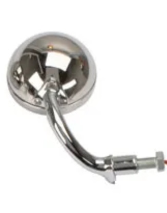

There were some bun type side lights with fixed mounting studs on the side rather than the usual rear studs. If there is a corresponding hole on the other side, they could be sidelight mounting holes. The indentation is such that it would aim the lights to the front. It would save the cost of the brackets, something of which Henry would approve.
