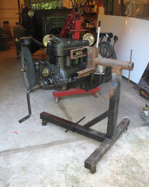

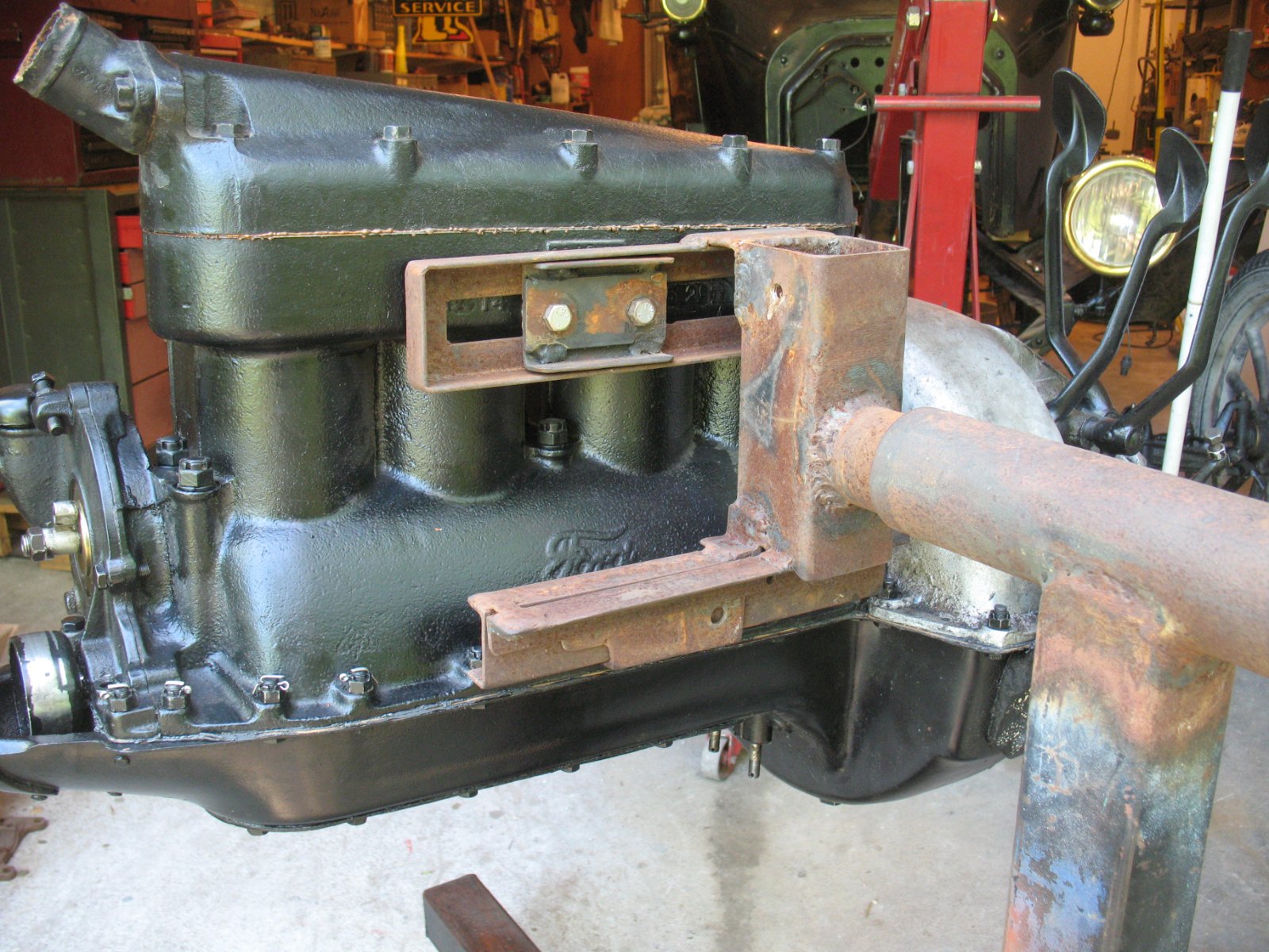

- Posts: 7393
Re: Two Questions . . .
I can't recommend a brand or model, because the business end of this stand is home made. But I can tell you about some features.
One is the part that attaches to the engine. At the bottom it has two pegs that fit into pan bolt holes. At the top are two holes for water inlet bolts. The thing is made so it can rotate 360º, holding the engine nose down, nose up, top up or bottom up. It turned out that the third feature is one I haven't used much, but it has come in handy. That is a provision for shifting the center of gravity depending on whether you are working with or without the transmission.

Jeff,
You have a great design. I have used (barrowed) a stand similar to yours, except it didn't have the feature of shifting the center of gravity. That would have made handling the engine transmission assembly much easier.

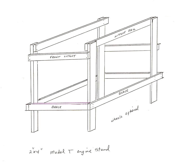

Using the same height and width dimensions as the frame, I made one out of 2”x 4”s which served me well. Assembled using 2 1/2” drywall screws, I made it waist high so it made working on the engine very easy. Very sturdy and hardly cost anything. When I was done, I disassembled it and used the lumber on other projects. No storage room needed. Jim Patrick
