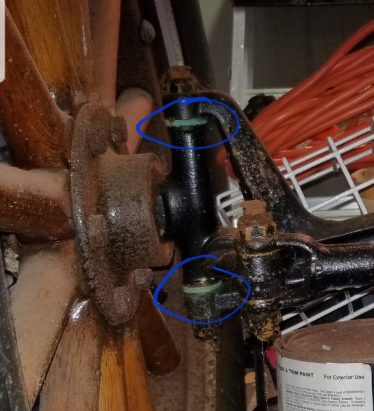

Post by vping » Sun Mar 31, 2024 11:02 am
Happy Easter.
I've only driven the car in and out of the garage, about 50 feet forward and 50 back. When backing up, I tend to stop at the garage door and then push it back in because of visibility and close proximity to my other cars. The steering is very tight. I cannot move the steering wheel when the car is sitting still.
Is this normal?
I know it's not a modern car, but even moving my older MGs, I can turn the wheel to angle the wheels in the direction I'm trying to park it.

Post by vping » Mon Apr 01, 2024 8:24 pm
I do my own king pins on my MGB. Is there a reamer available for the model T and can they be done diy? I will say I noticed some play at these points.

Post by jab35 » Tue Apr 02, 2024 12:52 am
Spindle bushing reamer: https://www.modeltford.com/item/2713RM.aspx
The close up of the king bolt bushings and radius arm bolt appears to me to show badly corroded (green) spindle bushings and severely rusted flip top oilers. Were these somehow exposed to acid fumes??? I'd work on freeing up those parts with the axle jacked up and wheels off the ground and see what is binding. IIRC, someone posted awhile back that a jug of acid was stored under the front of a T and the fumes rusted up the wishbone. Those spindle bushings with green oxide may have been gassed by acid????

Post by vping » Tue Apr 02, 2024 9:42 am
Bingo! That's her. She's free with the wheels up and no binding. The acid fumes mainly surface rusted some parts and took off the paint. Base metal is very solid. The green patina bushings do need to be replaced. I noticed one side had very little play whereas the other has about .040".

Post by vping » Sun Apr 21, 2024 7:34 pm
Interesting. Not sure what happened. Everything was fine. I pulled the car out of the POs garage, on the trailer, to my house, into my garage and moved it around pushing as well as under it's own power. I got to thinking about one of your responses/questions. Do the wheels turn with the car up in the air?
I had to move the T over to work on my Bugeye. Needed to put her on skates to side her over. You were right. Totally locked. Since I know I have to redo the parts anyway, I started to disassemble. Don't the parts names yet but the arm at the bottom of the steering shaft was the first I took off at the ball. Steering shaft turns, so that's good. There are 2 horizontal bars over the wishbone. I removed these next. One of the 2 ball joints (the one at the steering arm) was packed with fine rust dust and I suspect that's the culprit. More to follow as I disassemble, derust, and repaint.
