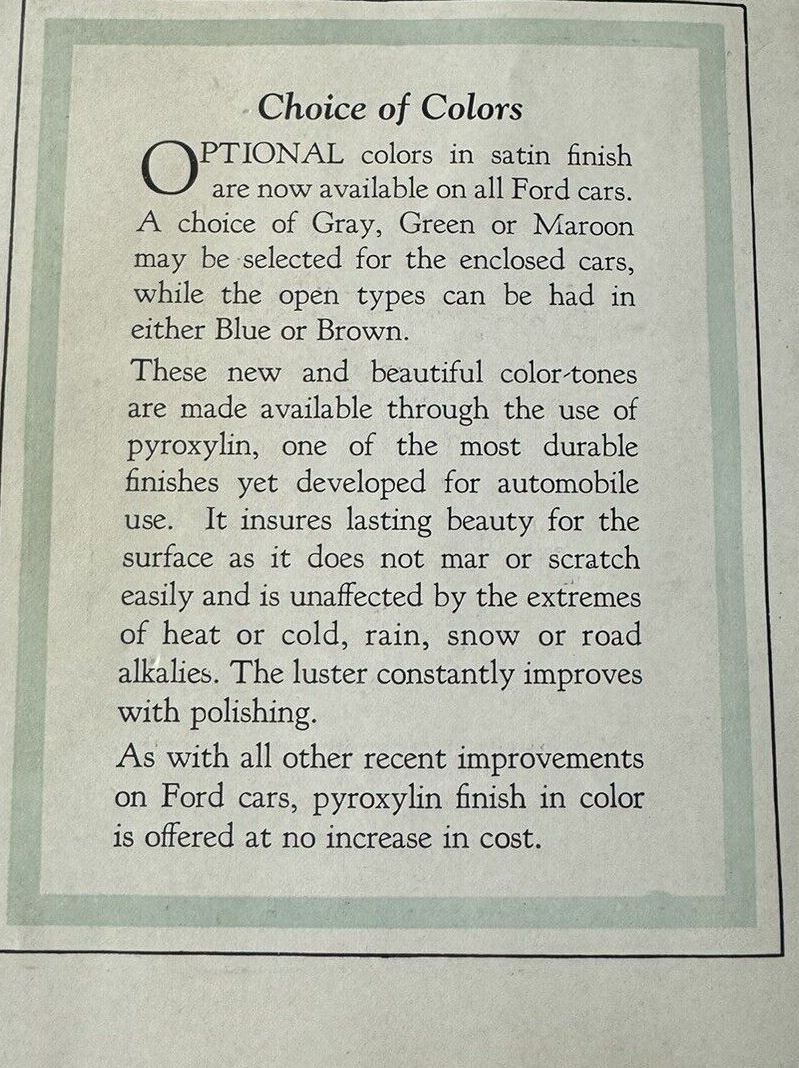

I have a 1927 Coupe that is painted Channel Green, and I came upon a very interesting 1927 Ford sales brochure that described the "new" paint colors for the Improved Ford. In the brochure, it describes the paint finish as a "SATIN" finish, which, to my knowledge, has not been described before. I'm wondering if anyone restoring a 1927 Ford has painted their car using a satin finish paint? I suppose we could debate what a satin finish would look like, but it does not say the paint finish has a gloss. I've attached a copy of the document. Russ Furstnow

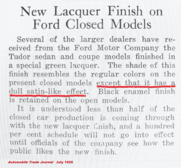

Found a few years ago this introduction date info too,

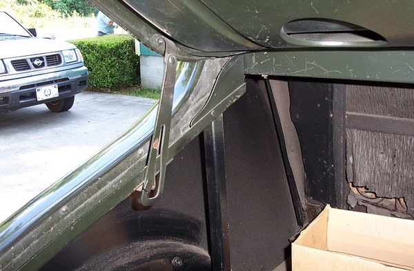

And original cars if not repainted show satin, here is the underside of trunk lid of an original '27 coupe showing that low gloss finish.
But since lacquer isn't used today, most modern auto paints do a gloss finish, perhaps a good painter could dull the top coat.

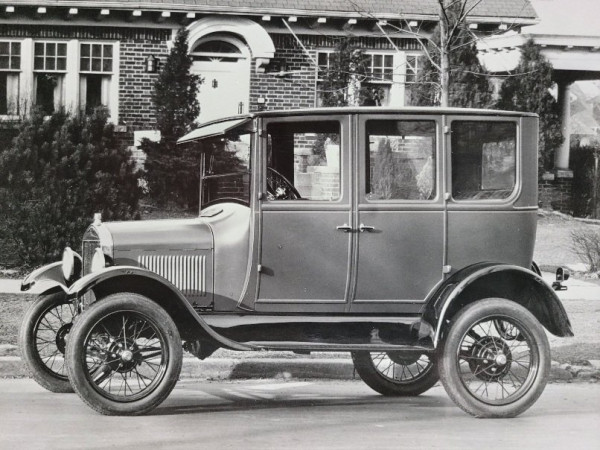

I am currently restoring a '27 Ford sedan. We came across the same page of that brochure. I also was looking at a factory promotional photo and it certainly looks quite like a satin finish to me. My inclination is to copy the finish of the car in that photo. I'm looking at the finishof the fenders compared to the body. Interesting.

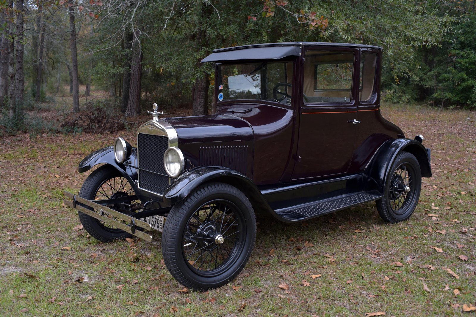

Interesting discussion on the 26-27 paints. When I restored my 1926 Coupe back in 1980 I sprayed several coats of Ditzler DL-1011 Ford Maroon acrylic lacquer. It was the first car I restored and I made some mistakes, one of which was laying on too much paint. Of course I polished it to a mirror like finish. If I ever get around to re-restoring this car (which it needs) I will keep this "satin finish" information in mind.

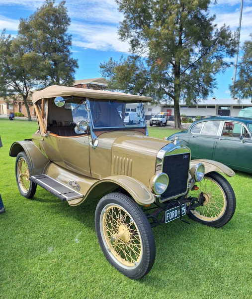

Here is my Duncan and Fraser wide body roadster, painted 9 years ago with lacquer. I did rub back and polish the flat trunk lid just to see if it was worth the effort. It was not.
