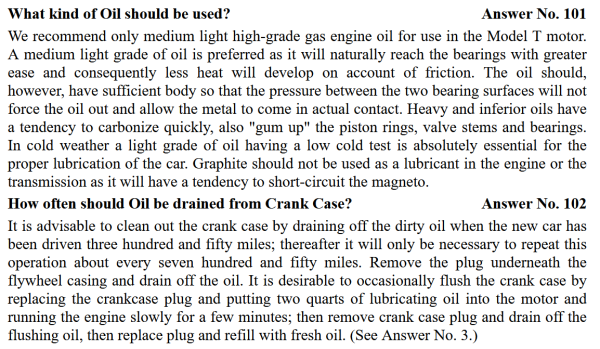

What do the old light, medium, and heavy grades of oil of 100 years ago mean today?
https://modeltfordfix.com/care-and-feed ... d/#more-31

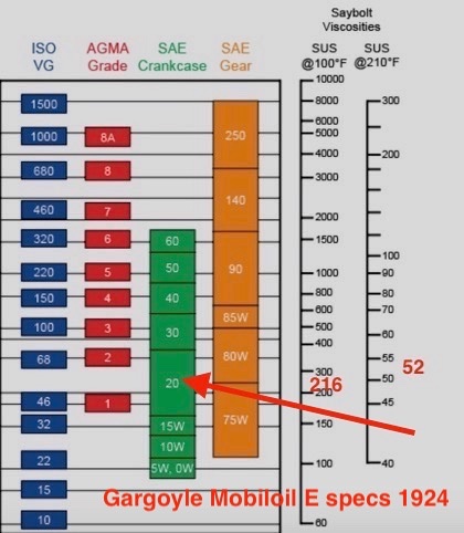

To add to the selection of oil, this modern chart lists the various SAE oil viscosity for motor and gear lubes. The crankcase oil or motor oils are in the green column.Steve Jelf wrote: ↑Tue Apr 02, 2024 9:56 amWhat do the old light, medium, and heavy grades of oil of 100 years ago mean today?
Have added the red numbers from an oil testing spec in a 1924 trade journal, to show the specs of high heat and low heat viscosity for Gargolye Mobiloil E, the preferred choice in the twenties for the Ford.
Should be the same today, a light motor oil , i.e.... SAE 20 w. Most times a 10w30w is great to use.
