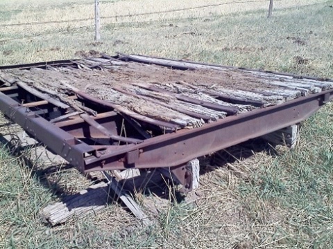

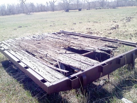

Here's a few TT beds showing the bed strips, could be 5 is correct. These are longer than the pickup bed strips of course.

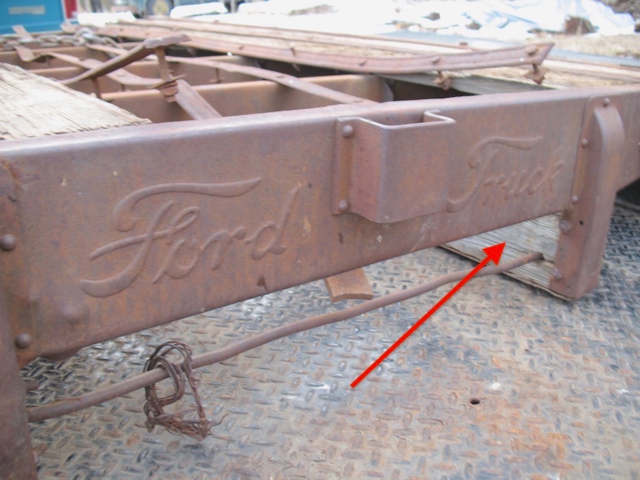

Not my truck, but is this what you are looking for?

Thank You Robert. That sure helps. Is this photo the same as your TT? I hope mine comes out as nice as the one in the photo.

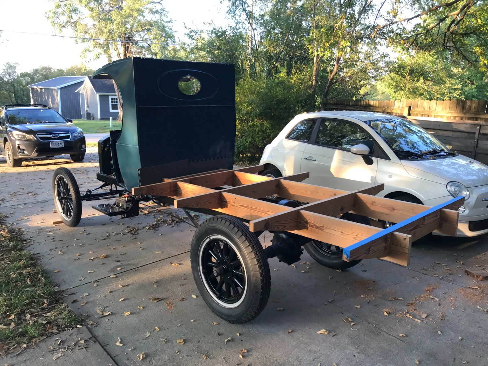

I wish that was my bed. My truck came off a farm without any bed. I am building a wooden grain/express bed for it.
