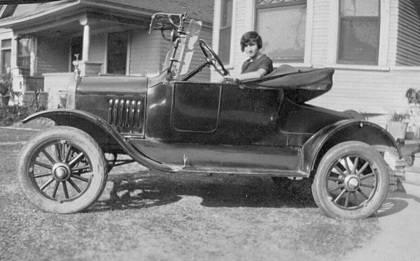

Summer 1925 before the Improved Car offering, the nickel plated brass substrate shell was offered as an option for the customer.
Factory supplied nickel shell on closed cars for '26-'27. Extra cost option on the open cars. Never chrome, always nickel plate.
Dressed up with lots plus the nickel shell.

Although the 1924-25 roadster shown above has a nickel-plated radiator shell and, possibly, nickel-plated headlight rims, they may or may not be
Ford issue.
Case in point: my unrestored '17 roadster had an aftermarket nickel-plated radiator shell and headlight rims (and a honey-comb radiator) when the second owner acquired it from the original owner in 1947 and when I acquired it from the second owner over 30 years ago.
Therefore, what is shown in the photo might be aftermarket.
