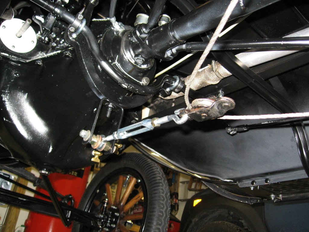

I'm using a home-built hybrid equalizer / cable setup on my period (not reproduction) AC brakes. I plan to use the same setup with my early reproduction Rocky Mountain brakes (whenever I install them).

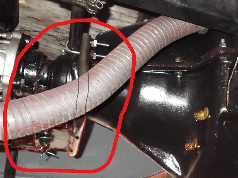

I am thinking that if X amount of force is being applied the rods will more directly apply that force. That being said, I would use ether. If I was using an original set of real Rocky Mt brakes I would use cable as they were made to use, modern I would use rods. A friend has the modern small drum AC's on his car, he did set them up with cables and have been working fine. I have big drum repo AC/Rockies on my 21 that I made my own equalizer and run rods, they work fine. This is a bad photo but is the only one I have right now. While it hangs off the parking brake cross shaft it goes under it and is independent of the shaft.

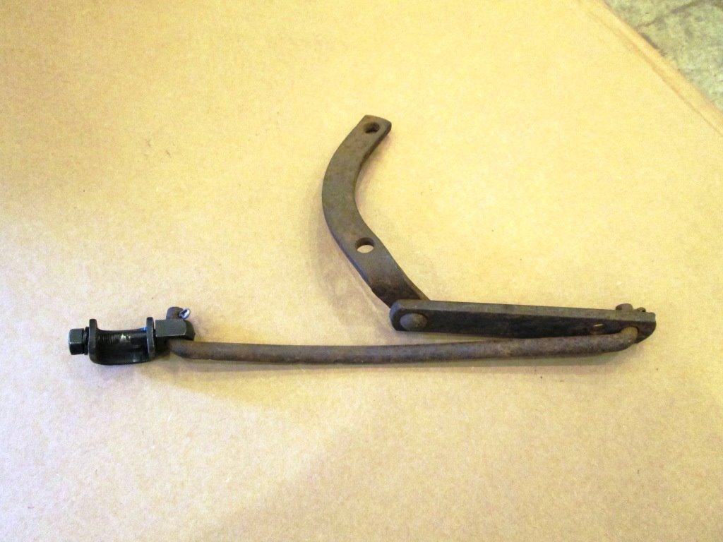

I'll get a photo of my original R.M pedal linkage later today & post it.
- Posts: 5511

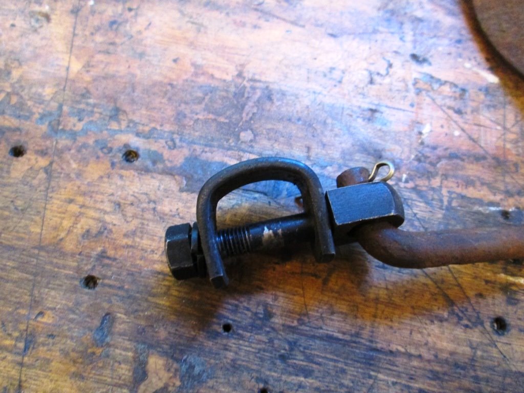

Re: Rocky mountain brakes, has anyone used cable instead of rods?
Here's what an original R.M. brake pedal clamp & linkage looks like.
- Posts: 2838
- First Name: Dallas
- Last Name: Landers
- Location: N.E. Indiana
Thank you Steve. I think even I could make that.
