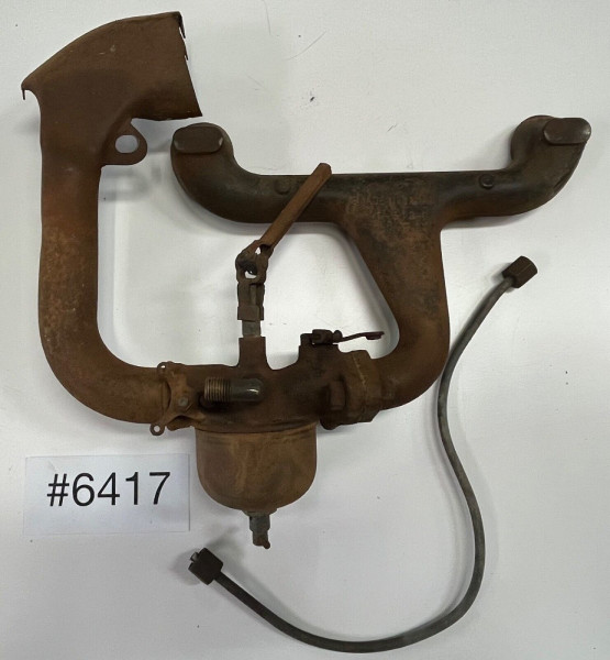

Did you reinstall your Hot Air Pipe for the carburetor? one of previous post showing your new head, the pipe is not present and you might be experiencing icing up in the carburetor.

That popping is an indicator of a lean miss. Try putting the carb stove pipe back on.
Did you check the intake manifold for ice @ the 90 degree bend?

Hogs Head.
Even if you have to wire the heat pipe on, its use will help in your problem diagnostics.

They're called a hot air pipe & if you have the stock combination choke/mixture rod, you'll need the correct one with the indent for the rod to clear.
Got it, thanks. Yeah I was gonna order a repop but Lang's seems to only have the '25 and back one but I need a '26-27

Michael: You've probably checked EBay, here's one listed as fitting thru '27, that appears similar to the Lang's photo but a little spendy in my opinion. Lang's do have many used parts that aren't in the catalog, I suggest a call to see if they might have something that would work.
https://www.ebay.com/sch/i.html?_from=R ... sacat=6000
I have nothing to do with that product or seller.
My '26 coup had standard NH carb and an aftermarket cast aluminum hot air stove, which is irrelevant to your search, but I mention b/c there might be some used aftermarket ones that would suit your needs. Best, jb

Here's what hot air pipe you'll need - notice the flattened are and the manifold clamp connection. I'll check my stash.
Yeah, that's definitely the one I need, looks like like the one I had except not cracked in like 4 places!
