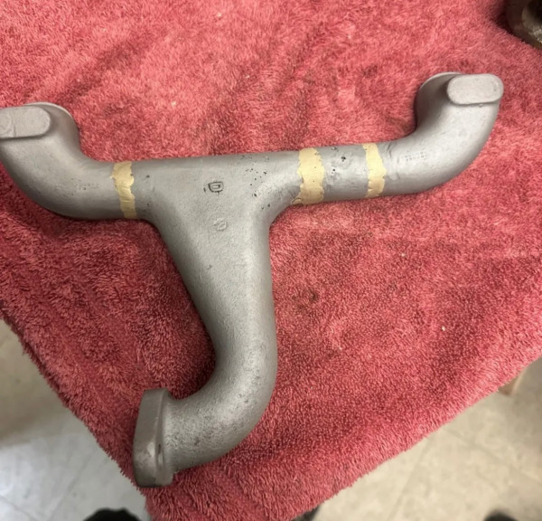

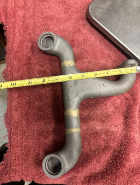

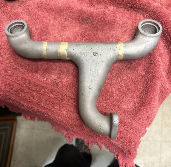

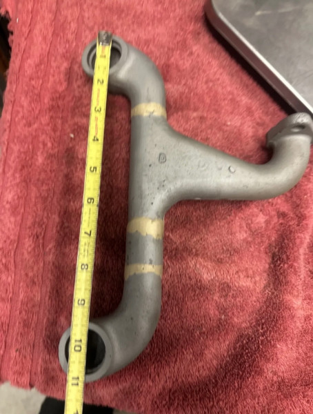

Surfing the web looking for an aluminum intake and chanced upon this. Measurements are good. So why?

Post by Wayne Sheldon » Sat Apr 06, 2024 9:10 pm
To put in a larger generator, or one with maybe an oil pump behind it.
Posts: 4414
Re: Why the need to change?
Post by Wayne Sheldon » Sat Apr 06, 2024 9:23 pm
It would really mess up the "Y" flow pattern. The number 3 and 4 cylinders would run stronger and richer than cylinders 1 and 2. If someone wanted to do this for some reason, it would work a bit better if the triangle "Y" was turned end for end to compensate somewhat for the change in flow distance.
Posts: 4414
Post by Wayne Sheldon » Sat Apr 06, 2024 9:24 pm
That of course would require turning the bottom piece around.
Posts: 4502
Post by Jerry VanOoteghem » Sat Apr 06, 2024 11:07 pm
Some folks feel that 1 & 2 tend to run richer than 3 & 4. Maybe this was an attempt to "correct" that?
Posts: 4414
Post by Wayne Sheldon » Sun Apr 07, 2024 12:06 am
Jerry V, Interesting idea!

why take a chance. call Langs or Snyders

On the other hand, I would guess that it was to provide more clearance for an oddball magneto adapted to a Bosch front plate unit or similar. The DU4 already is pretty close to the manifold, other larger magnetos would probably touch. But definitely for something being driven on the side of the engine that was touching stock manifold.

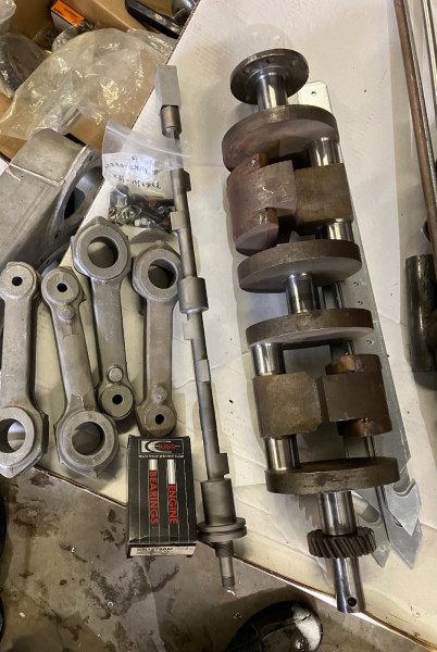

Post by Les Schubert » Mon Apr 08, 2024 10:27 am

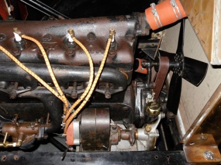

My 2 up 2 down crank (and cam and rods). If you look at the counter weights vibration is not likely to be a problem!
Les Schubert
Posts: 1364
First Name: Les
Last Name: Schubert
Location: Calgary
Post by Les Schubert » Mon Apr 08, 2024 10:35 am
Another solution to the limitations of the T firing order. I have had great success with!
Post by Les Schubert » Mon Apr 08, 2024 5:49 pm
Craig
I’ve thought about doing that by chain driving the camshaft

Last Name: Woods
Post by ModelTWoods » Mon Apr 08, 2024 6:35 pm
Another thought: Was/Is this manifold advertised to be an aluminum intake manifold (if that is what you are seeking)? It looks like whomever modified it cut it and reassembled it using brass to braze the pieces together. You don't braze aluminum. You can braze cast iron, and sandblasted cast iron can give the appearance of aluminum. I saw this on EBAY when it was first offered and thought the same thing as others; someone modified this manifold to move the carburetor further back. i didn't think about it upsetting the flow characteristics, but I'm sure that's true.
Post by Craig Leach » Mon Apr 08, 2024 10:39 pm
Hi Les,
That's a good idea but wouldn't the sprockets have to be rather small so the chain would clear the casting hump? I seen some of Kurt Wrights
antics making a 6 cylinder model T engine. Could you reform a cam to fire 1-3-2-4 or 1-4-2-3? leaving the ports the same. Or even cut it & turn
the cam around so it turned backwards? Then swap the ports? Then add Multi-Lifts. Just food for thought.

If you don’t run the generator, then it shouldn’t be a problem. I have too many other projects so I won’t be doing it.
