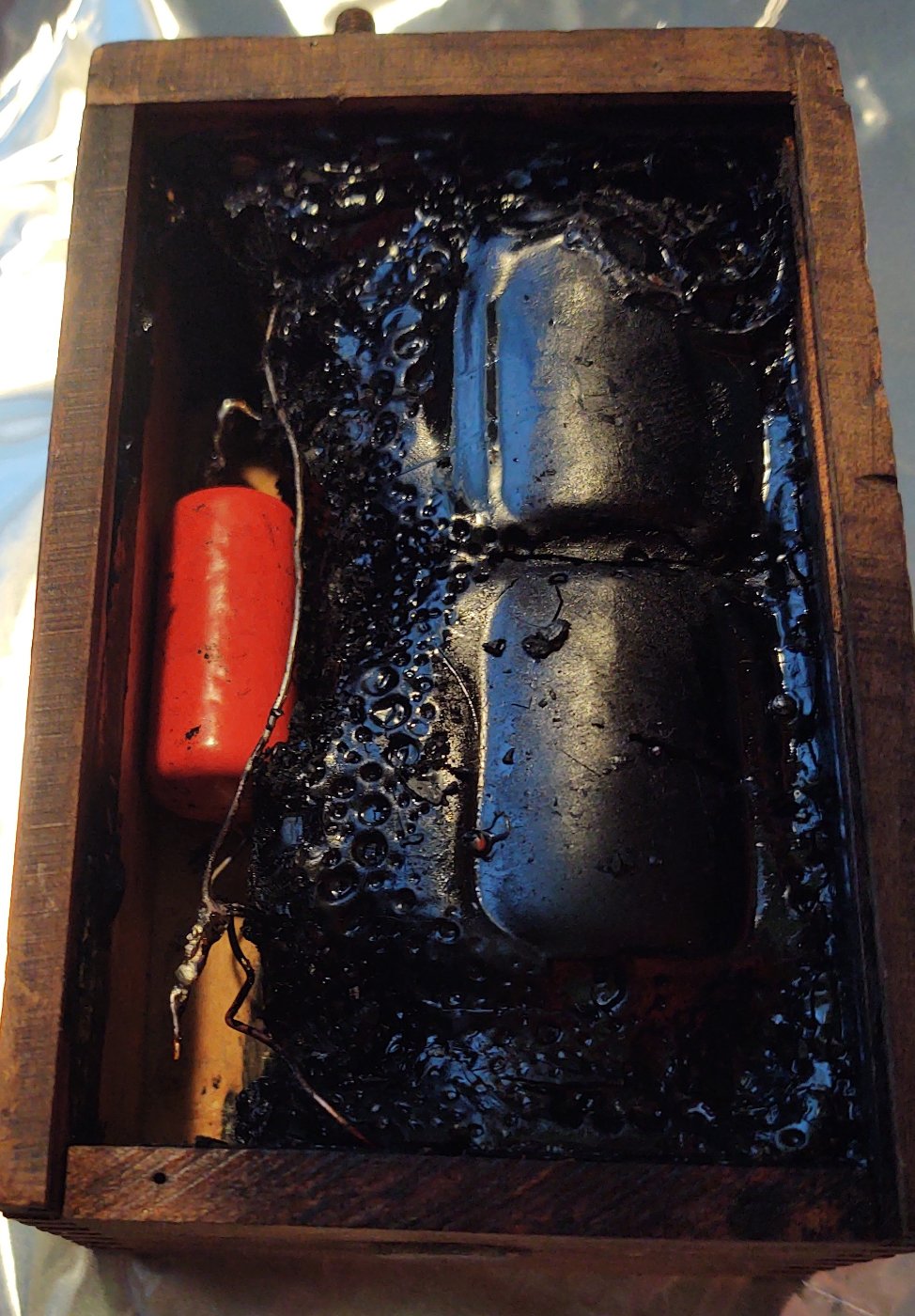

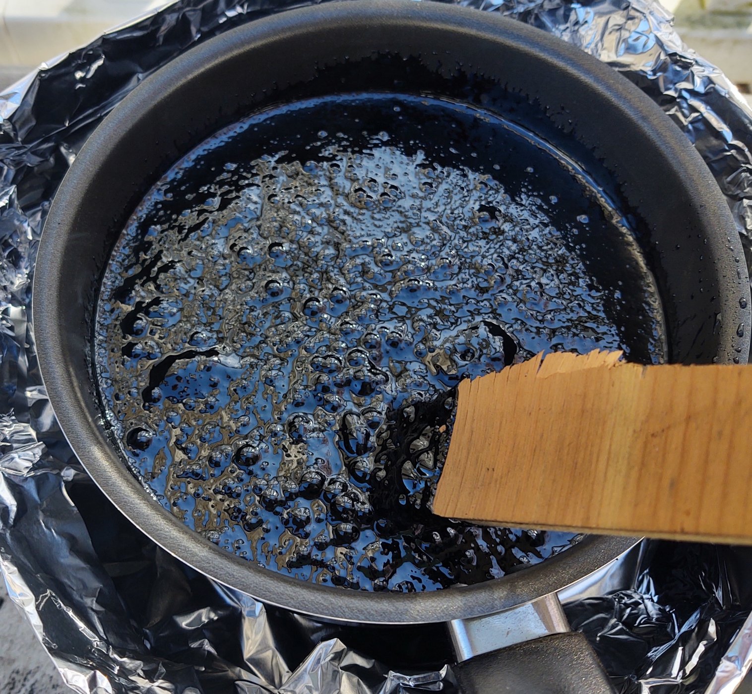

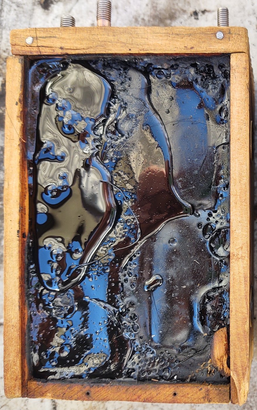

If you haven’t started yet and just need it for a capacitor replacement here’s what I’ve done about a dozen times: first carefully pry off the narrow side of the case opposite the brass buttons. A putty knife between the tar and the wood does wonders. Once off tar picking is easy. I leave the glass insulator in place as the caps I’ve used left enough room. Reclaim every piece of tar you chip out. Work on a large cardboard or plastic but save it all. Solder in the cap and use wood spacers to take up most of the open space. The collected tar goes into a small tin can with a spout bent into the top. A vice grip makes a good handle. OUTSIDE use a propane torch to melt the tar. It will go liquid quickly and smoke like hell. Of course the coils must be lined up and ready to receive the tar. I’ve never needed to buy any tar and don’t do enough coils to need a chunk of it hanging around.

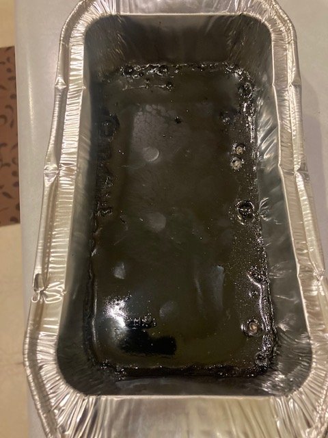

I got carried away removing the tar from a Atwater-Kent coil and ruined the wood but I have the tar & some of the parts. there is
1# 11oz of tarThat I will be happy to part with. I have no idea what the going price of coil tar is? Craig.

I add wood spacer blocks so less tar is needed.

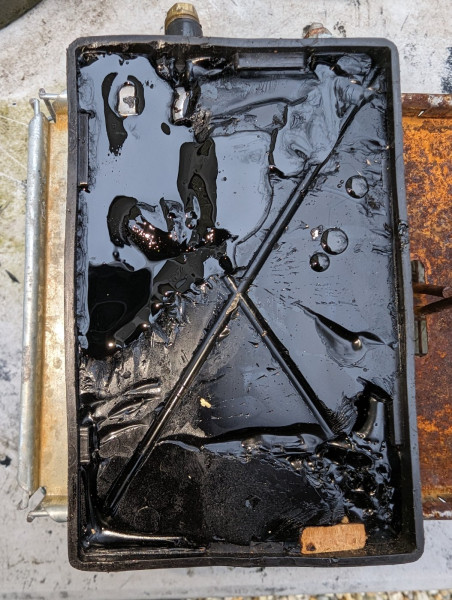

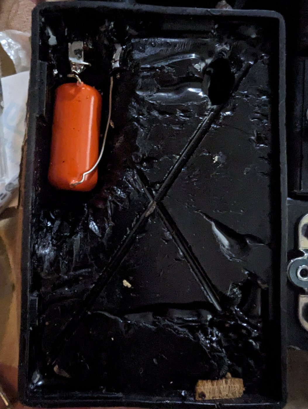

Later made Plastic case coils... Capacitor, replacement and potting

Tar does burn good when warmed up.
Tar can also explode when it is warmed too fast.

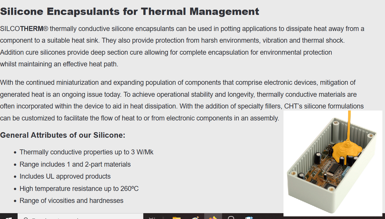

A solar flare hit me & was wondering if silicone casting material would be a good choice for filling a coil unit. Its non-conductive and would be easy to remove later if needed be. It could be applied in two sessions like making a mold, to make it even easier to remove. Tar was about the only solution back then as an insulator.
Maybe ?
Maybe ?

I think the main question is how would the silicone or the aerosol filler adhere with the tar that's in the coil to make one solid unit.

Not sure how good foam filler would resist vibrations. It might turn to dust where it attaches to wires.

Why do they, or other options, need to adhere to any residual tar that's in the unit? The purpose of the tar is just to prevent things from moving around. Its just a filler that is non conductive as the other options. I'm saying fill the box.
The foam expands and would prevent wires etc from moving

After replacing the condenser, soldering the connections, repotting with Hot tar will assure the adhesion to the tar in the rest of the coil unit and this way from Rocky road, vibrations and engine vibrations will eliminate wire breakage inside the coil

I wouldn't use the expanding foam because it will be a b×#@&* to remove later if you or the next guy need to ever work on that coil again.
