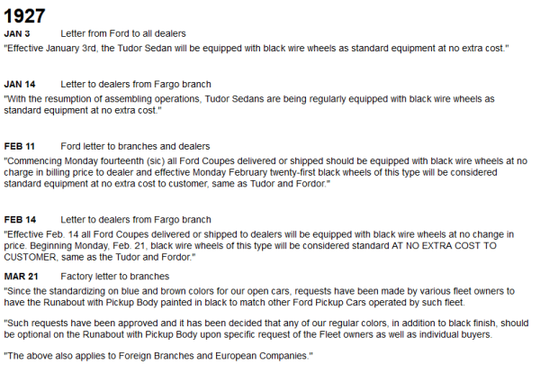

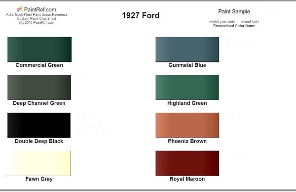

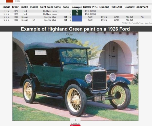

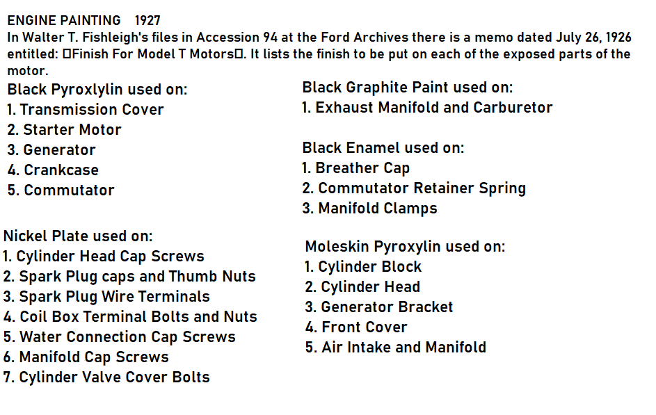

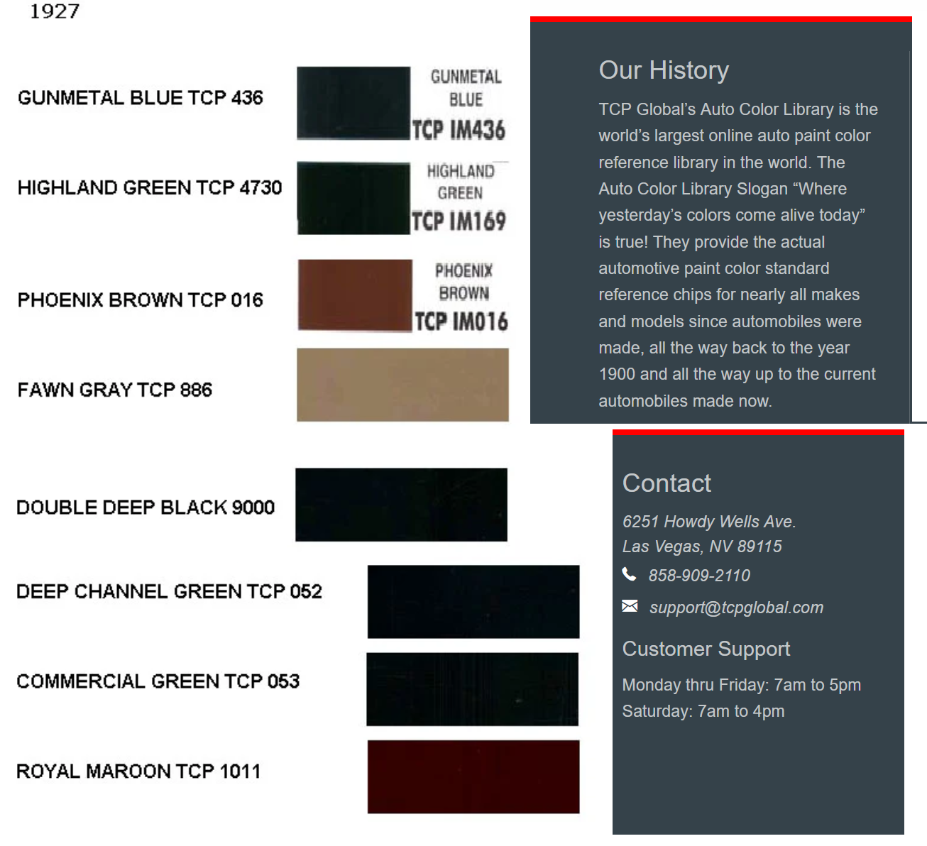

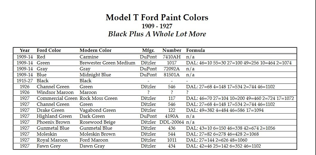

From the Forum's Encyclopedia
Other sources

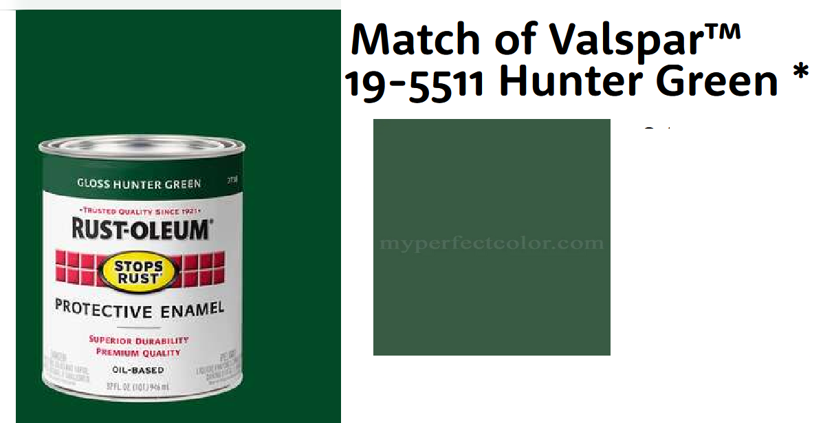

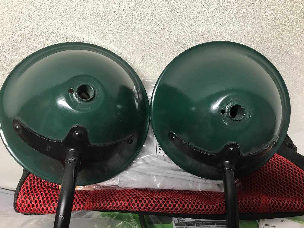

Post by TRDxB2 » Mon Apr 08, 2024 1:53 am
I used Valspar Hunter Green of these buckets. Had some Rustoleum Hunter Green in a spray can that was a shade darker than the Valspar
Cameras & individual computer screens render colors slightly different. But the Headlights displayed on my computer screen match to the real ones

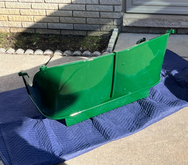

Post by M.Sinclair » Mon Apr 08, 2024 8:28 am
I know someone was talking about rustoleum hunter green I went to the paint store and had a batch of ppg paint made up to match it for the painter to spray on the body, I did the frame in oil based brushed rustoleum hunter green. Here’s how it came out, it does look maybe a touch light compared to what the later green cars seem to normally be.

modeltspaz
Posts: 281
Last Name: Spaziano
Location: Bellflower, California
Re: Highland Green?
Post by modeltspaz » Mon Apr 08, 2024 3:23 pm
You have permission to use the image of my 1926 Touring above. No extra charge. :lol:
That photo was taken back in 2000 when I first bought the car. It was photographed in the driveway of a 1920s Spanish Revival style house near where I live in the city of Downey.
I've since put a different pair of YOM license plates on it. I've seen that photo used many times.

A paint source (colors don't always show correctly on computer screens)
https://www.autocolorlibrary.com/pages/1927-Ford.html
https://youtu.be/Qqnp-JBko0Y

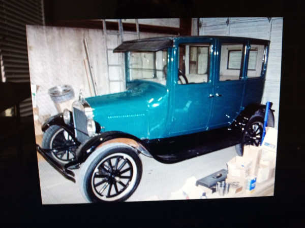

ModelTWoods
Posts: 1582
First Name: Terry
Last Name: Woods
Re: Highland Green?
Post by ModelTWoods » Mon Apr 08, 2024 11:58 pm
