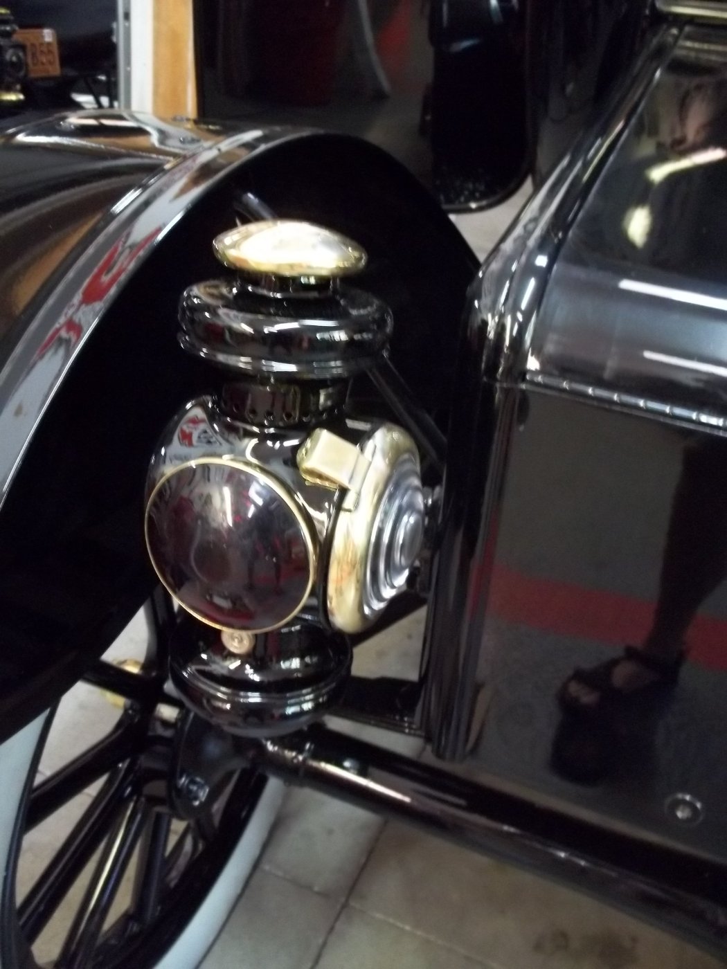

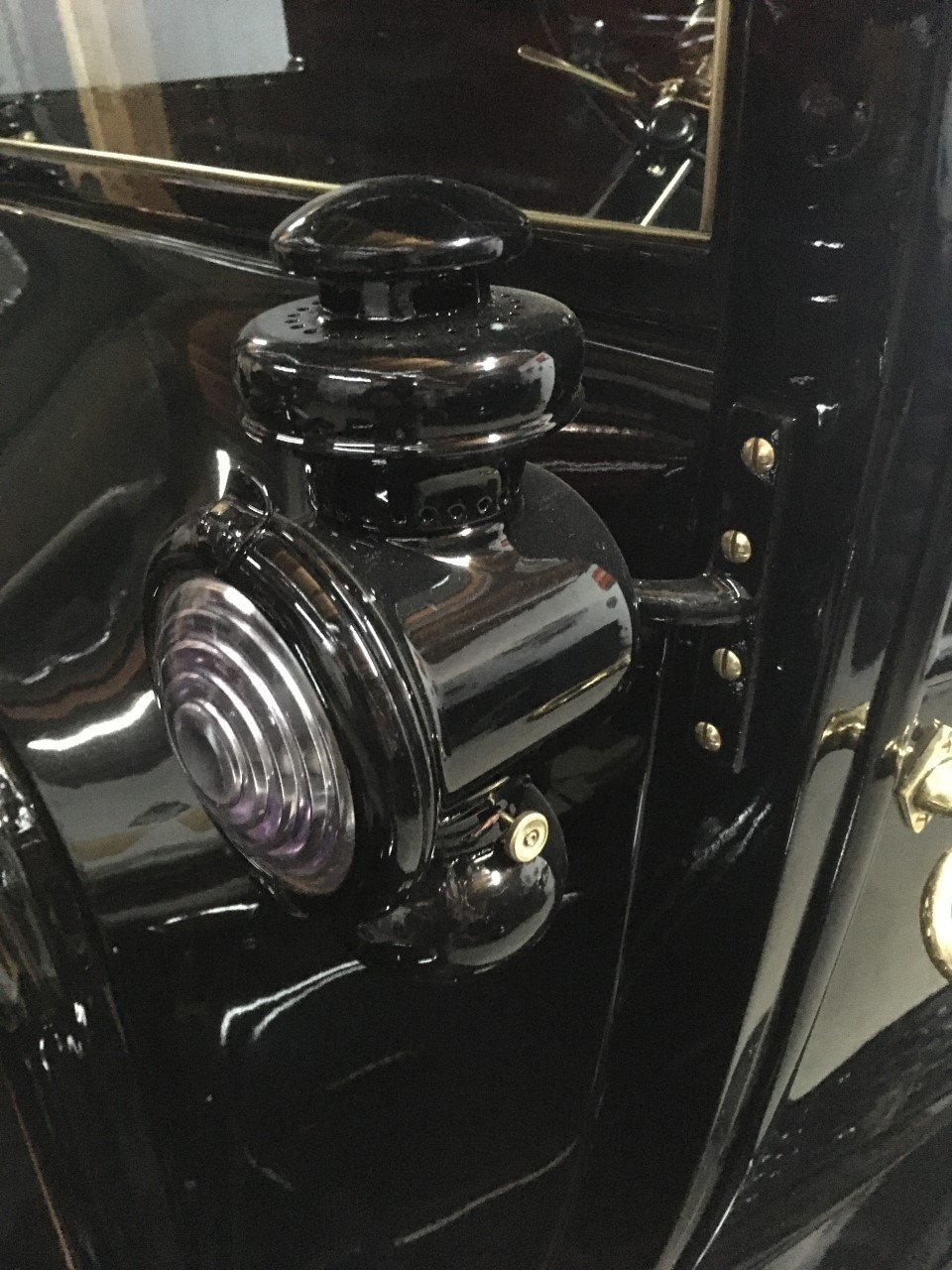

Post by ModelTSpeedster » Tue Apr 09, 2024 7:13 am

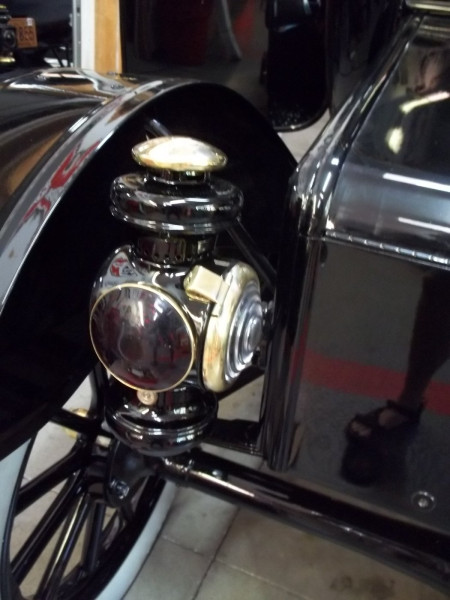

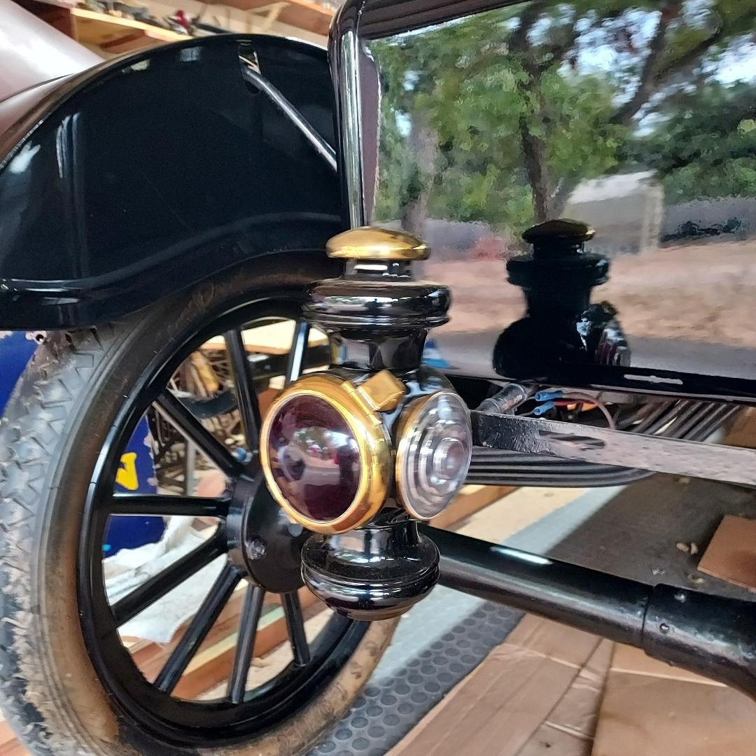

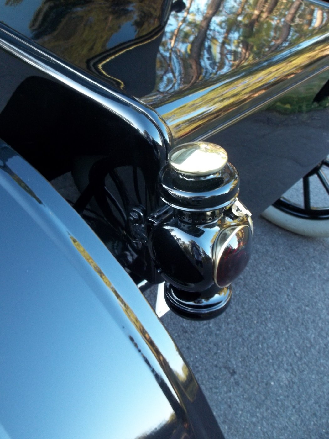

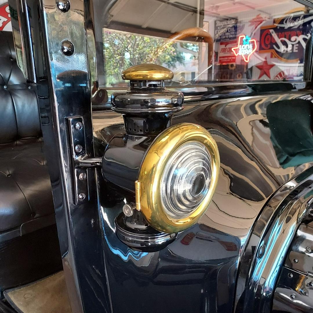

The side lamp bracket looks like this. The picture of the tail lamp bracket is not as clear.

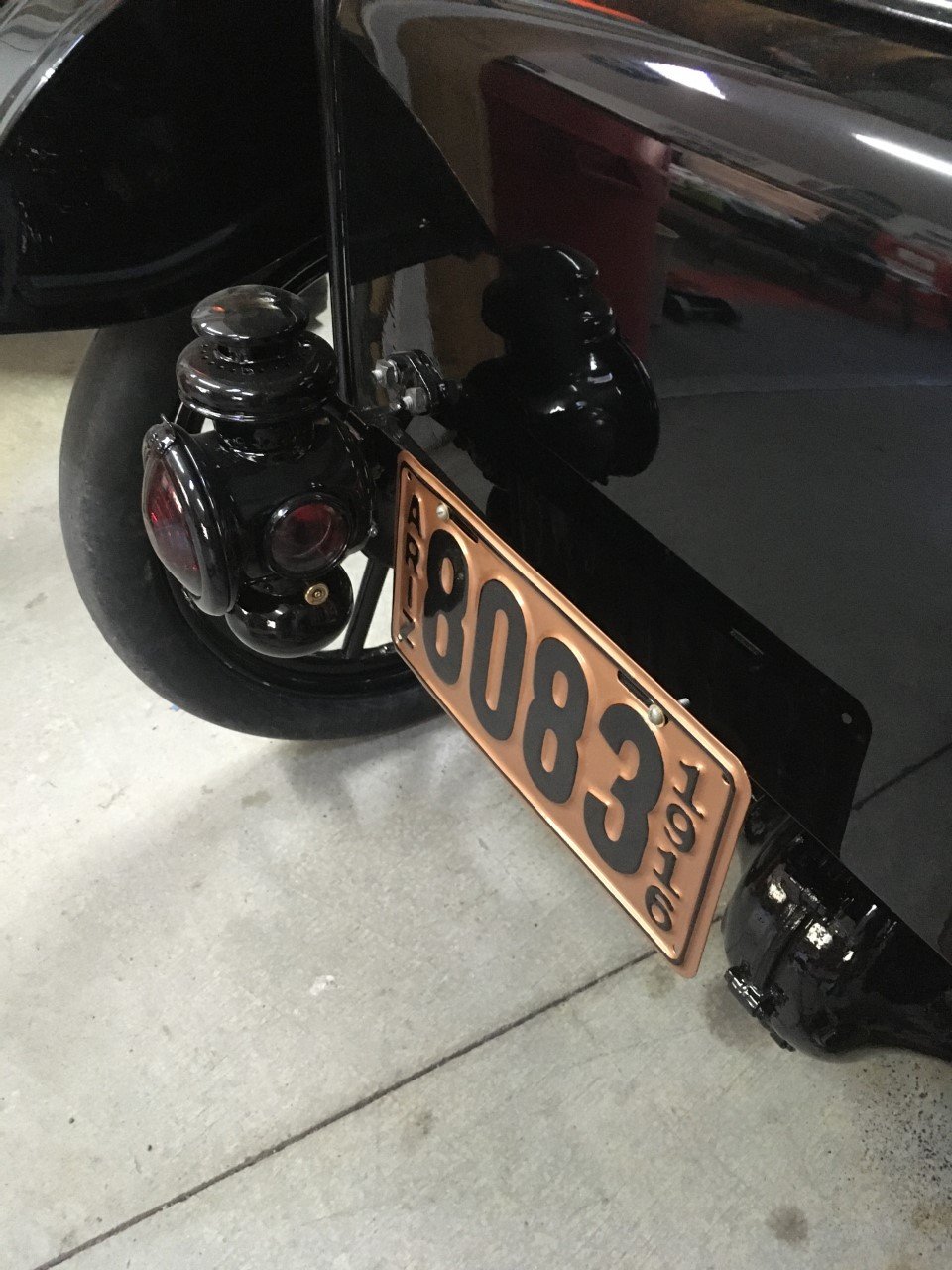

Re: Coupelet Lamp Brackets?

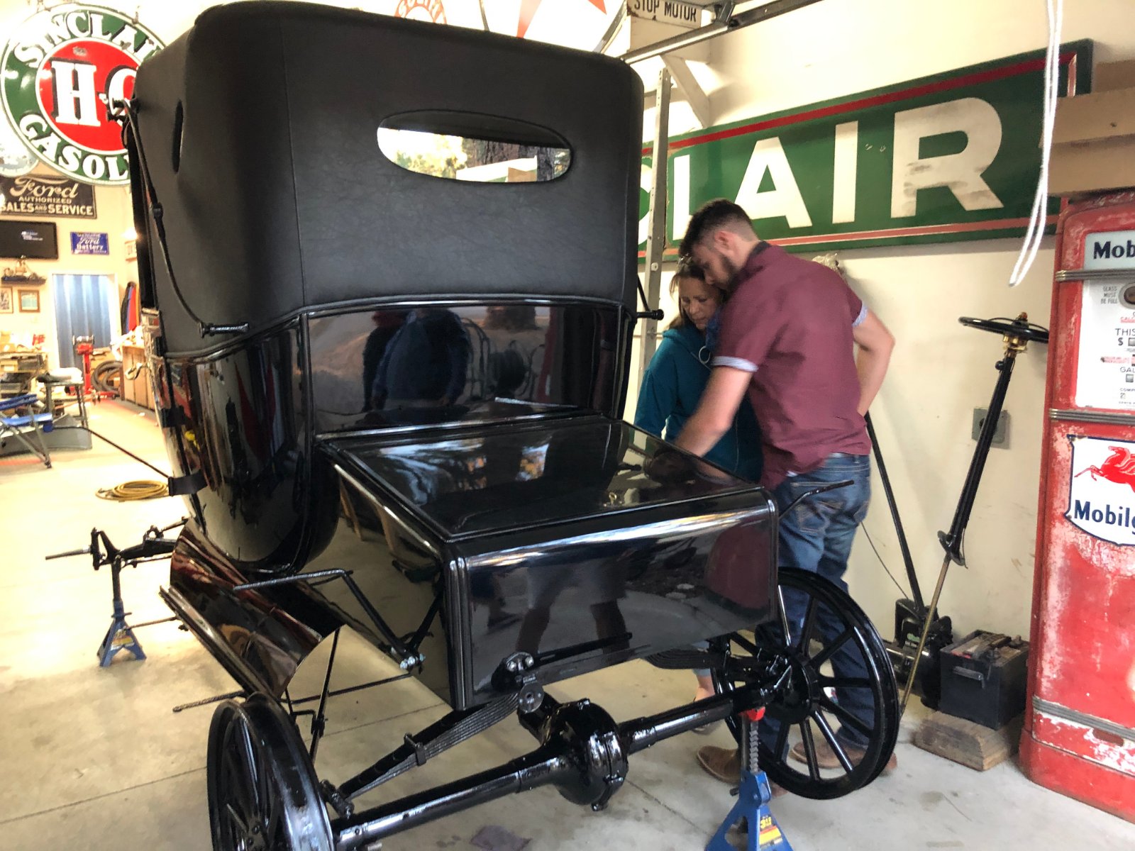

Post by Russ_Furstnow » Tue Apr 09, 2024 9:39 am

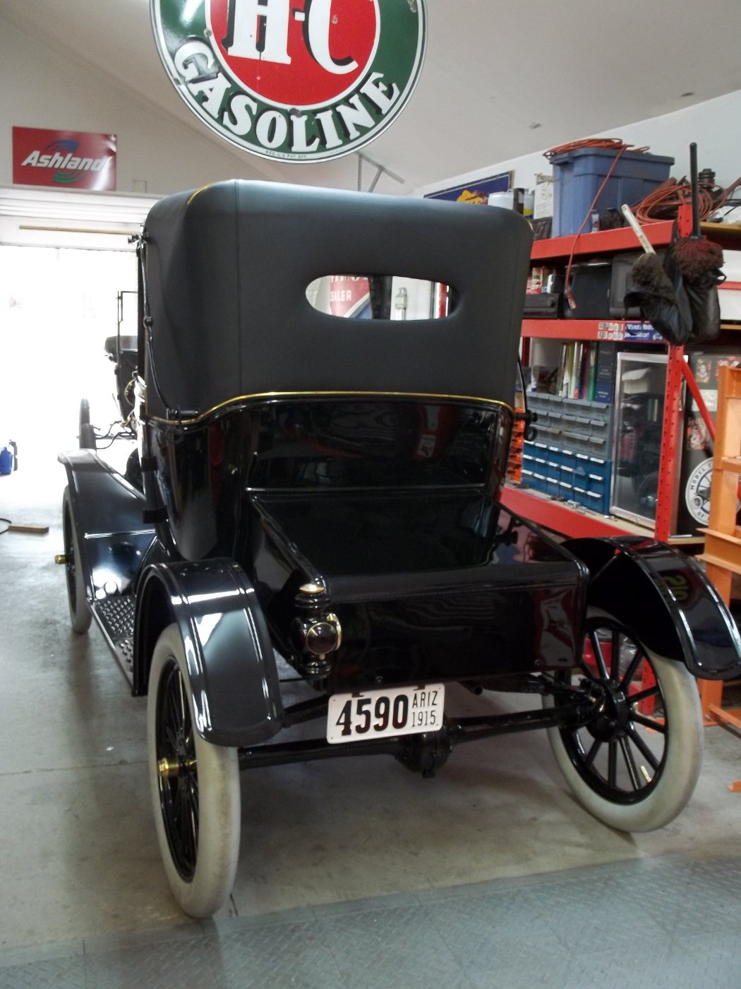

Here are a few pictures of my 1916 Coupelet. The early 1916 taillamp bracket is a two piece bracket where the license plate bracket bolts to the tailamp bracket with a castle nut. Later in production the license plate bracket was held to the taillamp bracket by stamping the bracket where it looks like a rivet. In 1916, the taillamp/license bracket is the same as used on the runabout. The sidelamp brackets are unique to the coupelet. Four screws hold the bracket to the "A" piller. The black steel lamps shown are correct for a 1916 coupelet. I hope this helps. Russ Furstnow

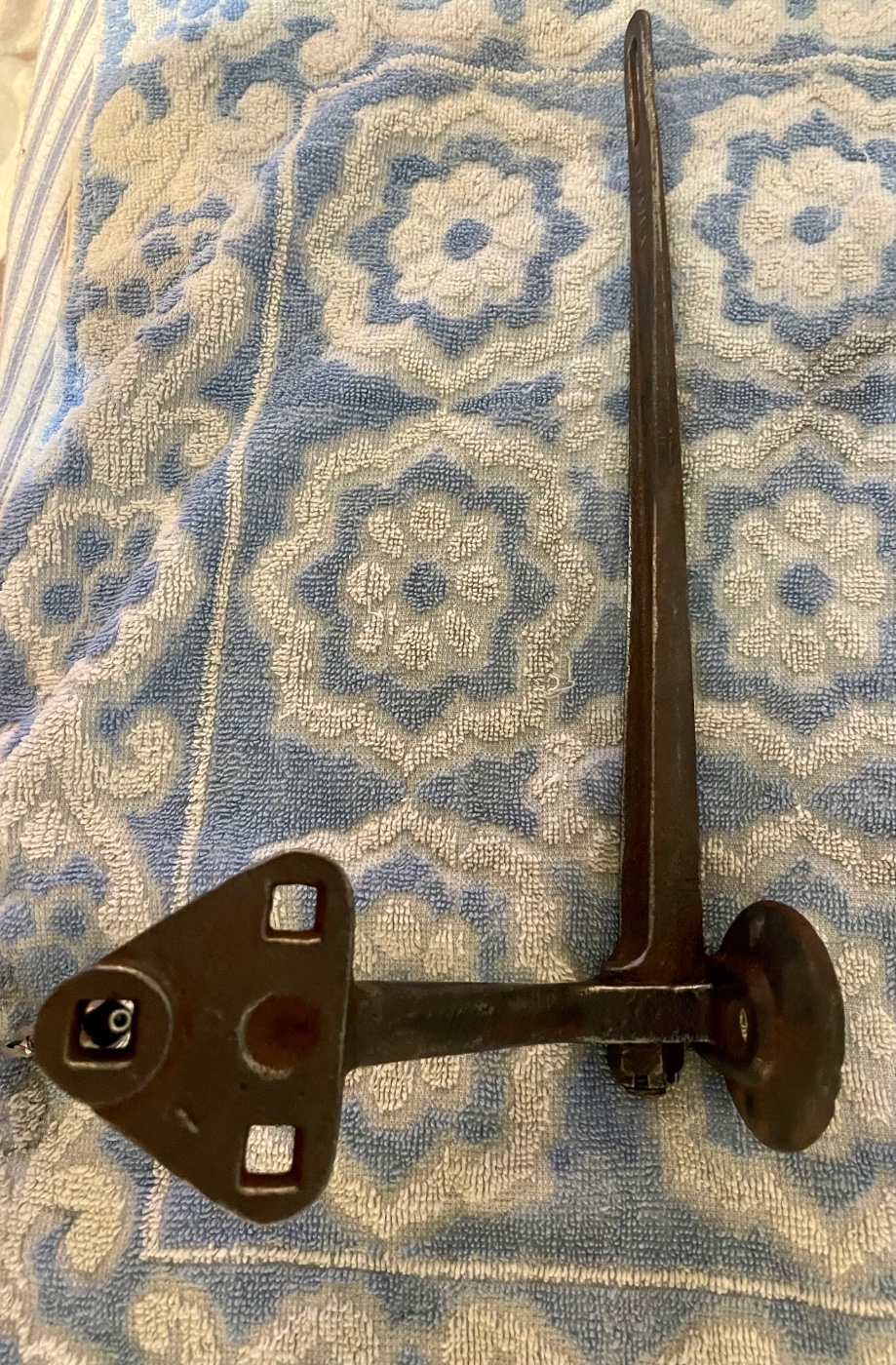

Here are some photos of the 1916-1917 tail lamp bracket for a coupelet or a runabout. I hope this helps, Russ Furstnow

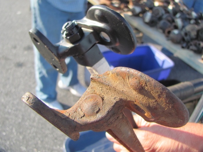

Post by DanTreace » Wed Apr 10, 2024 3:51 pm
Russ_Furstnow wrote:
Wed Apr 10, 2024 3:41 pm

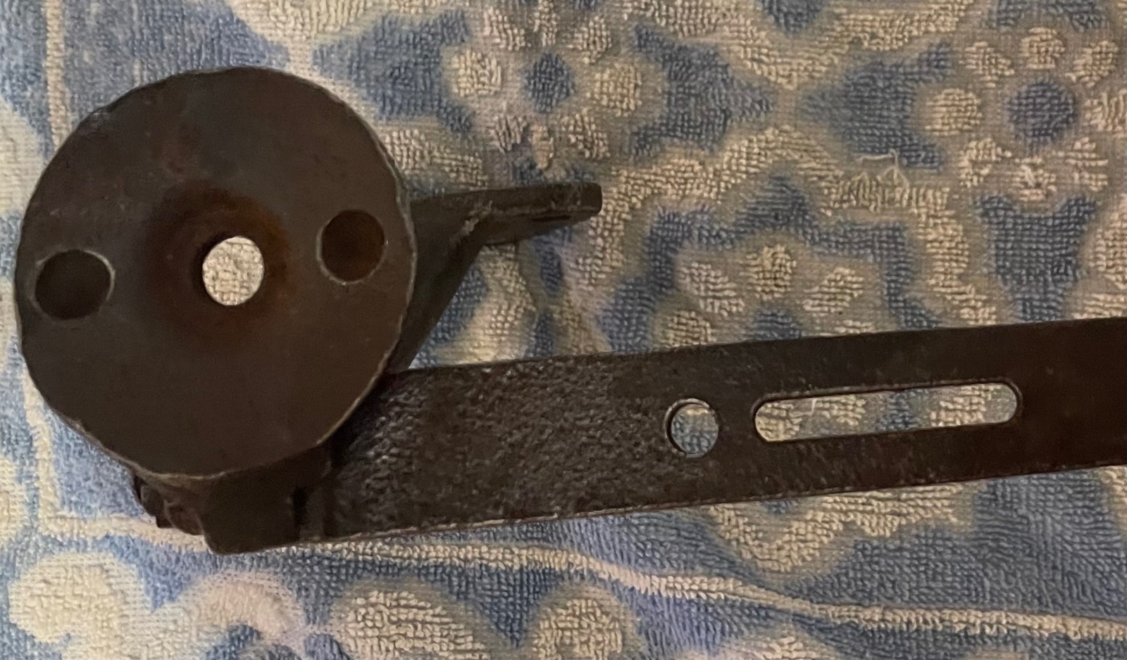

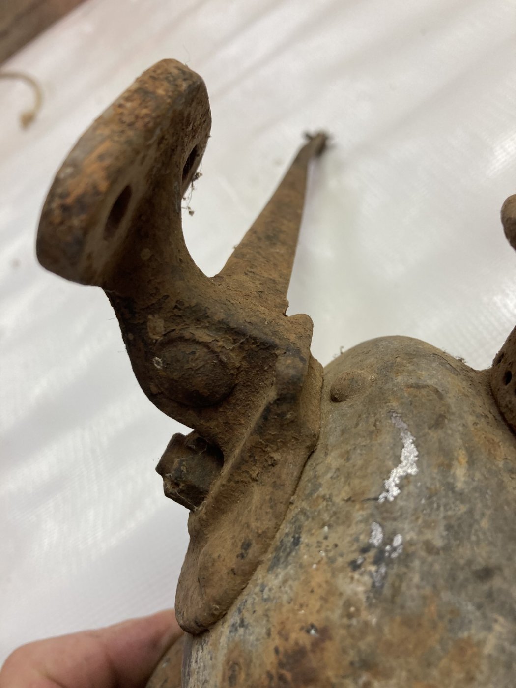

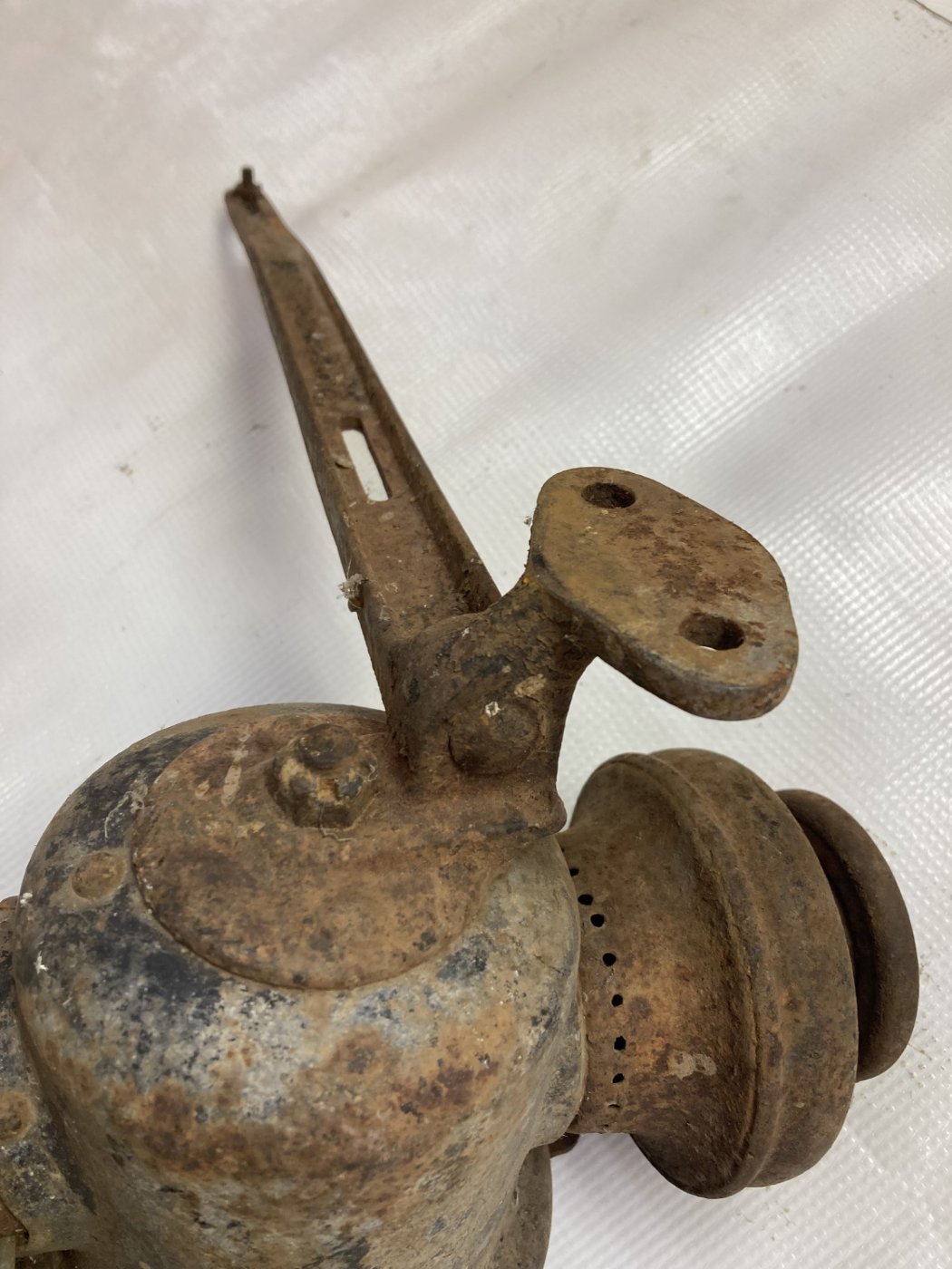

Nice photos Russ, and here is the earlier version, in lieu of the rivet stub end, the license plate arm is held with castle nut.
IMG_4635 (733x860) (452x530).jpg (132.36 KiB) Viewed 3234 times
Hershey price a few years ago indicates that is a rare bird today.

The 1915 Coupelet had a unique bracket that placed the tail lamp between the fender and the body, allowing the rear trunk door to open. The bracket that John identified is for a 1915 Touring. The 1915 Coupelet bracket has no provision to mount a license plate, and many people just screwed the license to the trunk door. I used leather straps screwed to the wood body frame to mount my license. hope this helps. Russ Furstnow

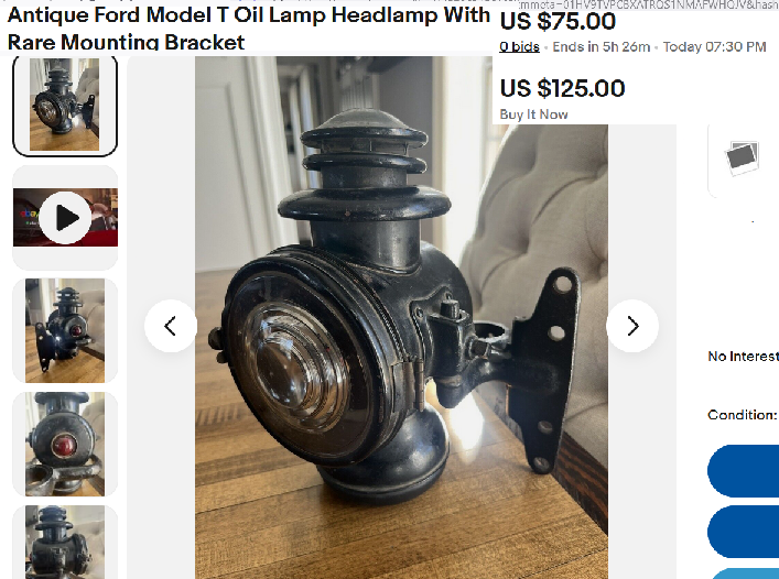

Post by TRDxB2 » Fri Apr 12, 2024 2:50 pm
Stephen1915 wrote:
Mon Apr 08, 2024 12:11 pm
Wondering what the correct tail lamp bracket should be for a late 1915 to early 1916 Model T Coupelet. I have heard it is just a runabout bracket, and I’ve also heard that it is a special bracket that mounts underneath the body. If anyone knows and has pictures, it would be very helpful. Also looking for information on the side lamp brackets. Need all 3 of these for my car.
Thanks!
-Stephen

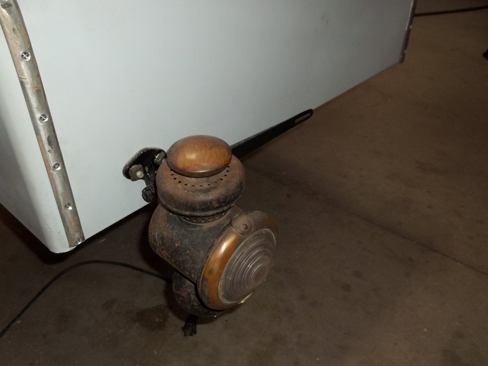

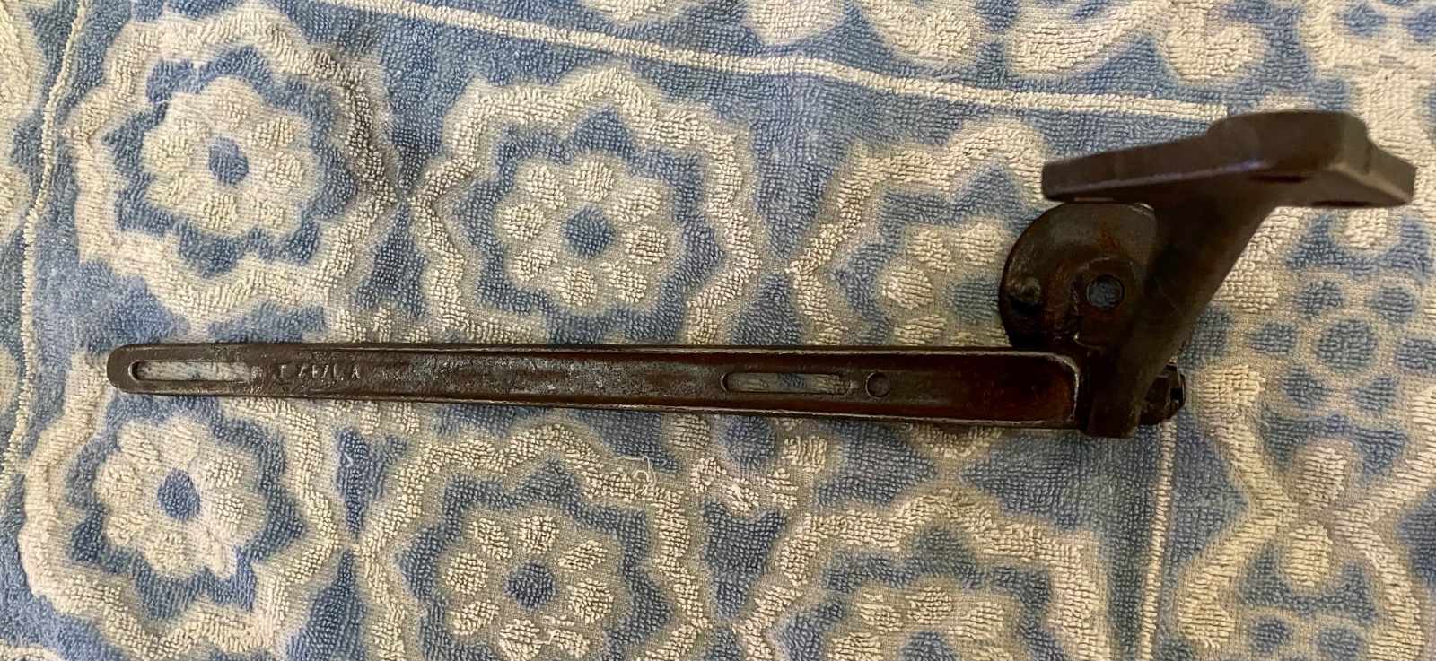

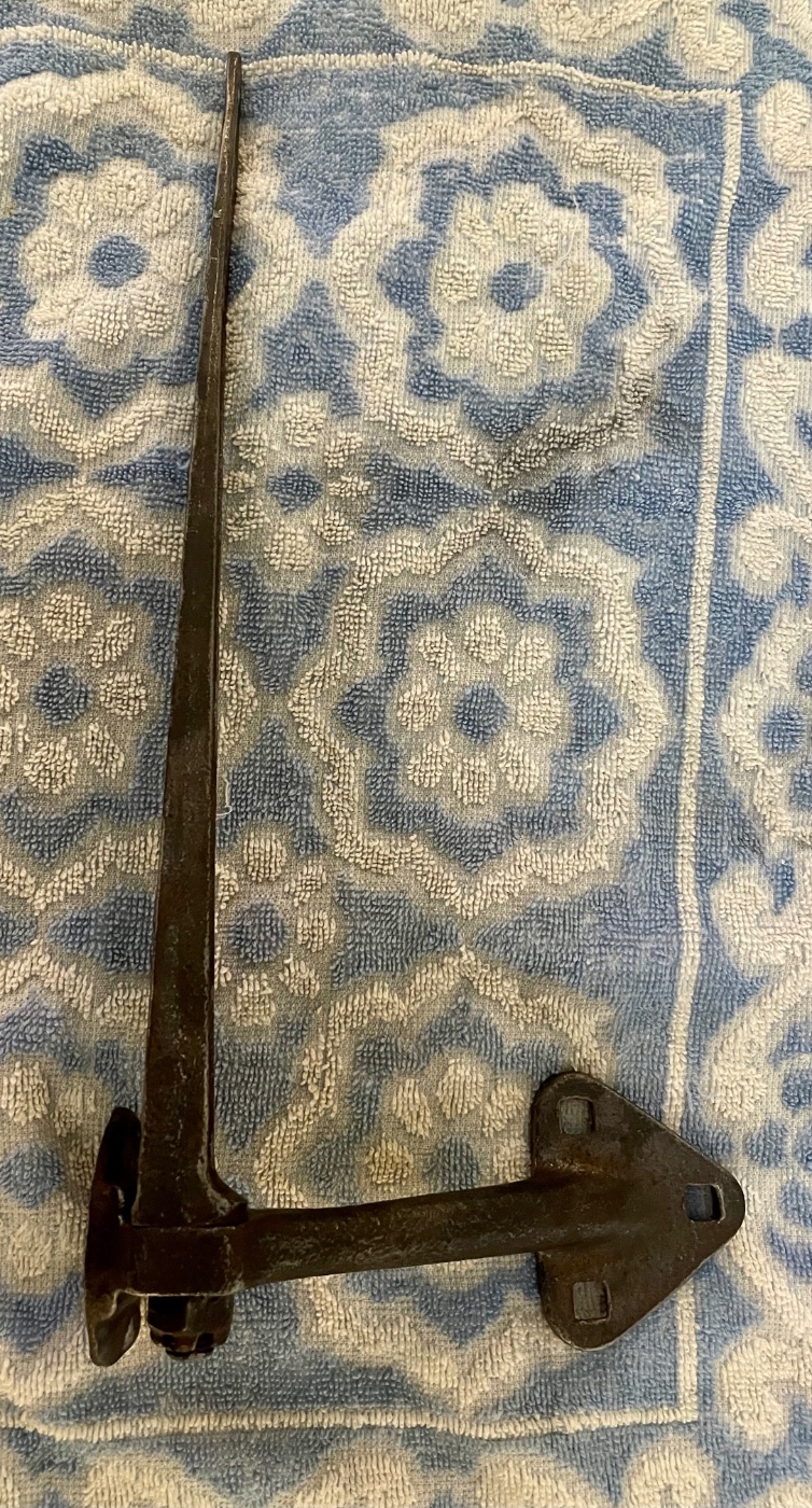

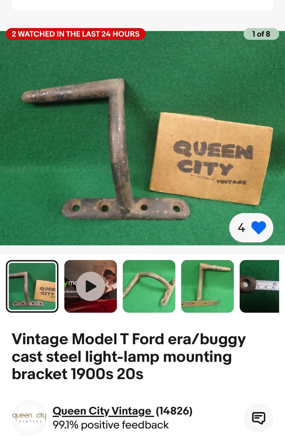

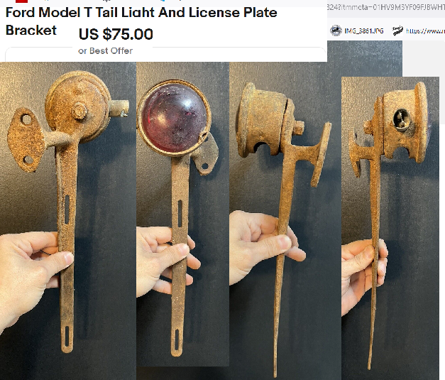

Not exactly sure if this is correct but looks close https://www.ebay.com/itm/315288694824?i ... R_iy7rTaYw
https://www.ebay.com/itm/145706215610?i ... ition=3000

Post by Russ_Furstnow » Fri Apr 12, 2024 5:54 pm
Frank, Neither are correct. The tail lamp bracket is later and the side lamp is not for a Ford. I hope this helps. Russ Furstnow

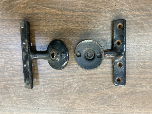

One last try. Anyone have a set of side lamp brackets they would sell, I don’t expect them to be cheap. Or if someone has one I could “rent” to have a set casted for my own.
The 4 screw style I am looking for was used from 1914-1918

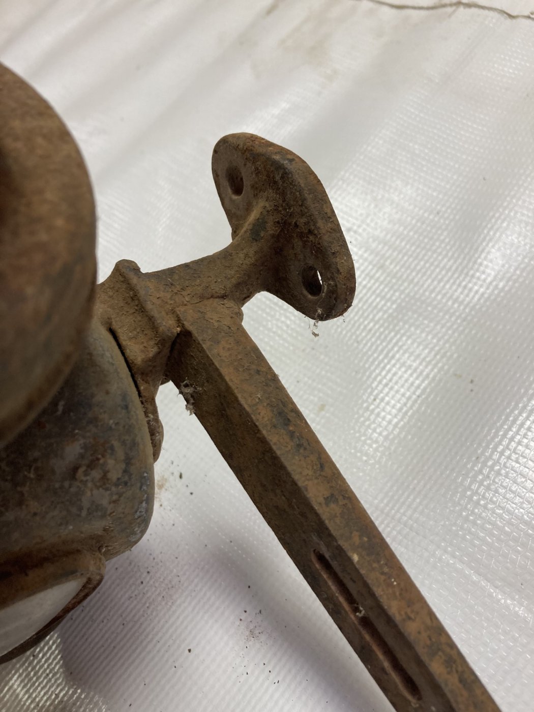

Do you have a picture of one without the lamp on it?

Post by Russ_Furstnow » Sun Apr 14, 2024 7:22 pm
Here are the brackets without sidelamps. Russ Furstnow
