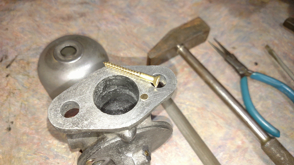

I had brass screws on a shelf that worked.
