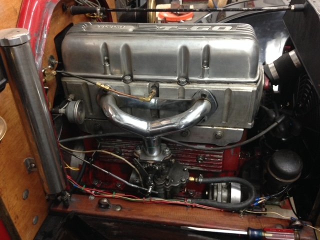

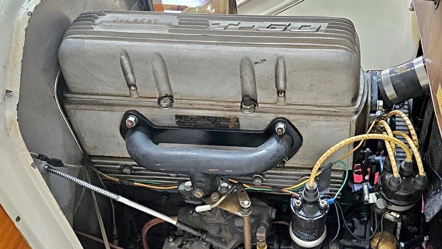

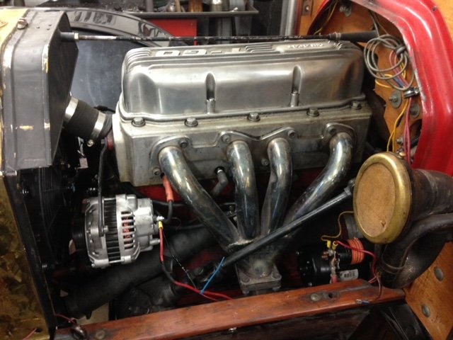

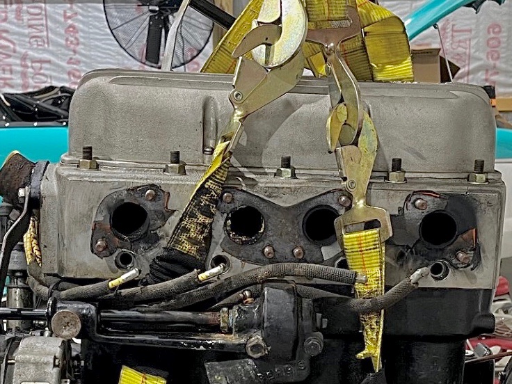

Can anyone tell me
Topic author - Posts: 3854
- First Name: Tom
- Last Name: Rootlieb
Can anyone tell me
about this head.
pete eastwood
- Posts: 205
- Joined: Sun Jan 13, 2019 6:17 pm
- First Name: Pete
- Last Name: Eastwood
- Location: Southern Califiornia
Re: Can anyone tell me
Jim Culbert in San Diego made those back in the '70's / '80's.
Aussie16
- Posts: 280
- Joined: Sat Jan 05, 2019 9:24 pm
- First Name: Warwick
- Last Name: Landy
- * REQUIRED* Type and Year of Model Ts owned: 1916 RHD Canadian Touring 1916 Pickup 1926 Fordor 1925 Dalgety Tourer 1916 Speedster
- Location: Trarlagon Victoria Australia
Heres an old forum link that tells you a little about the man himself and about the OHV head he built himself. A fairly low volume production but appeared on several cars in California. Not original era correct like a Rajo of Fronty but pretty cool anyaway.
https://www.mtfca.com/discus/messages/8 ... 1237165081
Craig Leach
- Posts: 2035
- First Name: craig
- Last Name: leach
- Location: Laveen Az
Hi Tom,
The T-GO head is a good runner, they do need a water pump as they don't seem to thermosyphon very well. D.P. had two of them & he said that
they are from a batch that had porosity issues and needed to be repaired many times. W.M. has one one his 13 and it seems to be indestructible. Craig.
