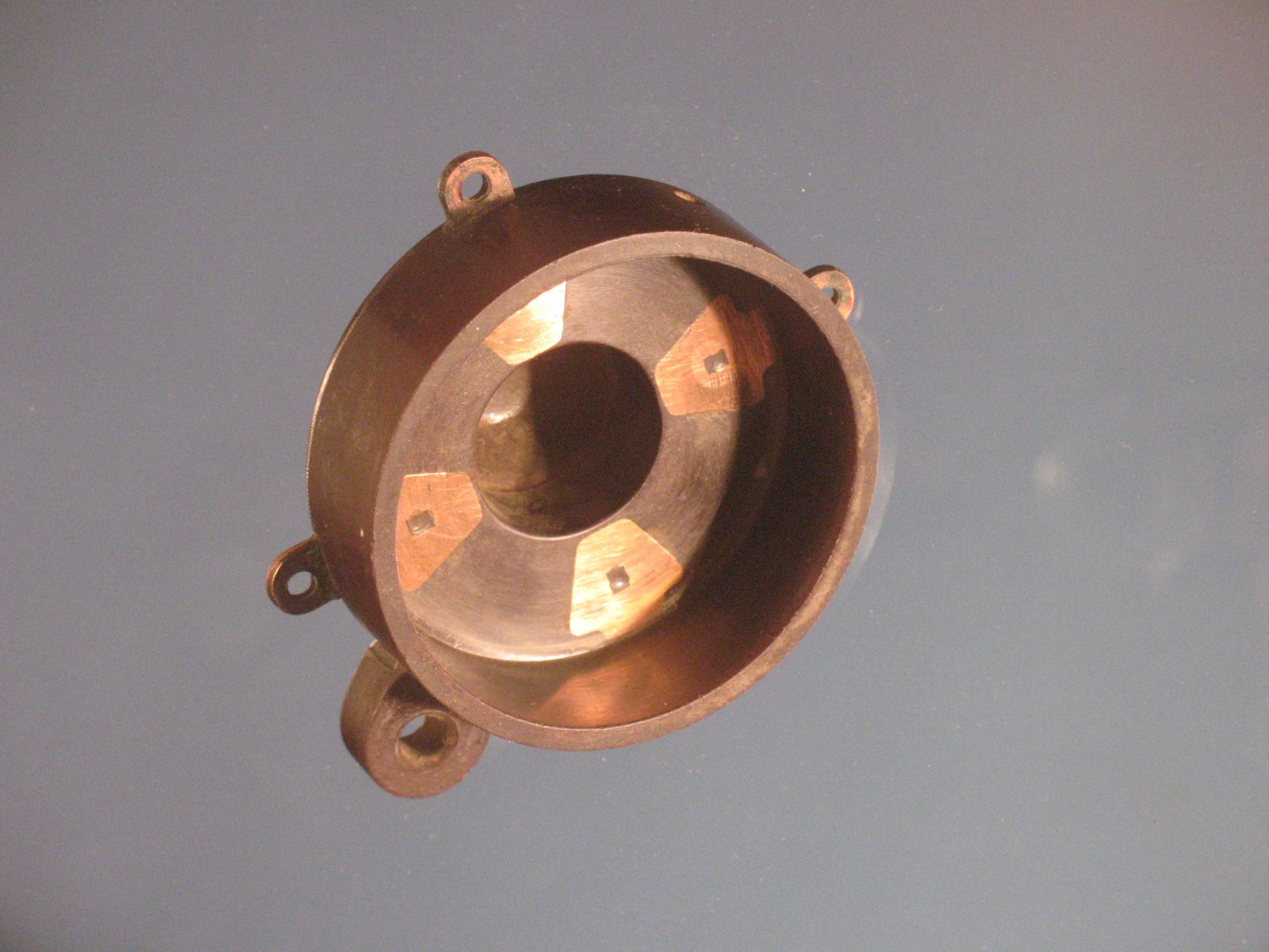

Post by old_charley » Fri Apr 12, 2024 7:53 pm
The original New Day timers were dark brown. The bodies were made of Bakelite. If you rub a spot fairly hard on one for about five seconds to get it warm you'll notice a sort of petroleum aroma to it.

Post by KeithG » Fri Apr 12, 2024 8:19 pm
As Bryan said above, the originals were made of dark brown bakelite. They also had the letters PTND just below the the hole where the timer rod connects to the timer.
Further, there are repos with an "S" instead of the PTND below the timer bracket rod mounting hole. These are poor quality and don't hold up. These haven't been made for many years but they do show up sometimes.

Post by DanTreace » Fri Apr 12, 2024 9:33 pm
Here’s an older post where photo differences of the New Days for comparison
The latest New Day by Tip Top is very spot on an original to casual observation. Even has the patented initials under the timer rod hole.
The black S version (Synders) no longer made is black plastic.
The dark brown older repro from the late 69’s -70’s has a large flat beaded nose for the timer spring.
The original period made dark brown can be quickly identified by the very elaborate nose with rounded snout for the timer spring.

Post by Steve Jelf » Fri Apr 12, 2024 11:44 pm
Look inside the cap. In the center of each contact is a little hole. In an original New Day the little hole is a rectangle. There may be a repop with rectangular holes, but if you see round holes or none at all you know it's not original.
