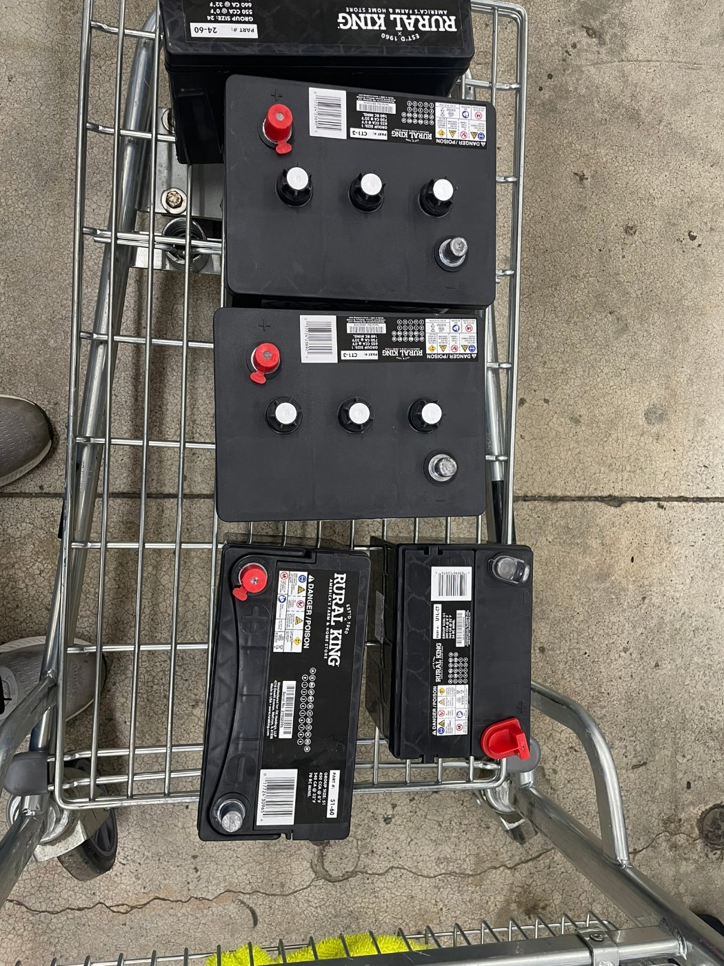

5th, From my experience as a former Optima dealer, when Optima moved their manufacturing operations to Mexico about 16 or 17 years ago, their QC went to being trash. I had so many warranty claims from customers that we quit carrying/installing them. Additionally, most Model-T generators or aftermarket T alternators cannot re-charge an AGM battery that is below about 11 volts without damaging the battery and/or the alternator, so they really are not a good match for how most people drive their early Ts. Therefore based on that and multiple 'less than satisfactory' experiences, any Optima in this hobby is not an option for me.

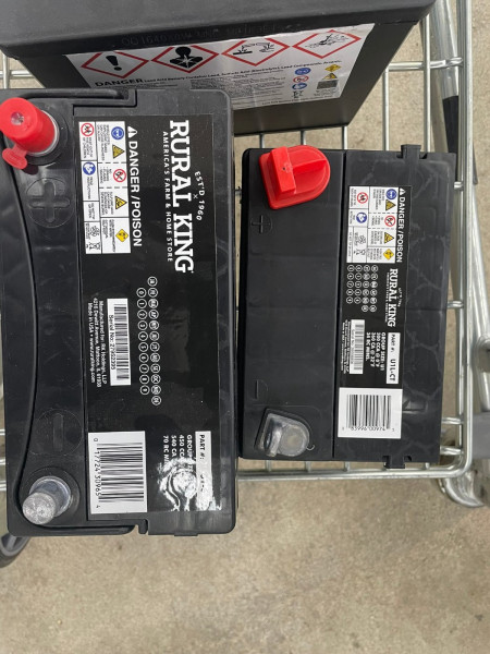

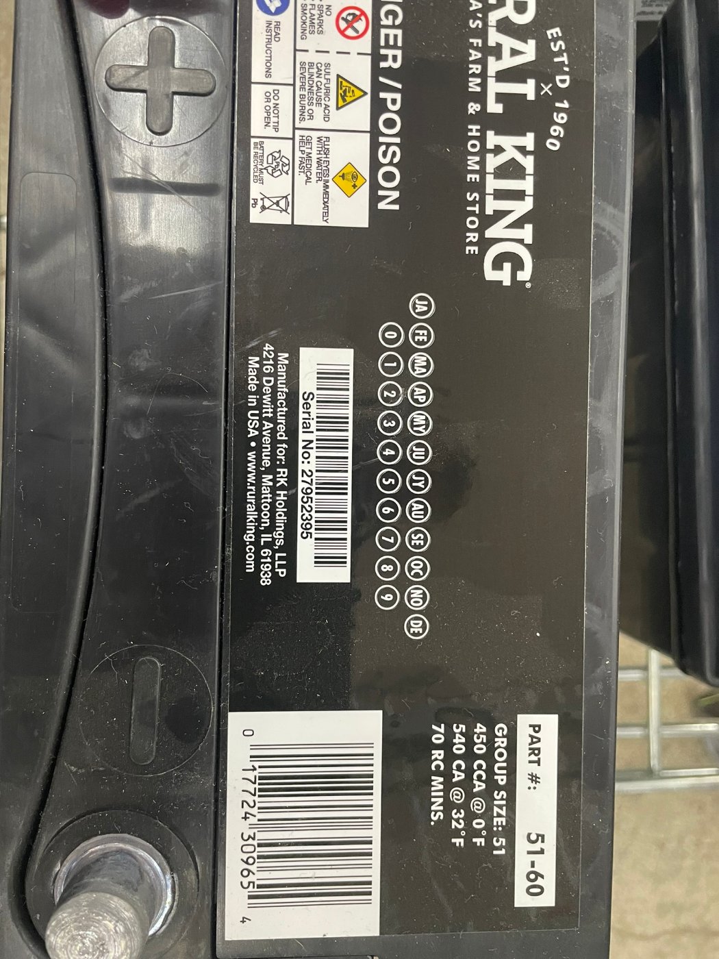

To update everyone on this, we wound-up purchasing a Group 51 series battery (-amongst 4 other batteries) because the Group 51 gave about 180 more CA than the smaller diesel garden tractor battery did. I think this Group 51 battery should fit the 'need' nicely but time will tell I suppose.
FWIW, this Group 51 battery was about ½ the size of a Group 24 battery, ...and you can see its physical size when compared to the Group 1 6v battery next to it.

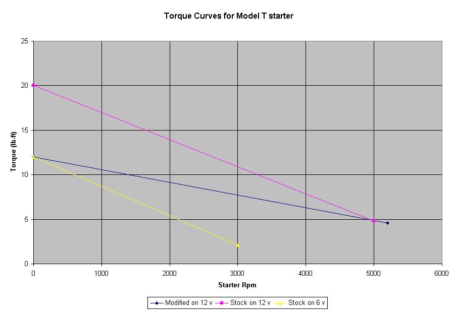

Thanks for the details on that 'little' 12v battery. That should work fine for the modified 12v T starter.

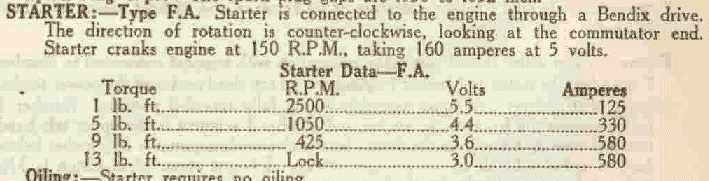

Here is torque specs on the 12v modified.
A typical well working T starter on 6v will put out good 8-10 ft/lbs of torque, plenty to crank over a cold engine.

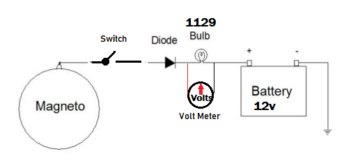

Why Magneto: If charging a 12 volt battery via John Regan's Magneto powered charger a different bulb could be used. The one initially specified is for 6volt battery
12v magneto charger.png (32.36 KiB) Viewed 2027 times
https://www.mtfca.com/discus/messages/29/23876.html
By John F. Regan on Sunday, January 21, 2007 - 11:32 am:
You can use the same bulb but you will get less charging using a 12V battery because there is less potential difference between the nominal 28VAC of the magneto and the 12V battery versus 28VAC and a 6V battery. If the battery is used only for hot shot starting and possibly powering a brake light then the bulb we supply in the kit probably will work fine. If you need MORE charge then you can use an 1129 bulb (which is a 6V bulb actually) in the circuit with your 12V battery. You cannot use an 1129 bulb to get more charging with 6V battery since it will burn out rather quickly. The bulb we supply in the kit is an industrial bulb that is about the lowest resistance bulb we could find that was 12V. Everage charge rate will also be reduced if you are running a 3:1 rear end due to lower average RPM of engine.
