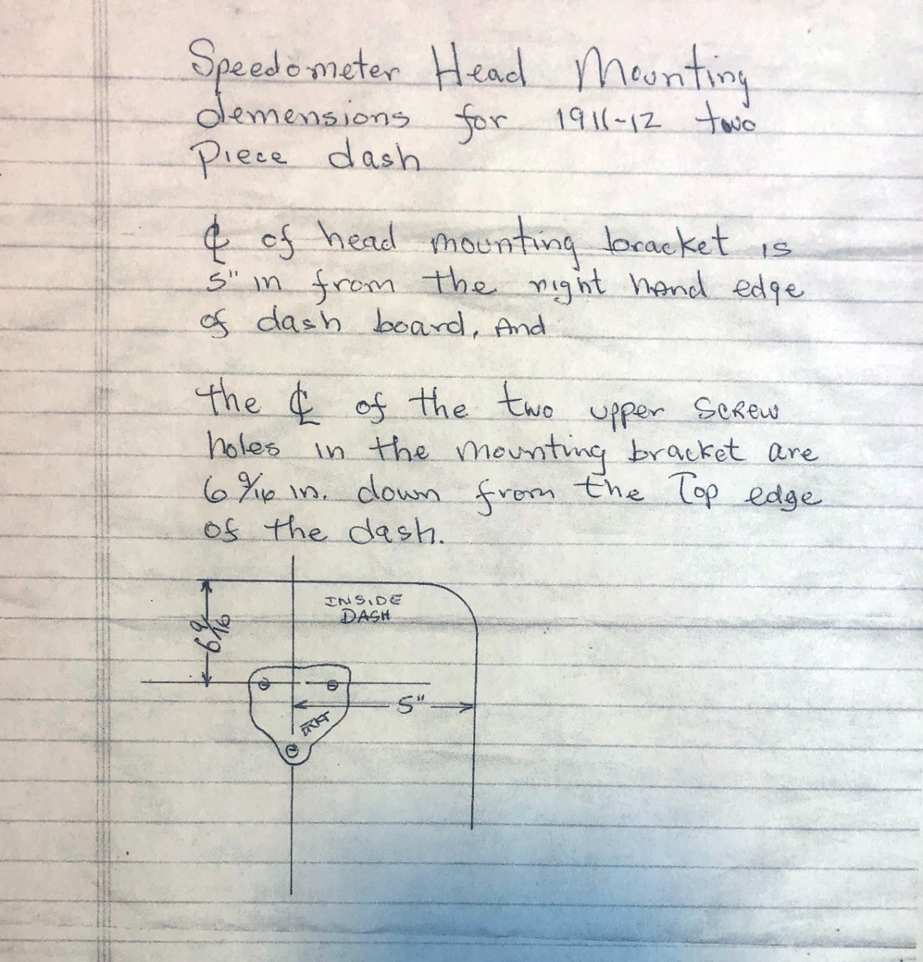

Russ has already given an answer to your question but I thought this also might be of interest to you. I have this note that the previous owner of my "Late 11/early 12" Commercial Roadster, Ken Jones, made based on an original firewall for the car. My guess is that it corresponds with what Russ says. (I haven't gotten to the point of mounting the speedometer yet to confirm these dimensions)
