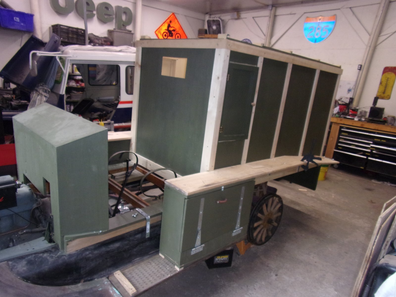

Thanks for the verification of putting two new rims on the front. For several reasons, I am starting with a 26/27 rolling chassis, so it will be a 1917 Ford Model T ambulance body on a 26/27 rolling chassis. It had wire wheels on it originally and I traded for the demountables. So, a ambulance salad, but budget did not allow for starting over correctly. The rolling chassis is what I had in the shop and I knew the engine ran. Here is where I am on the mock up so far. Obtained original Ford working drawings from the Henry Ford Museum.
