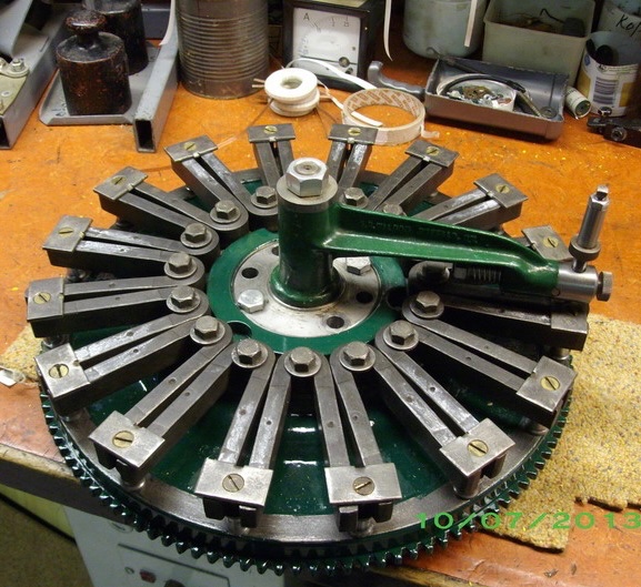

Post by Steve Jelf » Tue Apr 16, 2024 9:51 pm
The old practice of beating the magnets into submission with a hammer always makes me cringe. The idea of whacking the magnetism out of newly charged magnets persuades me that it's better to equalize them to within .003 with shims. With a prescribed gap of .025 to .040, I figure that's close enough.

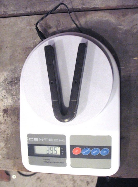

This may have been overkill, but I took a little off some of the magnets to get them all the same weight.

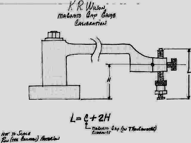

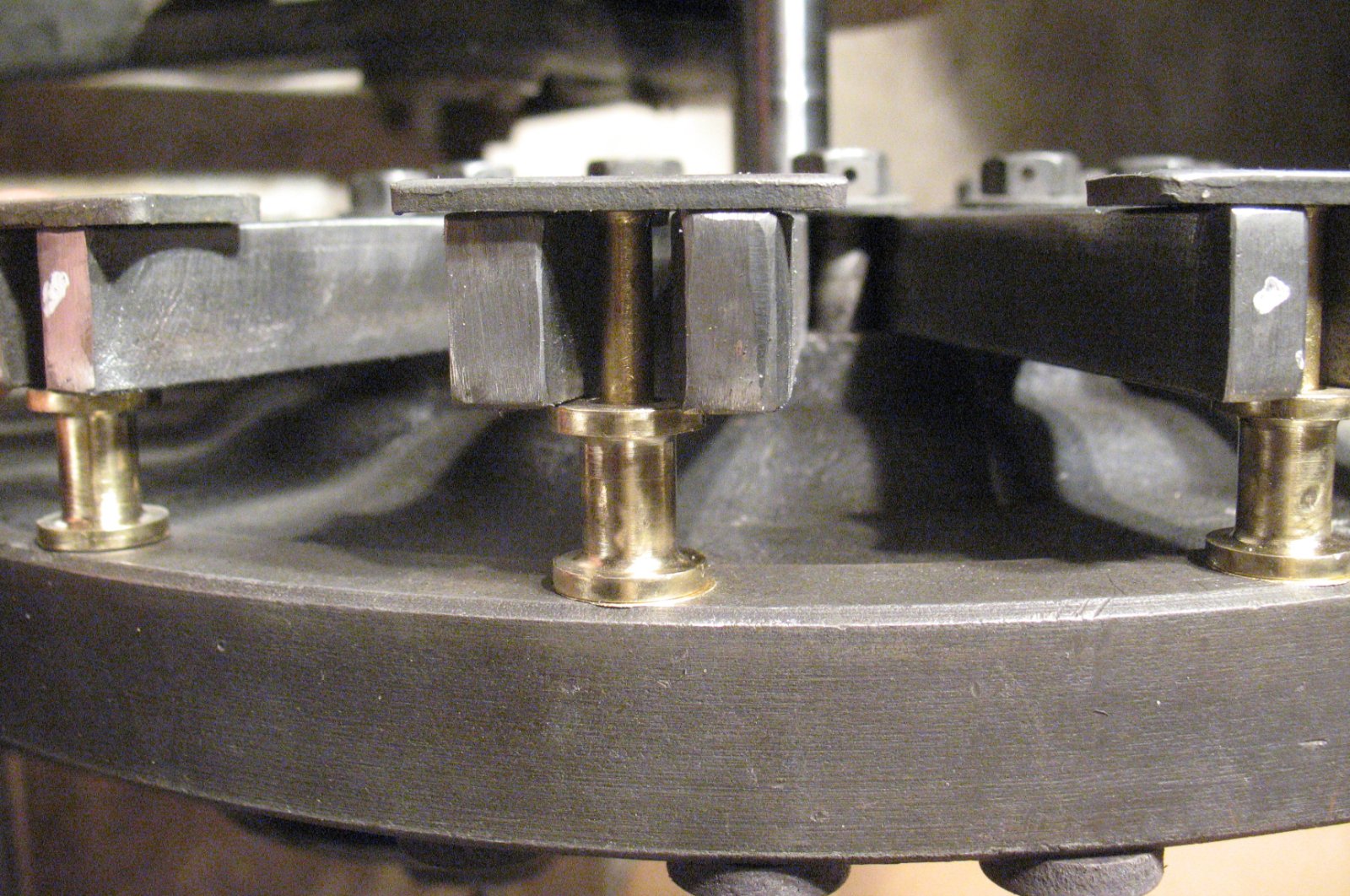

Post by JTT3 » Wed Apr 17, 2024 4:13 pm
Just asking did you have a transmission shaft flange inserted between the flywheel and gap gauge then bolted to the flange/ flywheel when measuring the height of the magnets?
Courtesy of the Coilman, pictures from Toon!
When I look at the magneto gaping procedure I take into account ALL the factors that can affect the outcome.
The magneto magnet keeper to field pole gap is a function of two things. The gap set with the gauge AND the rear main bearing thrust end play.
KRW expected the rebuilder to 1) measure the crankshaft rear main thrust journal width, 2)add .004, 3) measure the thickness of the cast cap (or block journal casting if a 360 degree thrust will be used), deduct 2 from 1 and divide by 2 machining the front and rear thrust surface to that thickness. I don't know what procedure others use. The idea is to ensure the crankshaft is properly centered in the block and to make sure one side if the thrust surface is not too narrow thereby possibly failing early not to mention the proper relationship of the crank.cam gears.
Having done that you can now use a PROPERLY CALIBRATED gap gauge to set the magnet height and field ring position, but you have to ensure the crankshaft is not moving back and forth in the thrust gap when doing so.
This task is hard enough without additional variables that can affect the outcome.
Two additional things.
The Ford Service Bulletin fails to mention that to use the gap gauge for setting the magnet height you MUST have transmission stub shaft inserted in the flywheel counterbore before you install the gap gauge or you will be unable to use it.
Once the height screw is used and locked with the thumbnut to clear all the magnets the same height you cannot change it when setting the field ring position.
